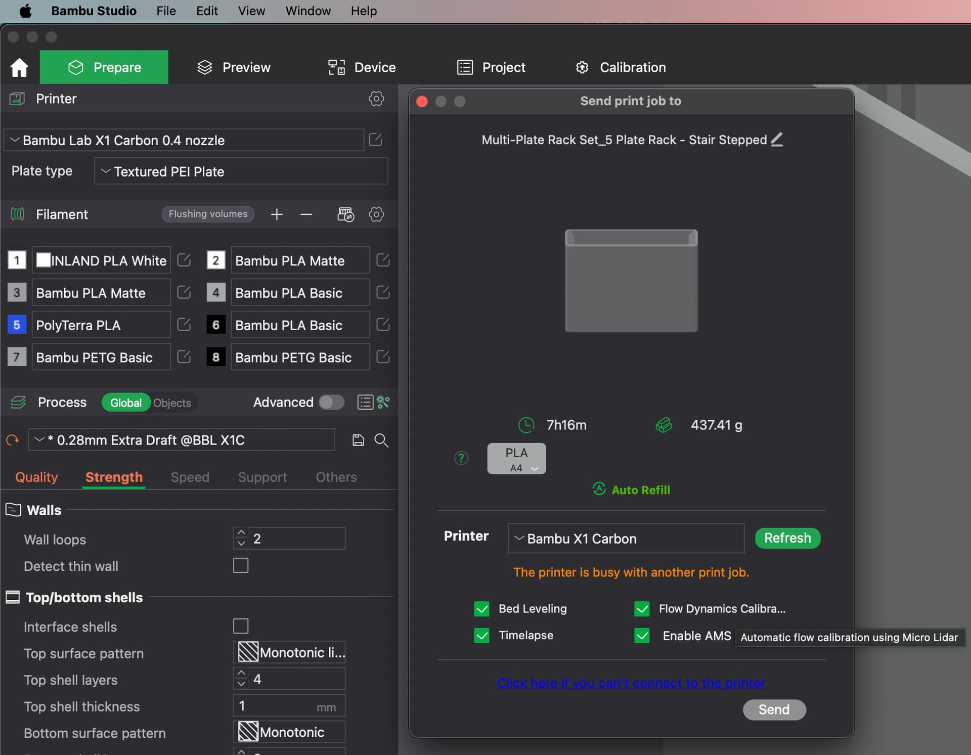

Hi there, something I noticed with Bambu Studio 1.9.1.67 (new stable release) is that the print dialog box when using the Textured PEI Plate, no longer automatically un-checks the Flow Dynamics Calibration checkbox, and no longer shows the warning tooltip when hovering over it.
Previously on all older versions of Bambu Studio, the check-box would be automatically unticked whenever you used the textured plate, and you’d get a warning: “Caution to use! Flow calibration on Textured PEI Plate may fail due to the scattered surface.”
So was this remedied? or is it an oversight and we still shouldn’t use it?
I’m printing something right now and testing using Flow Calibration when printing, and so far nothing bad has happened, but I’m curious to know what is actually happening with this update.

Yes, offical update will be good, during the BETA phase of Latestr studio I moved to primarlly aall pritning on Textured PEI, then I noticed i could even CALIBRATE filaments K value automatically etc (or still manually) - so I redo them all via the automted process, and numbers came out pretty close\good.
I even did some White and partial transulicent\clear - and read the bed \ lidar the auto-k just fine.
I think they may have fixed it for Textured - but again yes Offical update be great?

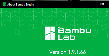

Here we go again. Did BL change the release again? It was just yesterday when it was version 1.9.1.66. Or is 1.9.1.67 a misprint? :crazy_face:
I havent got anything new, Public or Beta…
Public -

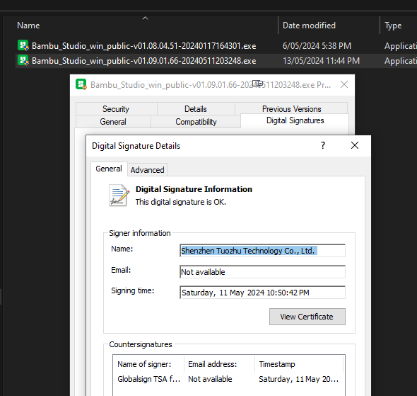

Digital cert on the installer for my original version, not downloaded recently from github since the dropped.

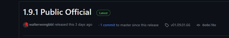

Github - 3 days ago same version
@AeonJoey Can you confirm your version pls. is it really xxxx.67?

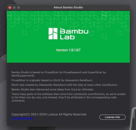

Oh *.67 is the Mac version:
Oh that’s fanfreaking-tastic!, thanks for this info, this is going to make things easier for folks who only have the textured.
sorry, .67 is the mac version, it’s the same release though
I will have to try this out then. I have been so used to turning it off.

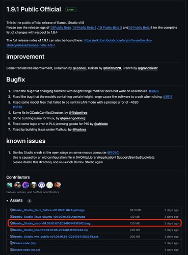

Perfect! Good to know, didt even notice that in Github list hahaa.
1.9.1.66 for MacOS had a minor :laughing: problem in that it would crash when opened.
1.9.1.67 was issued a day later to correct the issue.
Windows and Linux remain at 1.9.1.66.
From the Bambu Store regarding Textured PEI Sheets: The latest firmware brings significant improvements to the Bambu Textured PEI Plate calibration using the Micro Lidar, and it is now fully compatible with the automatic calibration process.
I’m elated! Thanks! :blush: this is such great news
