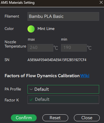

Flow Dynamics (PA) Value - Not able to custom set for Filaments

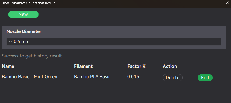

This has worked before and is working fine on my H2C but I can’t set custom/calibrated PA values for Bambu filament on my P1S or even for 3rd party filaments really.
Here shows my calibrated value:
But I have no selection options for it:
Not sure what the issue is.
I’ve had this problem for about 4 months (P1S, Linux, with all filaments). I opened a ticket months ago and was told that the problem would be fixed in the next update. However, that hasn’t happened yet. The software department at Bambu Lab is pretty sloppy.
I get this all the time on my P1S, no clue why. I click on the calibration tab, then go back and usually it defaults in my custom profile.
It’s been off and on doing this for the last few months.
@Bruegge @JABO_Designs Thanks, I will add another ticket to the pile too. Hopefully will get some traction on this issue.
