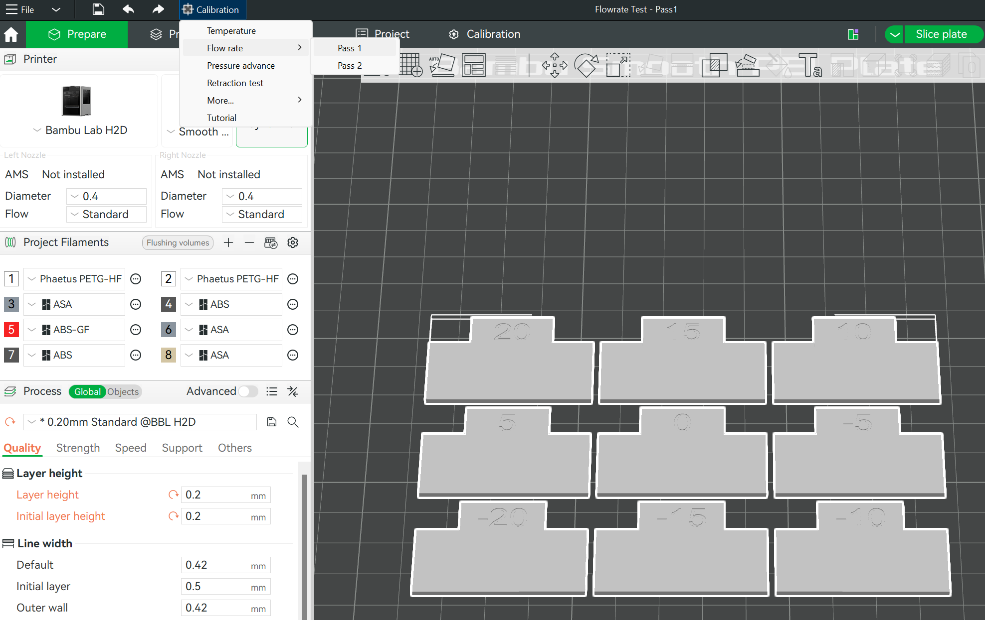

Does anyone like me have a 1.04 flow rate with PLA matt and PETG HF? Have a P2S and this value seems most beautiful to me. I did the first layer test and it was great. Even if I print a higher object, the top layer is perfect… Or is there anything wrong with the story?

Only that you can’t judge the flow rate by the first layer, especially if you test it on something like textured PEI that skewers results.
Go into preferences, enable dev mode for Bambu Studio and do a flow rate test properly.

Ok, yes I had the developer mode from the first second. Have been printing "for 6 years. Before that always with the CR6 SE. There was a completely different story with calibration. I also did the flow test and got the same result. I also changed the basic presets of the filaments so that the AMS does not always take the original flow rate.
