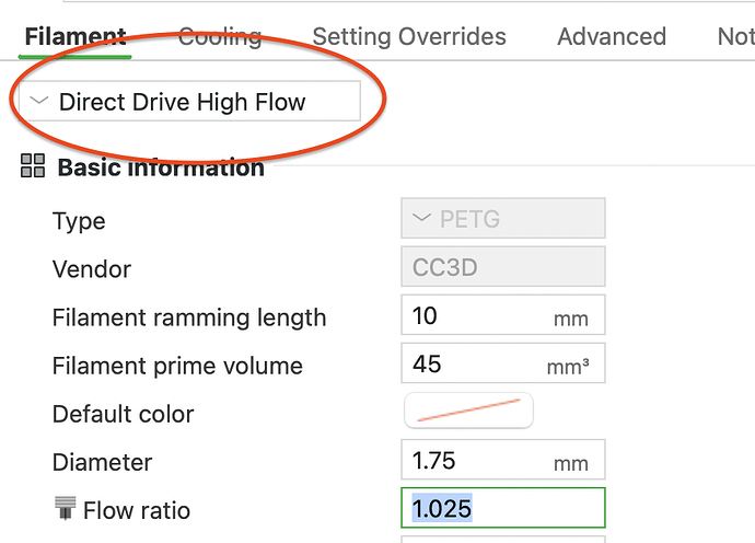

Hello, I have always determined the flow rate with a cube that has two walls without filling so far. That also worked quite well. Until now. Somehow it doesn’t work anymore, as I know it. No matter what I specify with the flow rate, the two walls remain exactly 1.0 mm wide. Can someone confirm that? VG

Hi JayZay and thank you for your reply. I own 3 X1C and have calibrated my filaments since the beginning. It is also important that the printed parts are also dimensionally stable. With the H2d it doesn’t work anymore. No matter what value I enter in the flow rate, the cube with two walls and without infill remains at 1 mm.

I do my flow rate calibrations in a similar mannar, although I just use a single wall. I ran into this same issue where I thought a change to the flow rate did not change anything until I realized I was changing the flow rate value for the standard nozzle settings instead of the high flow rate nozzle (which I was using). After setting the flow rate for the correct nozzle, the wall thickness changed correctly.
Hi Joes, a huge thank you to you! That was the crucial tip.
