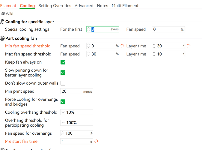

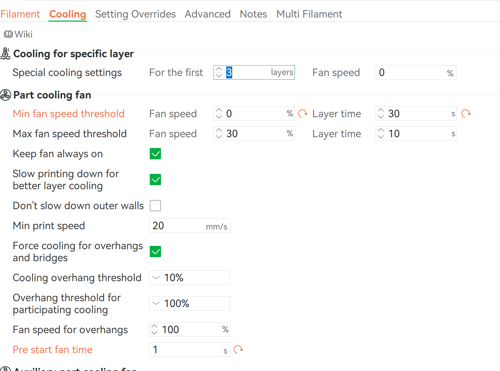

I print mainly PETG.
I also set the chamber temperature always between 40 and 45 °C and keep the part fan off unless absolutely necessary (bridges / overhangs / short layer times). From my experience PETG likes it warm for good layer adhesion.
Yeah… please bambu turn off the default chamber cooling for PETG under 40C chamber temp… @SupportAssistant
I will give that a try, thank you! what would you suggest for settings?
These are my “standard” PETG settings:
Filament section
Cooling section
