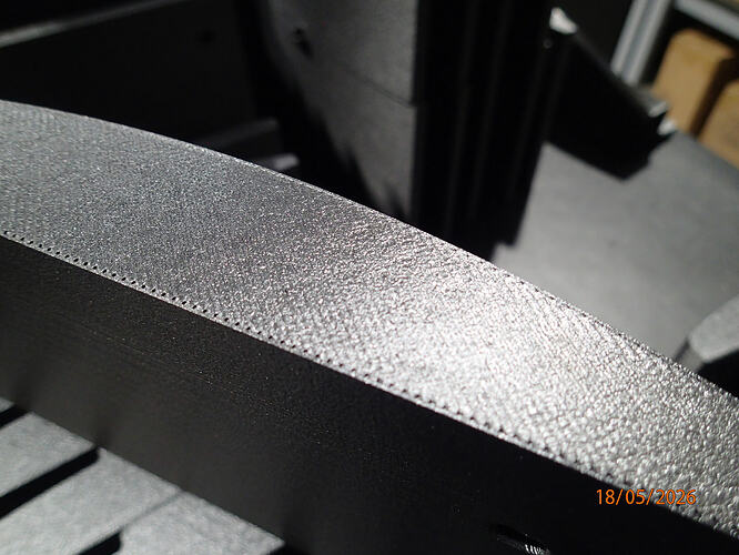

I’m printing YXPolyer PC-CF on H2S and H2D printers, and I’ve noticed that when the last roll of filament runs out and I add another to the corresponding slot in the AMS, my printer seems to lose or reset the Flow Ratio (see attached photos).
At first I thought it was just shrinkage but then I noticed the awfully rough top surface as well. Is this a bug that needs to be reported? Has anyone else had this issue? It has happened to both H2S and and now the H2D printer, as well.
My current flow ratio is set to 0.90, but it looks more like 1.00 after the filament change. This filament generally has a low shrinkage factor. Also this brand of PC-CF seems to be consistent in quality, as of 150+ prints.

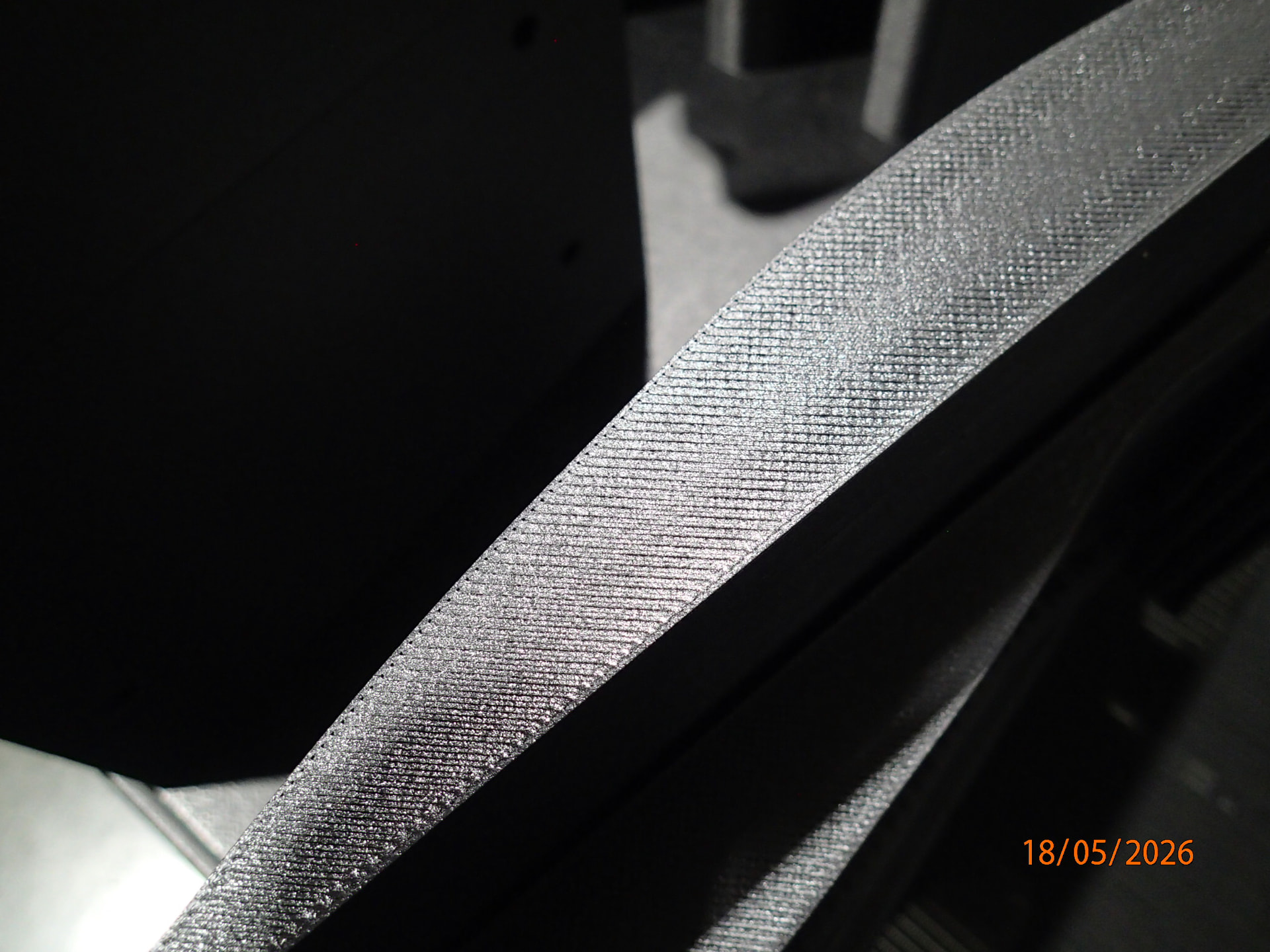

Here is a pic of the finished print top surface. If this isn’t over-extrusion, then what else would it be? I don’t feel like it’s just moisture doing that, but I could be wrong
Also I’ve tested that specific spool of filament against one of the others (they all have the same batch number), and there was virtually no line when it switched spools on a test block print.
I have included a pic of a completed piece, so you can see what the surface usually looks like.
this looks like under extrusion. but maybe also the photo fooling me.
this looks ok

Yah, it is quite hard to see in the photo, but ridges are pushed up between extrusion paths.
Then that’s sudden change of Pressure Advance. Most likely reason is filament being wet.
