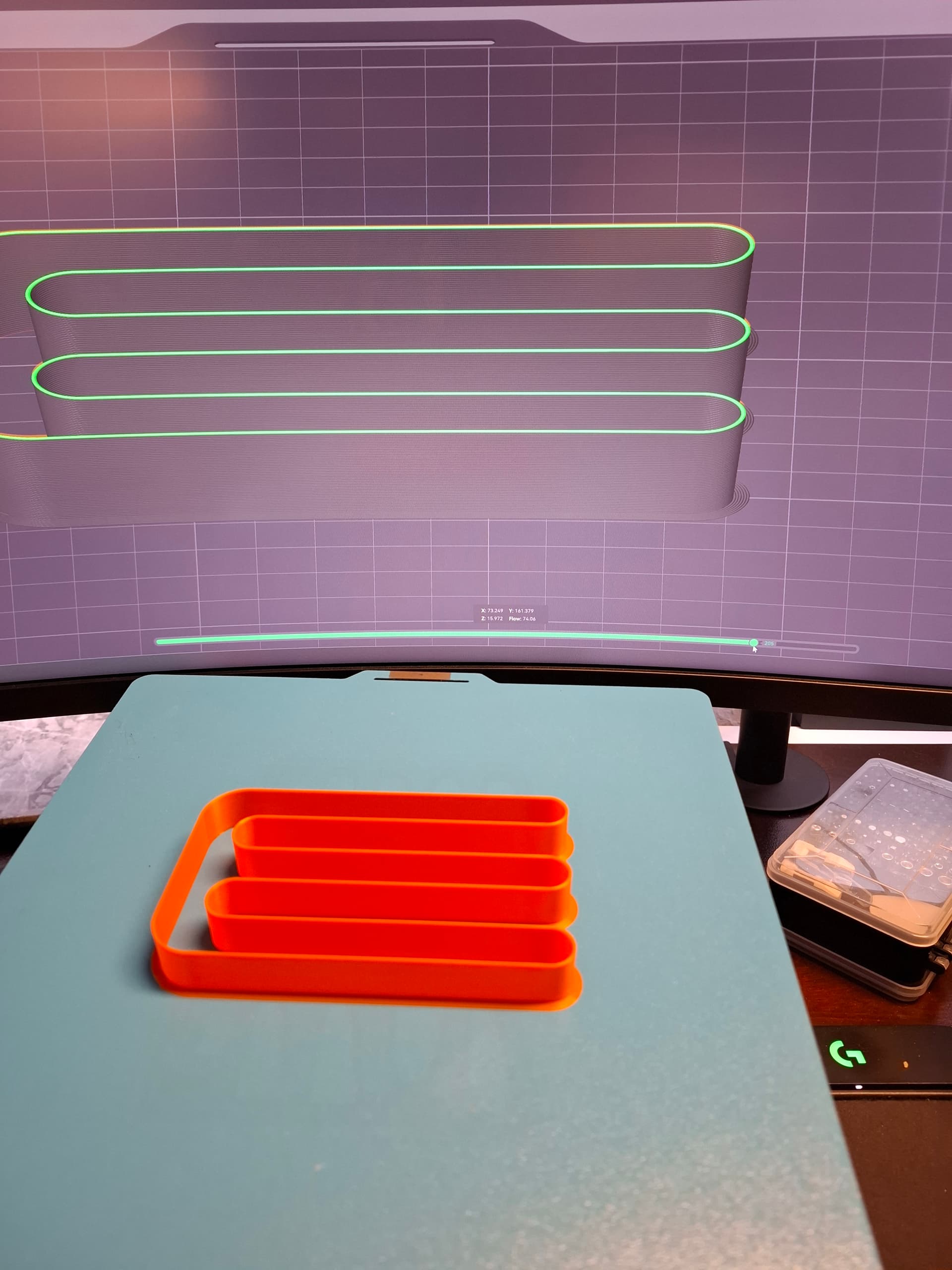

Before i purchased the printer, i was looking for some flow data specs about the P2S.
Here are some of mine in case anyone was wondering. Maybe it helps and some might add theirs.
Could also help you with solving extruder related issues as a comparison to your specs.
Gonna order the high flow nozzle too to get a acomparison as this isn’t actually mentioned anywere. The ~40mm³/s listed in the shop with the high flow can already be achieved by the standard nozzle.
I’ll try to update whenever something changes or i test a new filament.
All data in mm³/s, max flow test until the print fails, tested with actual print application.
As mentiond below, this is for the standard 0.4mm nozzle that comes with the machine.
eSun Pla Basic: 41 @ 230°C
Sunlu PLA HS: 38 @ 230°C
Sunlu PETG Basic: 39 @ 262°C
Eryone PLA Basic: 37 @ 235°C
Eryone PLA Matte: 48 @ 230°C
Anycubic PLA Basic: 34 @ 235°C

So, today i got to test my 0.4mm high flow nozzle on the P2S
With Eryone PLA Basic @240°C, flow dynamics calibrated, using the Max Flowrate calibration, im getting up to 72mm^3/sec with a flawless result.
Gonna test on a real print application now. But so far, im very very happy with that result. For big prints with large outer diamiters that really cuts printtime in half.
Gonna test the 0.8 hf soon.
