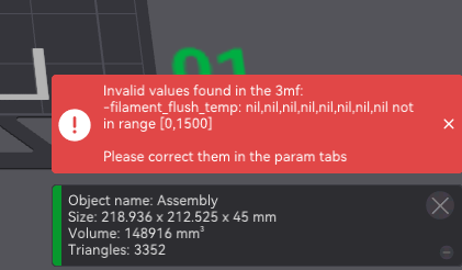

I’m getting filament flush temp not in range. The value of 250 is clearly within the range [0,1500].
Same here, i think is a bug.
Same error since going to latest build.
Same error here as well. -filament_flush_temp: nil,0 not in range [0,1500]
Same exact error here as well… Found any solution yet?
Setting the Flush temperature (under Multi Filament tab) to 0 seems to fix the error. I checked all of the Bambu filament presets and they are all 0.

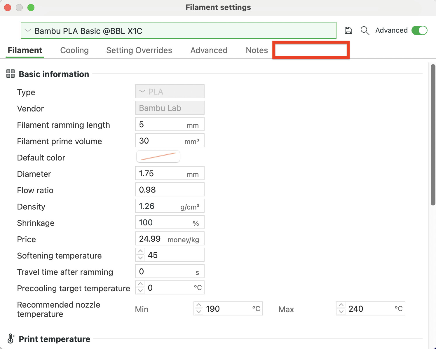

You have to do this for ALL of your custom filament presets

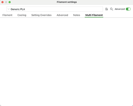

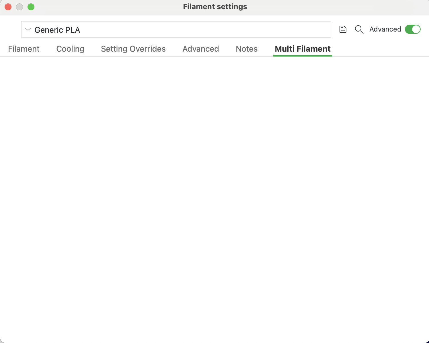

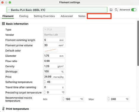

It took me a while to find the Multi-Filament Tab because it does not show up for all filaments. For Example, Bambu Lab PLA filament does not have this tab but Bambu Lab PLA Galaxy or Generic PLA does have it.
Although, it is completely blank for me.
Mac OS 15.5 – Bambu Studio 2.1.1.52
Same here — completely blank after getting that pesky error message.

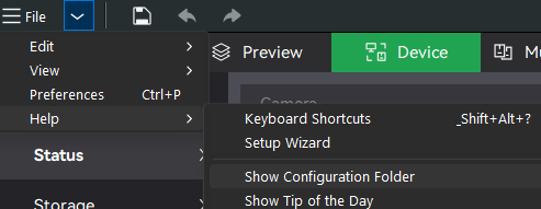

Here you can open folder that contain all yours filament presets :
You can edit these json files with a text editor and correct everything you need and that you cant do from BambuStudio, what I usually do is comparing with a working filament
