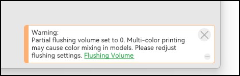

It has been a while since I have kept up with postings but I am getting this pop-up message in Bambu Studio.
I understand technically what this is but I do not understand how it came into being. I do some multi-colored prints, not many, and have just relied on whatever default BL had baked into Studio.
It is not something I would have changed because whatever the default was, was working fine. Is there a way to return this flushing volume setting back to the default?
I already did a reset and calibration which did not fix the problem.
It may be purely coincidental but a while back BL kept throwing a message about an update to a printer, I think an H series printer which I do not have. I finally admitted defeat to stop getting that alert every time I launched Studio and let it install the update. Annoying updates for printers I do not own is another source of aggravation but I am inclined to think that update is what caused my flushing volume fault. It started after I let the H Series update install.
Maybe these get preserved and you have a zero in your defaults? I know you don’t have a H2D, but…
If you create a new H2D project, make sure it has 2+ different filaments, open flushing volumes, set multiplier to 1, click recalculate, then switch to right extruder and do both steps the same, save the project, exit, does that fix the problem?
