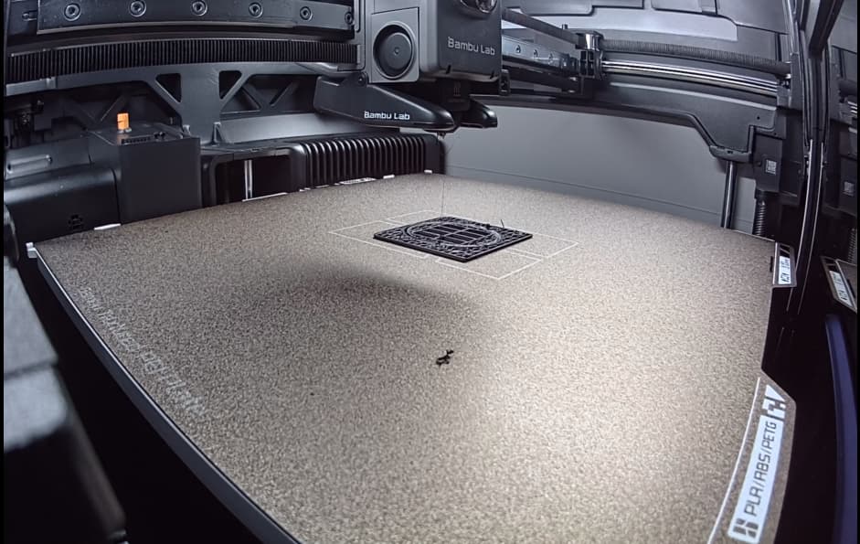

I have been facing challenges right from the onset in terms of fragments and stringing and am yet to be able to print anything successfully. Below is a recap of the current situation:
  • Using official Bambu PETG filament, dried and working perfectly on the P1S.
  • Carried out flow dynamics and flow rate calibration.
  • Using default print settings.
  • Printing a simple part results in fragments or stringing - I’ve attached couple of photos for reference.
Any guidance or help would be really appreciated as I’ve run out of ideas or options.
Thanks in advance!
Nadmax.

So, I tried printing a benchy and it came out near perfect with the default temps (70C bed / 245C nozzle). See photos below.
I’m trying to break this down logically, could the issue be related to printing speed? The benchy is a compact model, so the print head doesn’t have to go across long distances. Maybe bigger print jobs are causing filament to be flung across the plate due to rapid deceleration across longer print distances?
Just tried printing the original model highlighted in the beginning of this thread, same issue, had to cancel the print - I’m stumped :neutral_face: If anyone has suggestions, am open to ideas.

Hi Everyone,
I uploaded sample images of the failed prints to ChatGPT for analysis, and it came back with the following tweaks under the PETG filament profile:
  • Cooling
  • Part cooling fan - minimum fan speed threshold - layer time: 15s instead of 30s
  • Part cooling fan - max fan speed threshold: 40% instead of 60%
  • Part cooling fan - max fan speed threshold - layer time: 6s instead of 12s
  • Filament
  • Volumetric speed limitation - max volumetric speed: 10mm/s instead of 18mms
After making the above changes I am now getting perfect prints, sharing pictures below of a model that I had so far failed to print successfully but is now immaculate.
According to ChatGPT the default cooling settings are too aggressive rendering the filament unstable during printing.
