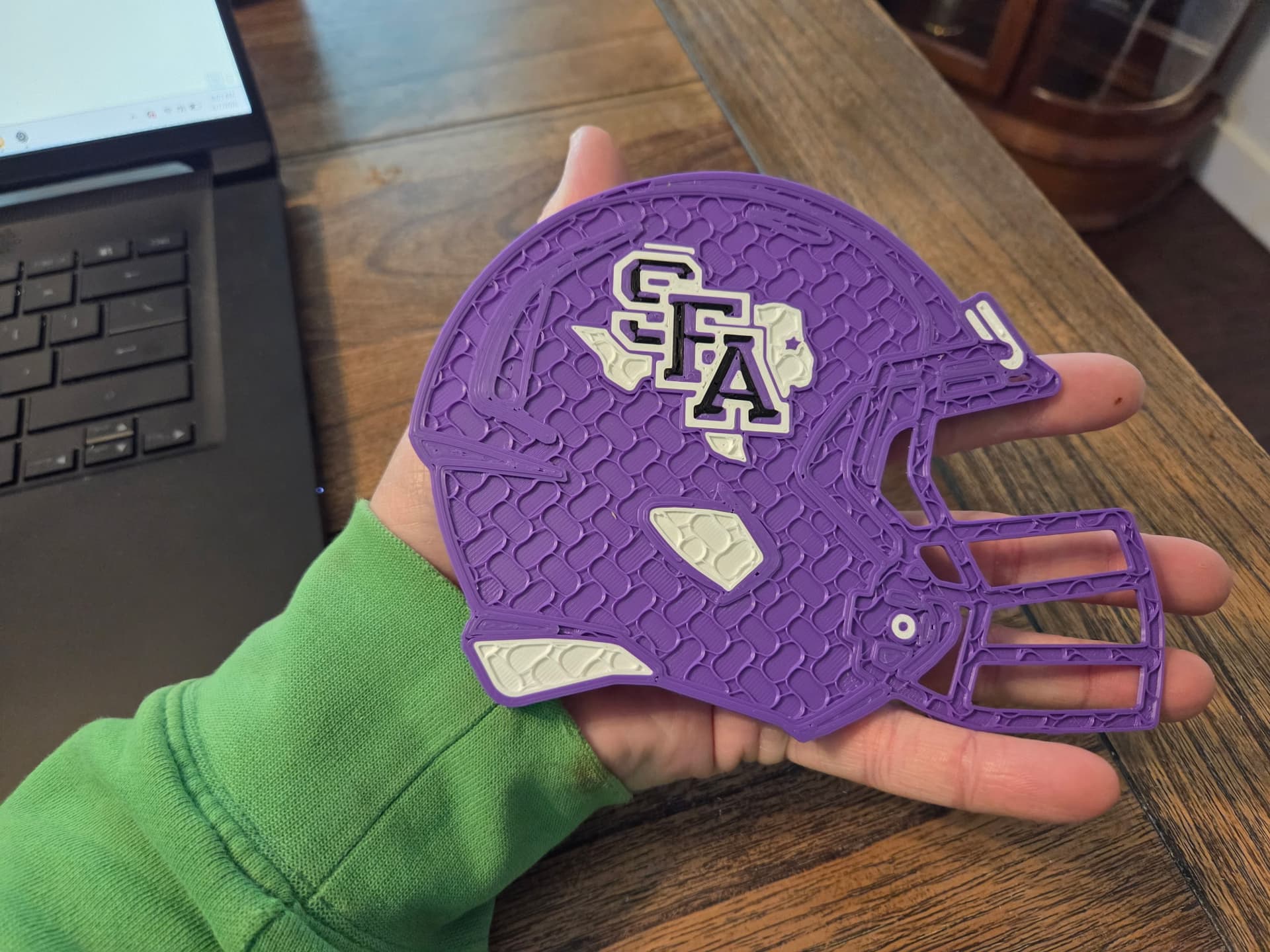

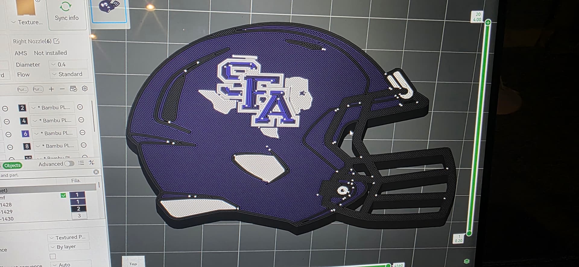

So this is the issue we are running into. I currently have a P2S and only printing one color. This is a print I am trying to do to go on a wreath for a friend whose son is playing at SFA this year as a freshman. A gift for her. My brother has the H2C and agreed to print it for me. I create a 2d image in photoshop and had it converted to an STL file by Chat GPT. when he put it in and sliced it, it looks perfect exactly how we want it to print. When he went to print it did not place the colors in the correct spot and the mask is all purple with no black. This is the first time he has run across this and is puzzled, we tried a few things to no avail. We are puzzled and would like to get this finished to surprise her before he leaves for college at the end of may. Any ideas what could be causing this. Why would it look perfect in slicer and print different. He has done many prints and knows how to assign color but this just isn’t working. This is for my learning as well. Fingers crossed and thanks in advance!
Hi, it would be best if you can post the project file. Otherwise we’re just guessing. Extra confusing is the black first layer photo, but then you say there’s no black (nor is there any in the last photo, it seems). Or why are there over a dozen filaments in this project? There could also be multiple issues here.

There’s like…7 purple filaments and 5 black filaments in there. There should be one purple, one black, and one white.
Your brother most certainly does NOT know how to do multicolor.
I think he said GPT did it, which kinda tracks, AI does not do this well.

Well, this is set up for an A1 Mini which is odd. There are only 2 layers, which doesn’t seem to track with the photo showing infill. Or where that solid black layer came from.
Despite all that, the only definite issue I see is the multiple filaments of the same color. The slicer and printer will think these are physically separate filaments, despite the colors being the same. Only use one instance of each filament color (as CF said).
The correct printer needs to be selected of course. Beyond that, the selected filaments will need to be properly mapped to AMS slots and H2C nozzles when sending the print.
I wonder if this will be sturdy enough to remove from the plate, with just 2 layers and the chunky first layer lines (bunch of voids around the lettering and such)… and the ironing is questionable. But those are separate (possible) issues.
