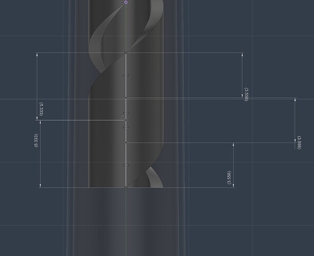

I have a sketch, made a Project of the existing body, and it gave me two points, between which I created a new point, exactly in the middle - no problem, easy task - Midpoint.
But now, instead of one point in the middle, I need to create two points so that the distance between the projected points is divided exactly into thirds.
The problem is that I don’t know the distance - it changes parametrically, so I can’t calculate inn advance, somewhere on the side, that 1/3 = xy mm… The only thing I can “grab onto” is precisely and only that projection… I know the boundary points, but I just now I have no idea how to add the two new ones so that it works out in thirds…
I apologize if the description is a little confusing, but the picture will hopefully explain it better -green is what I have now (1 point = midpoint), red is what I need (2 points).

I placed the two “searched” points “by eye” on the line connecting the two projected points. Then I drew three lines between points 1(P)- 2; 2-3; 3-4(P) and set the Equal constraint so that the length of the three lines should be the same. Honestly, I thought Fusion would send me to *** (Unable to solve or something similar), but to my pleasant surprise, it solved it without any fuss :slight_smile:
So I have three lines of equal length and, most importantly, I have the two points I was looking for. See the image - ignore the “dimensions”; they are set to “Driven” and are only there to check they are really the same during test - I tried changing the projection points to see if it really works in general, and it seems that it does.

Method 1: Using Construction Lines and Equal Constraints (Best Method)
  1. Open your Sketch and ensure you have your main line drawn between two endpoints.
  2. Create Construction Lines:
    • Using the Line tool (L), draw two lines starting from the top endpoint, roughly dividing the length, and ending them on the main line.
    • Draw another line to finish the 3rd segment. You will have 3 line segments along the original path.
  3. Toggle Construction: Select all three line segments, right-click, and choose Normal/Construction (or press X on your keyboard) so they are dashed lines and do not interfere with extrusion.
  4. Apply Equal Constraints:
    • Go to the Sketch Palette and select the Equal constraint (looks like an equal sign).
    • Click the first segment, then the second.
    • Click the second segment, then the third.
    • All three segments will now change to equal lengths.
  5. Place Points (Optional): If you specifically need points, use the Point tool to place points at the intersections of your construction lines.
Method 2: Rectangular Pattern (Fastest Method)
  1. Draw a Point: Place a point on one end of your line.
  2. Activate Pattern: Go to Sketch > Rectangular Pattern.
  3. Select Geometry: Select the point you just created.
  4. Configure Pattern:
    • Distance Type: Change from ‘Spacing’ to ‘Extent’.
    • Quantity: Set to 4 (This creates the two end points plus two internal points).
    • Direction: Drag the arrow to the other end of the line.
  5. Finalize: Press OK. The points are now equally distributed.
Method 3: Parameterized Dimension (Most Flexible)
  1. Measure Total: Dimension your main line, and take note of the parameter name (e.g., d1).
  2. Place Points: Place two points on the line.
  3. Define Locations:
    • Dimension the distance from the start point to the first new point.
    • In the dimension box, type: d1 / 3.
    • Dimension the distance from the first new point to the second new point.
    • Type: d1 / 3 again.
  4. Now, if you change the main line length, the two internal points will update to maintain equal thirds.
