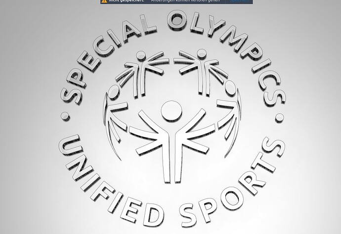

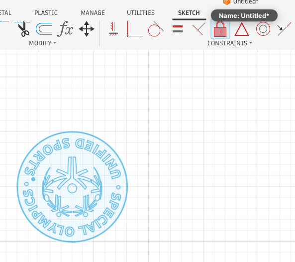

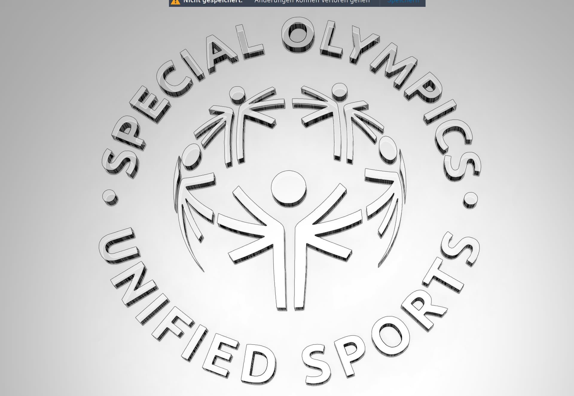

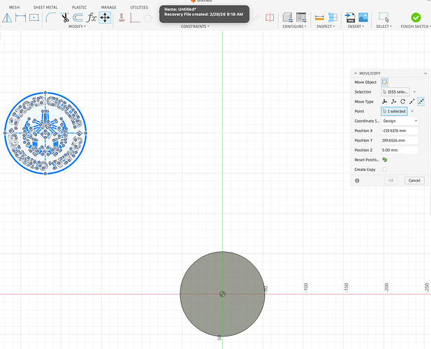

I have a new question for you guys… I am trying to make a coaster for a school event. I put an svg sketch on the surface of the coaster. I wish it would automatically register in the slicer, but it wont. I tried to extrude the complex logo, but it wont work. Images are attached. As you can see, the logo is locked. I could do this in tinker cad almost instantly… but how would I do this in Fusion to get it flush?
An imported SVG is usually locked. You can select all the vectors and then click the ‘fix’ constraint to unlock them so they can be moved. One thing to always check is that the sketch is orthogonal to one of the XYZ planes. If you use the surface of an object this may not be the case…

Are you sure it’s a flush problem? Normally, fusion 360 inserts the svg perfectly aligned. Either you clicked wrong or, what is also possible, you didn’t select everything. To me, it looks more like not everything was selected or the svg had gaps.
The short video actually sums it all up: You just have to make sure that everything is selected and that your SVG is really clean.
Did you create the SVG yourself or use an online converter?
It may be that you have to redraw it yourself because the converter did it incorrectly. I’m almost certain that your svg is simply messy. Probably didn’t select the areas properly because it wasn’t possible, as the template was so messy.
Take a look at all the errors, that’s not a “flush” error, that’s a “messy” error.

It seems from the other posts that the real problem is the quality of your SVG file, not positioning it as you originally thought. Work on that.

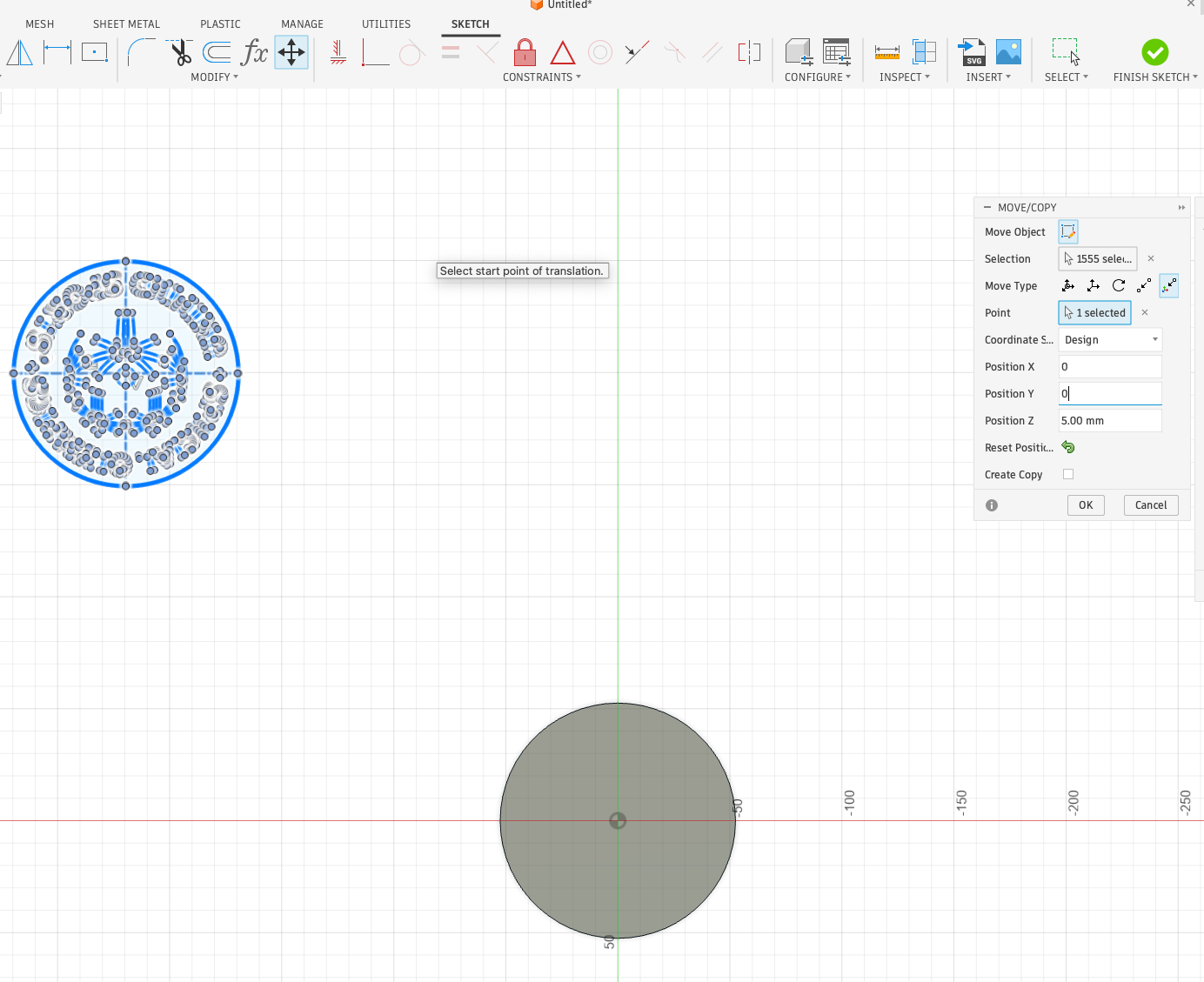

You can see the vectors are Green which means they’re fixed.
Select all the vectors and click on the Fix constraint (Lock symbol )

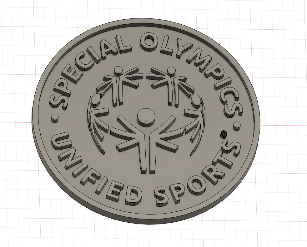

Then I added a point in the exact center of the vectors so I could move it to the center of my disk body.
I set the target position to 0,0 (Z=5mm is the top of the disk)
I then extruded the letters, but, rather than extruding the letters, it’s MUCH easier to cut away the background into the previously created disk.

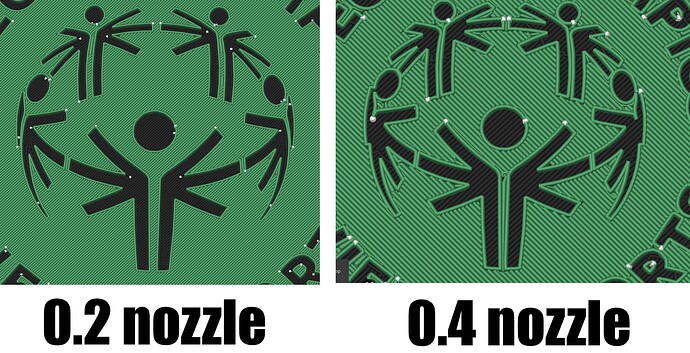

However, I can tell you right away that you will need a 0.2 nozzle to print this reasonably well.
When you import it into your sketch the dialog has a scale factor input box. It is normally set to 1.0
You can also select the vectors after the fact and use Modify→Sketch Scale
Make sure all the vectors are selected or you will get very weird results.
