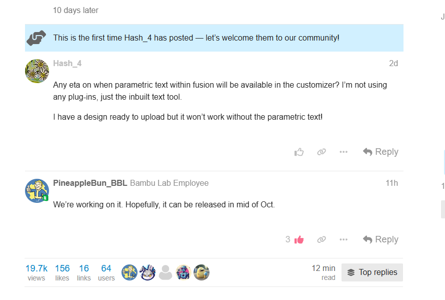

Are they still working on this feature? I was trying yo do this yesterday and it’s still nor working, I’m new to this so I also might be doing something wrong.
Welcome to the forum!
Their last post about it was 6 days ago. They said the Fusion API doesn’t support it yet and that’s what they are waiting for.
Still waiting. They been working on it for 7 + months??
