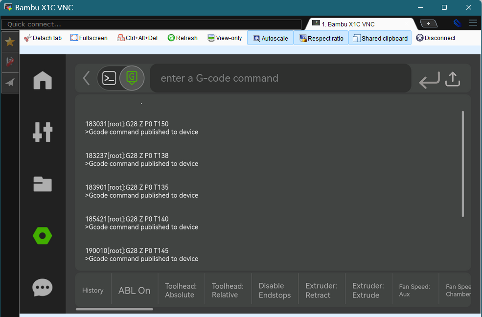

On my X1C, the X1Plus Onscreen Console and VNC server makes it easy to issue single G-code commands from my desktop.
I find that if the nozzle is over 140 °C, G28 Z lowers the nozzle temperature setting to 140 °C, homes Z once the nozzle cools to 140°C, then returns the nozzle temp to the previous setting.
G28 Z P0 Tttt, for ttt >140, homing occurs when the nozzle temp cools to ttt°C, then returns to the previously set nozzle temp.
Since the nozzle contacts the plate during homing, the 140°C temp might be used as a safeguard to prevent damaging some plate surfaces. I used an already-damaged plate for testing.
A plain G28 homes XY immediately, and then temporarily lowers nozzle temp to 140 °C and waits to home Z, as above.

I’ve found it difficult to create a working g-code file from scratch that the printer will recognize. I think if you slice a model and export the G-code you will find multiple G28 commands are executed. These lines are in the g-code for a primitive cube to be printed on a P1S:
Line   578: G28 Z P0
Line   622: G28 X
Line   685: G28 Z P0 T300; home z with low precision,permit 300deg temperature
Line   782: G28
Line   809: G28 X ; re-home XY
Dropping the temperature during the Z axis homing is necessary to prevent oozing from the nozzle from interfering with the homing process. While it’s baked into their G28 homing command, it’s not something you’d want removed unless you want an improper zero position.
My filament doesn’t ooze until the 200s, waiting for the temp to drop to 140C is infuriating, how do I turn this off?
For anyone else that came here from Google wanting to know how to prevent G28 from dropping down to 140°, simply add T200 after it (G28 T200). That will allow it to hold at 200°. I personally made it T201 so I knew it was my edit that was working.
