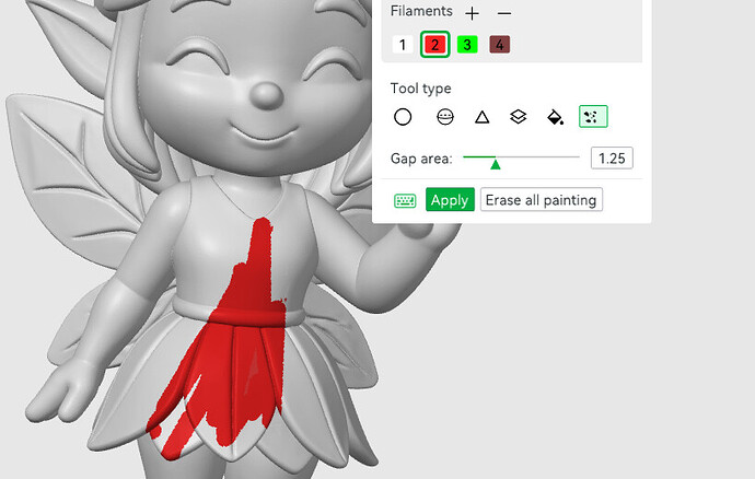

Hi Bambu Lab Team,
I’m experiencing an issue with the “Gap Fill” tool in the Color Painter mode of Bambu Studio. Here’s what happens:
  • I select a painted area and adjust the Gap Size parameter.
  • Visually, the holes in the painted area are filled in the preview.
  • However, the “Execute” button remains grayed out and cannot be clicked.
  • When I exit Color Painter mode, the hole-filling effect disappears.
  • Using another tool (e.g., switching to another painting action) also removes the effect.
I’m running the latest version of Bambu Studio. I’ve tried:
  • Slightly changing the gap size
  • Painting a small additional stroke
…but the Execute button still does not activate.
It seems that the gap fill works only as a temporary preview and cannot be applied permanently. This behavior appears to be a bug, as the visual effect is lost when leaving the painting mode.
Could you please look into this? I can provide screenshots or example files if needed.
Thank you!
When using the fil tab with edge detection ,then switching to gap fill , apply is enabled , i had to delete and redo the paint first .
i checked the other tabs again repainting as i went (apply = execute ? )
Mmmmh ok, but I don’t understand why redo the paint :o ?
? , i have no idea why it works that way ,

The paint has priority in this case, do the holes after painting… Just like TEXT… you can paint over it until hierarchy is changed, call for new text and write over.
