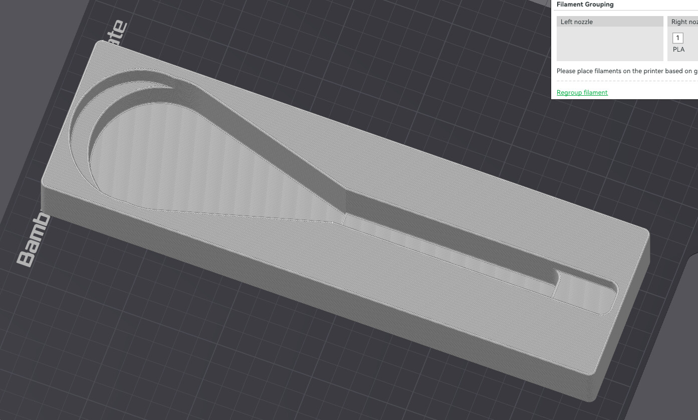

General advice for shaving time (LOTS!) from print?
Hello! I’m not including the model intentionally. I’m hoping to get your tips and tricks to eliminate large chunks of time to print. Off the top of my mind, internal voids? Is that a thing? Converting solid areas to lattice?
This is a kitchen drawer organizer. I do not need strength. This is a 4 hour print and I have to believe I should be able to get it down to two. It’s 83mmw x 295mml x 42mmh and it’s a .06 nozzle H2D
By default infill is 15%, you can drop it lower to shave some time. Also, the filament type plays a role in the print speed. Nozzle size effect the speed to some extent, but not as much as you would expect in most prints. Tweak your layer height, it will shave more time off, so long as detail isn’t needed.
I noticed that the infill and nozzle don’t shave as much as I expected. I’ve been dropping the infill to either 5% or 10%.I have NOT experimented with layer height yet.
0.8 nozzle, ludacris speed.
Should be quick.
I find that “Adaptive Cubic” is typically the fastest infill and the pattern I use most. See if that shaves any time off.
Also, you might want to tune your filament and find it’s max flow and minimum layer time. The printers speed can be limited by those two parameters

Make sure you are using the 0.30mm Standard profile for your 0.6mm nozzle. Since you said this does not need much strength, I would drop from 2 walls to 1 and use adaptive cubic infill around 12%. After the first layer looks good, turn on Sport mode as it will typically shave 20% off the print time.
Walls matter more for strength than infill, and in this case, you said strength is not the priority. A 0.6mm nozzle with one wall is not as weak as people sometimes assume because the wall line is wider than a 0.4mm nozzle wall. I would not call it equal to 2 walls with a 0.4mm nozzle, but for a low-stress print, it may be more than enough.
Adaptive cubic is a good choice here because it is efficient and gives decent internal support without using a lot of material. It helps the overall part feel more supported, but wall count is still what matters most for exterior shell strength.
Use Lightning infill if you truly do not need strength.

For your specific use case, you can probably drop the Bottom Layers # to 2. It’ll be flat in a drawer, doesnt need to be super rigid or take impact from below. That will delete some significant grams from the bottom. Maybe even 1 but I would be very careful peeling it off the plate :slight_smile:
Could even be 0 bottoms lol, might be wild to try. Crumbs and other assorted “Drawer Crud” could collect in there from below though if it was open like that
Is the model yours so you can edit it? If so I would do some cut outs either side of the spoon shaft/handle so it replaces it with air. Above or below.
Cutting print time in half is quite a challenge usually. Have you already checked the line type view in preview window? It shows in detail which take how long, so you can see where you have most potential. Some random ideas:
  • instead of a bigger nozzle, switch to a HF nozzle, even 0,4 is typically faster than 0,6 standard.
  • Why not reduce bottom layers to zero?
  • Maybe try to print with 0% infill? you might have to increase top layers a bit.Only if the cavity goes down far enough.
  • In the filament profile, what is max flow? print the max flow calibration test to find out, how far you can really go and set a little less in the filament profile. Then..
    • increase inner wall width to 1mm and reduce wall count to 2 (assuming still 0,6 nozzle)
    • increase layer height
    • increase speeds
    • check in preview that flow actually reaches max flow
