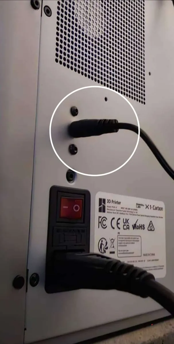

Reluctantly I put a small hole in the backside right corner. The bento hides it. On the back plate I used a print to insert a jack for 24v barrel connector that’s switched.
Looks neat, I got over putting holes in the printer, and now I don’t have to fuss with it.
For other power (lights) I have a 24v tap that comes off the buffer that is switched. I can tap into that for anything I need. Over a year with no issues. Also have a USB tap that can go in it’s place if I wanted.

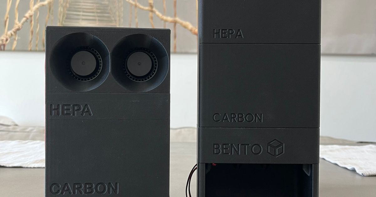

You can have a switch on the side of the Bento, there’s plenty of mods to do that, and run the wire along the bottom of the interior to where the back Z screw is.
Once in there you have 2 options. One is to run it to the printers power, or just feed it under the back panel to your own power source.
The only visible wires are for the maybe 7-8 inches from the Bento to the slot for the Z. Little electrical tape (not a great option) or cloth harness tape (better looking) will hide it.
