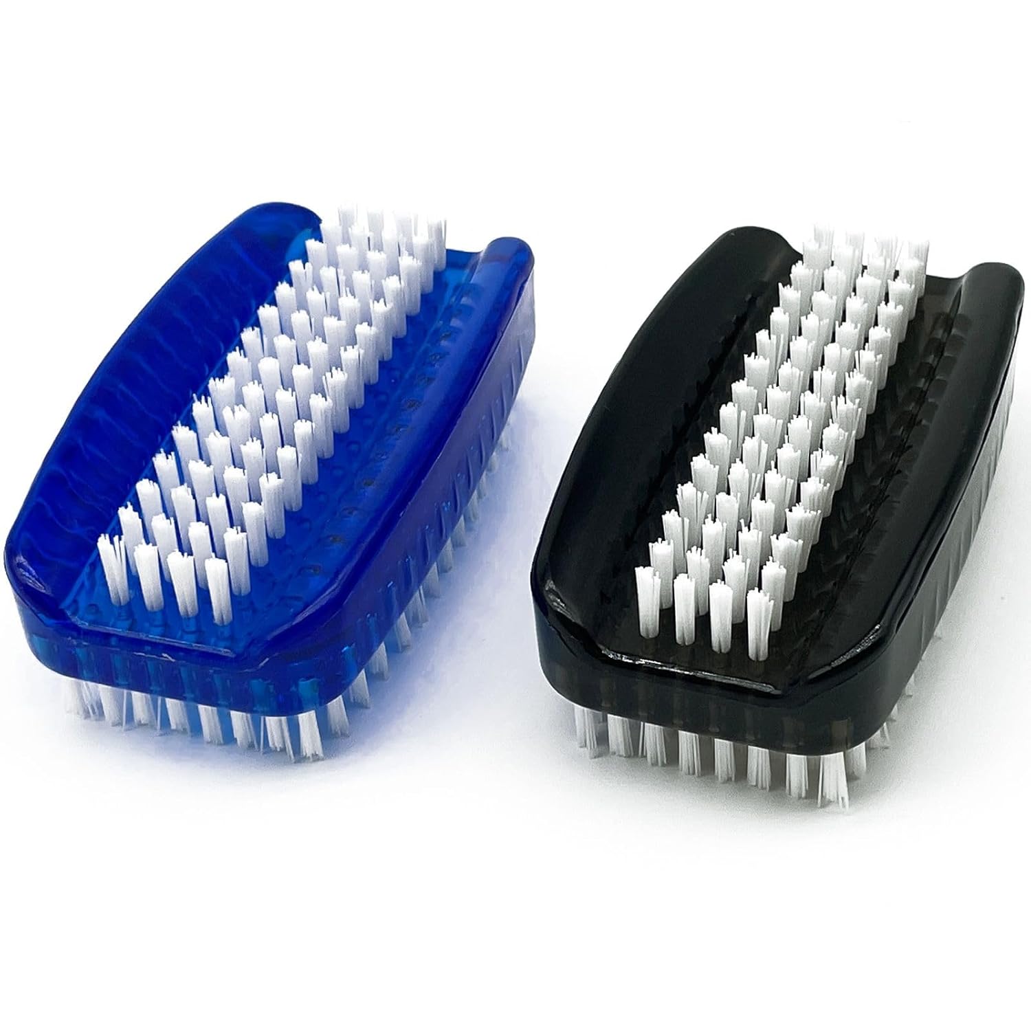

Yes, this is an annoying issue to say the least. You’ve already used the correct cleaning procedure. There are only two other options that may help, the first is to use a nylon brush with Dawn detergent. Do not metal use a metal wire brush or an abrasive pad such as a Scotchbrite pad. Both will destroy the PEI surface.
Something like this is what I mean.

Thanks - I use a soft-medium nylon brush. It is one I can use with a drill so maybe I can use the drill? Right now I use it by hand and go left/right-up/down-diagonals.

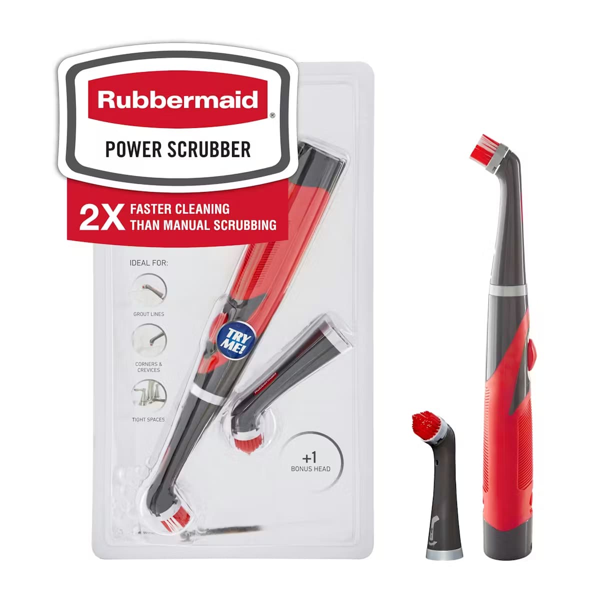

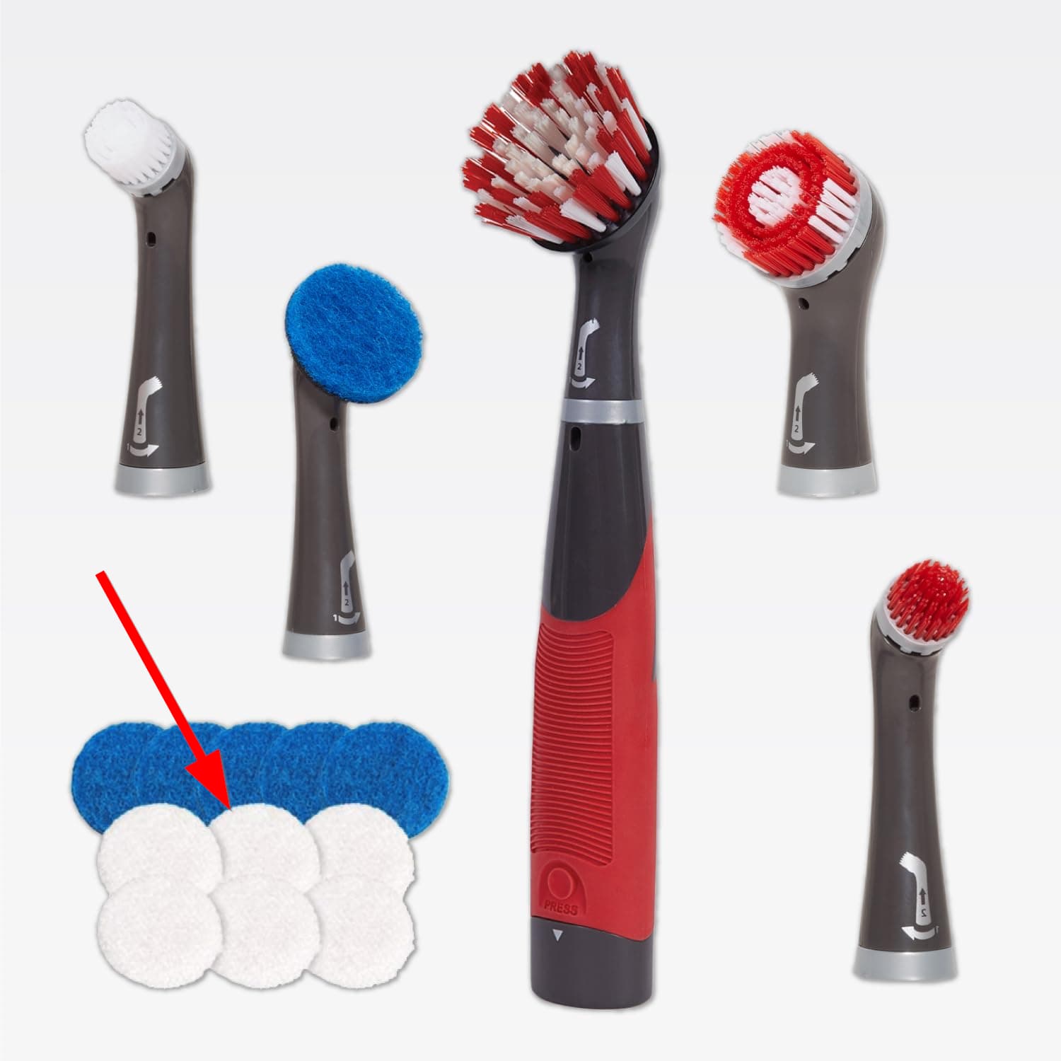

In the case of the nylon brush, speed would be your enemy here. You will find that slow, firm grinding pressure will give you more mechanical advantage over embedded dirt. Plus, using a drill, even with a nylon brush, invites damaging the nooks an crannies of the PIE surface. Even nylon at high speed will tend to polish-up the surface which will impair the “grippyness” of the PEI texture. I speak from painful experience and having damaged more than one Textured PEI plate by using a Dremel at slow speeds with a nylon tip.
If you want motorized, check out this Rubbermaid product. It’s essentially an oversized toothbrush and operates at very low speeds. I found it perfect for exactly this kind of task because its very hard to overdue it.
https://www.rubbermaid.com/home-organization/cleaning-supplies/hand-held-cleaning-tools/power-scrubber-with-1-all-purpose-scrubbing-head-and-1-grout-scrubbing-head/SAP_2057486.html
https://www.amazon.com/s?k=rubbermaid+power+scrubber
Just stay away from the abrasive pads as they will damage PEI.
