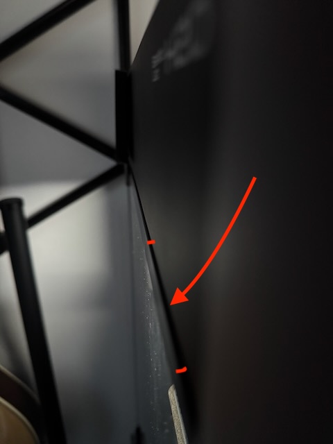

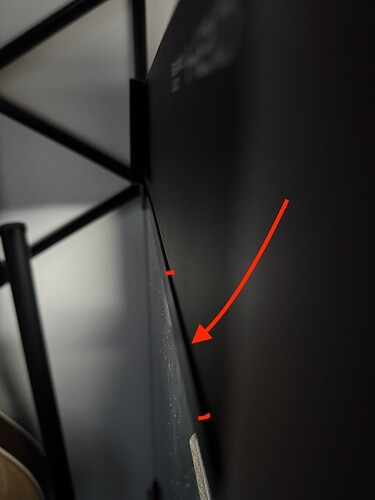

Anyone else notice on their H2D that the top lip of the glass protrudes out a bit and isn’t flush with the front black panel where the logo and screen are?
No, mine sits flat. Maybe the frame is bent due to some shipping problems. Or the foam seam is not installed correctly.
It’s a little less of a gap right now, but definitely not flush. I checked the foam and it might be the one cutout by the hinges is pushing it out a bit. I was running ABS in the heated chamber last night when I noticed it, so it might have been expansion. But I could definitely smell the ABS, and from what I’ve heard from others, they do not. So something is less air tight in mine. Even my X1C didn’t smell that bad when printing ABS.
Your top glass has hinges?
I didn’t say “top glass” …top lip of the glass (the glass door).
Mine is almost flush has 1mm on left and right side maybe try using a straight edge to see what’s off.
yeah mine is about the same, glass protrudes about 1mm on the left and right side (when cooled down). Last night when the chamber was heated to 65 it was more like 2-3mm on the left and 3-4mm on the right. There must be some expansion issue somewhere when heated.
Yeah, the top plastic bezel probably flexes when it heats up. I’ll check mine during the next 65°C print.
My H2D shifted by 0.5mm inward @ 65°C with two hour print.
Oh oops, I read that as the top glass.
not being a troll here, but this is normal i think. You would also notice the side plates getting slightly bent/deformed after high temp printing. The frame of the printer isn’t relying on those panels, the panels only serve as temperature keeper and wind blocker. I would not worry too much about it if it’s not leaking my precious hot air out.
yeah I wouldn’t be worried either as I would expect expansion at those high temps, but I could really really smell the ABS. And other reviews said they didn’t even notice ABS fumes. My X1C never smelled this bad printing ABS, so something was leaking.
