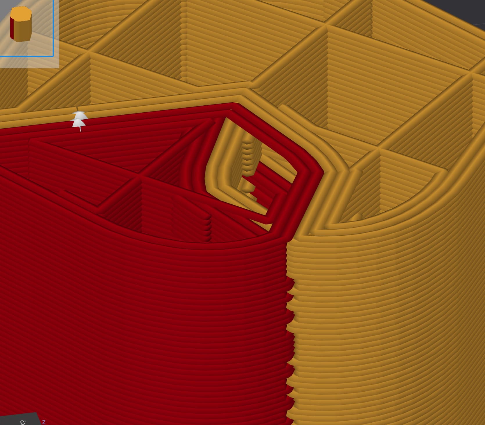

Multicolored piece, I get weird glitches along the vertical separation between two colors on the inward corners. I haven’t seen this behavior on outward edges. The weird thing is that the distribution of the two types of layers doesn’t seem to follow a pattern; it appears random. I hope you understand my attempt at an explanation. :laughing:

When you import the multi-part object into Studio, are you sure it is not applying surface painting to it? Studio v2.5 has a nasty habit of painting objects “behind your back” so to speak. If there’s a paint bucket icon in the object list, that means paint is being applied and whatever filament you assign to that part has no effect. (Paint can be removed by clicking that bucket and then the “remove all painting” button.)
That might not be the issue of course, just checking because that keeps tripping people up. Otherwise I’m not sure what else to suggest… perhaps someone else knows offhand, or you could post your project (or example).
-Max
Thank you, it works, if I don’t use the paint function, I import a composed object and manually assign a filament to each parts instead of painting them.
Cool, glad that worked. I’ve noticed what you describe with the painting tools, where they have trouble separating surfaces that don’t have sharp edges. Probably since they work on a mesh, not the original solids. Converting to mesh with a higher resolution may help, but IDK. Those jaggy edges are actually barely noticeable in the print itself (maybe even add a little strength), but they also bothered me in the slicer preview.
