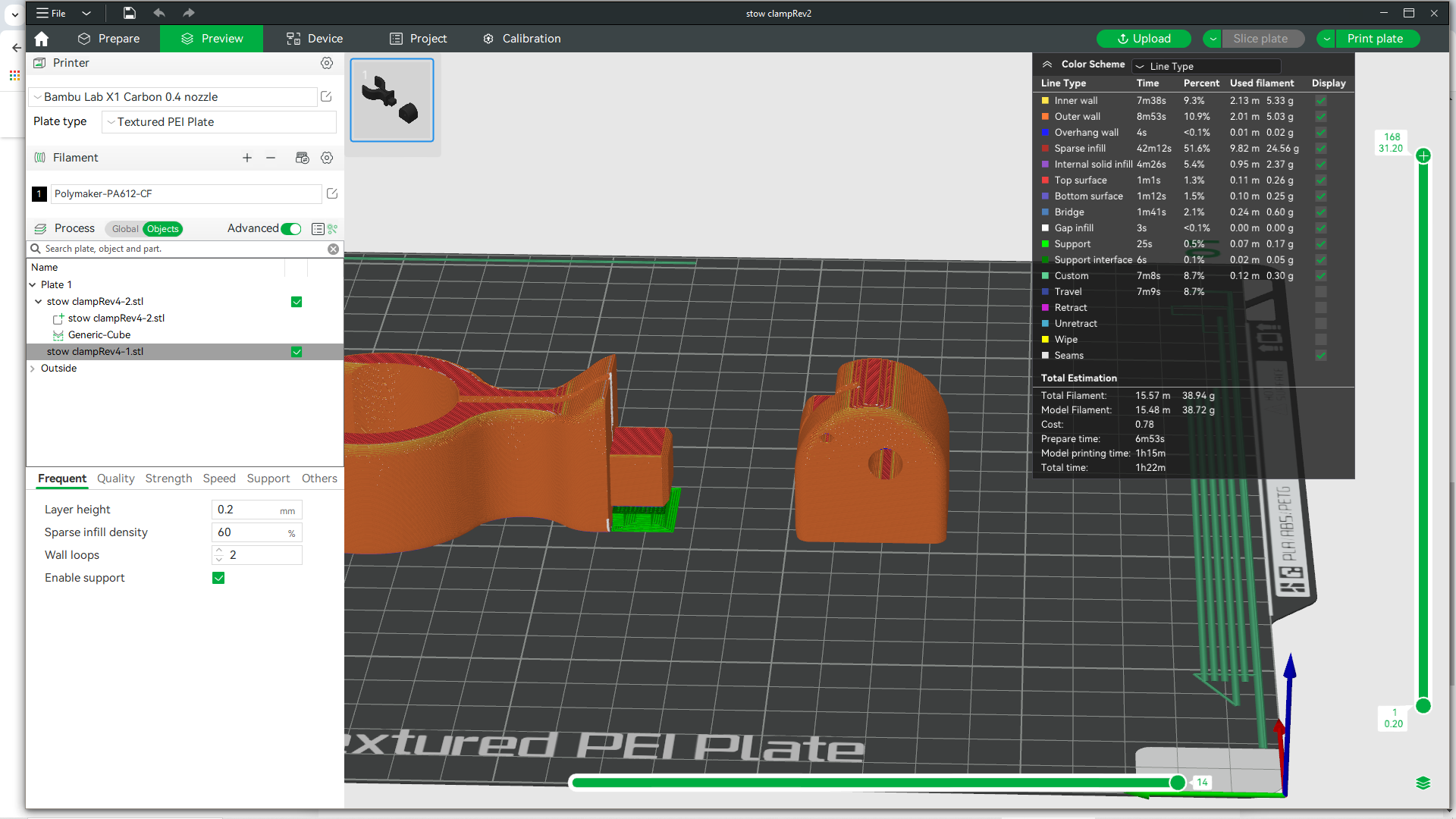

I am glueing PA612-PC to PA612-PC

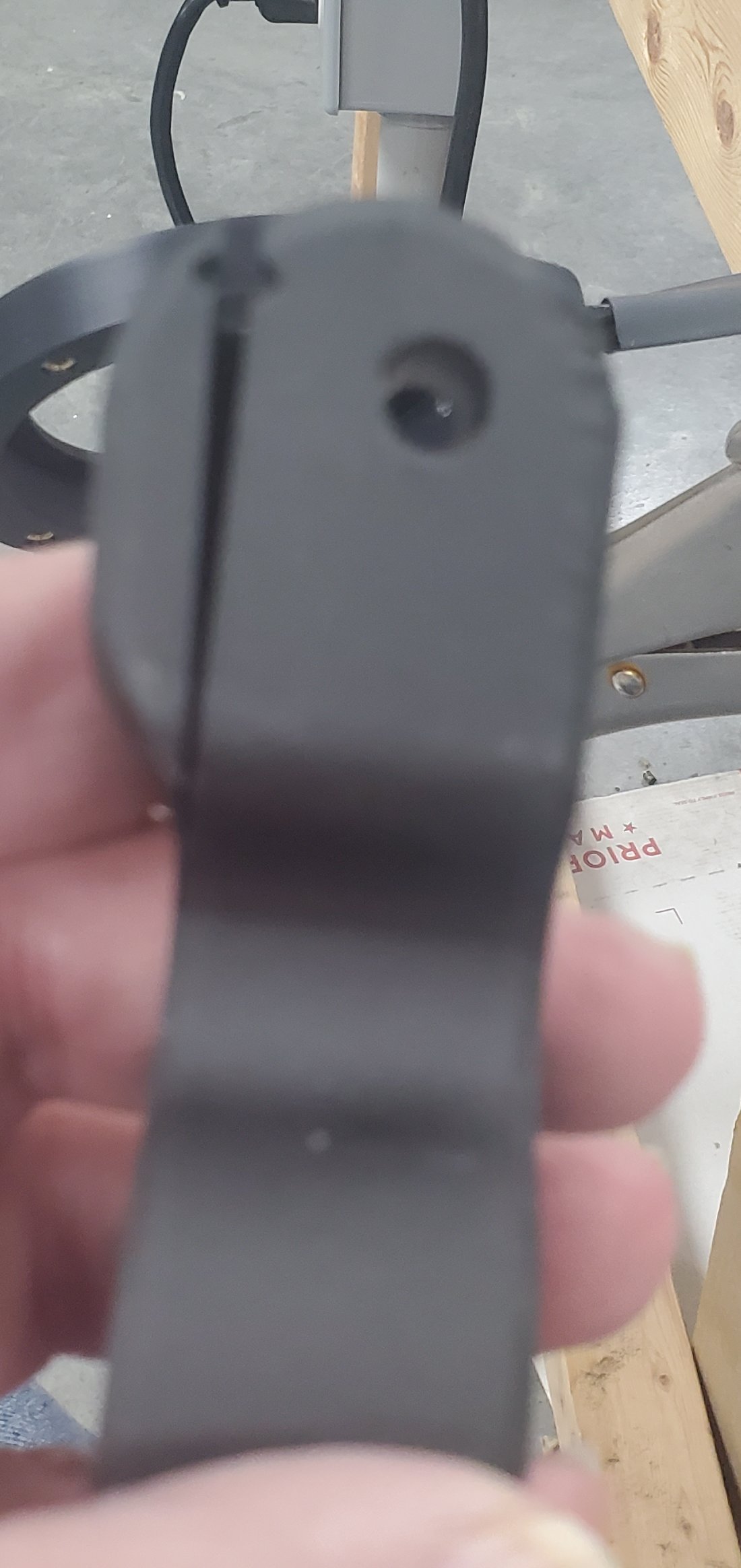

I have a part that delaminated on me so I am splittiing this part in half so I can change the print direction on 1 of the parts to stop the delamation
the little hole is where it delaminated, it has a linkage in this hole
Can you take a clearer picture? That one is out of focus and I can’t see what you’re referring to. Also, if you can post a screen shot of the sliced model showing what the expected outcome was supposed to be, that would help us diagnose what might be going on.

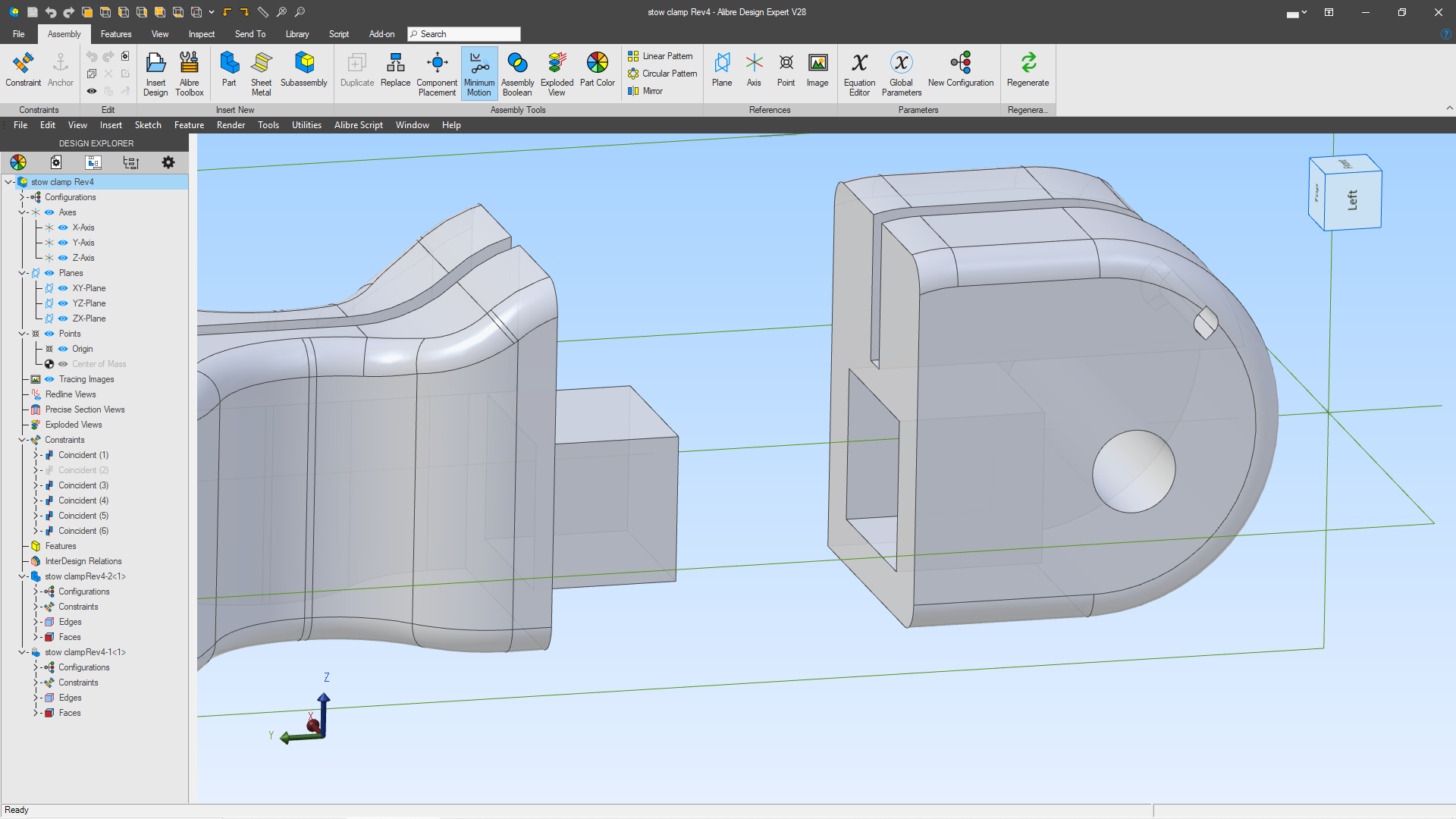

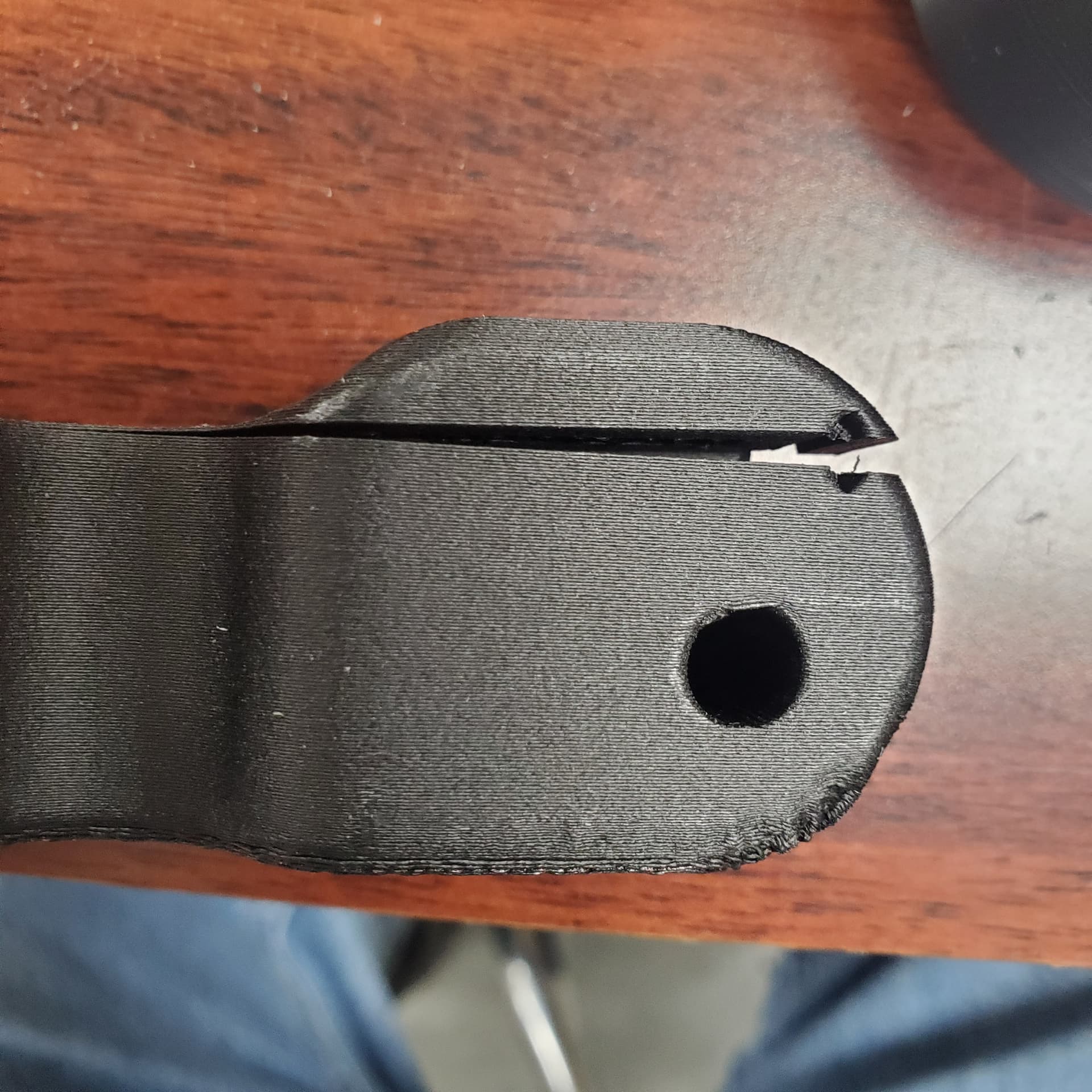

here is a better pic

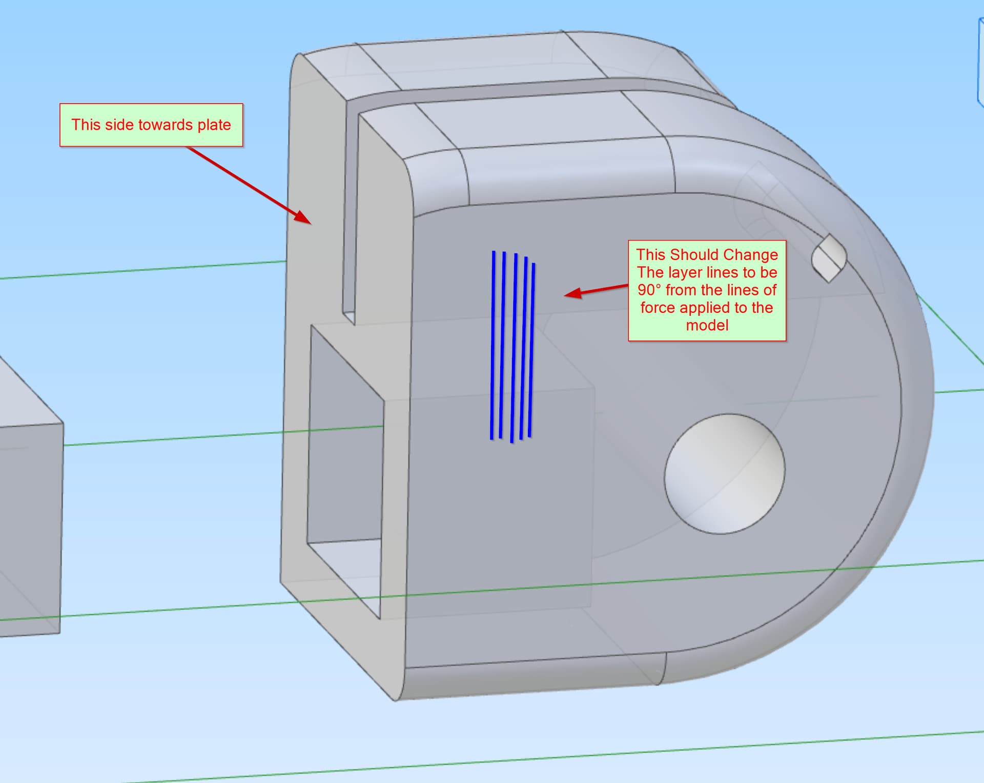

this is the way it was printed

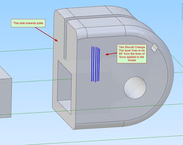

this is what I am goint to glue
Ahhh… that much better and thank you for the CAD screenshot too. I wish more folks would post this kind of detail. It allows for better answers.

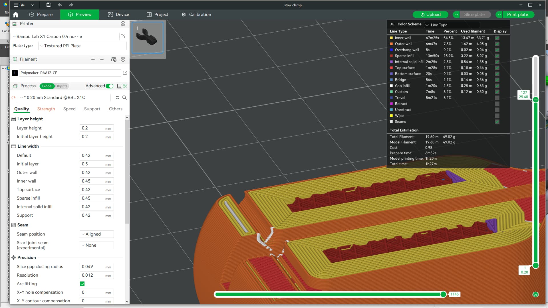

My first reaction is that you may have the temperature of the filament set too low or the cooling fan set too high. Either way, the example show above are consistent with delamination resulting from poor layer adhesion.
There are two methods you can use that might work. The first is a combination of hotter filament(raise the nozzle temp in increments of 5° and turn off part cooling. The second option is to change the orientation of the model on the bed which you were already chasing as a solution when you split the model. By changing the orientation of the layer lines, the lines of force should be less on the layers.

thanks guys for the good info.
I have increased my temp from 260 to 275 and that has made a world of difference in the quality of the print and hopefully will help cure the delamanting probelm and elimante the need for glue.
