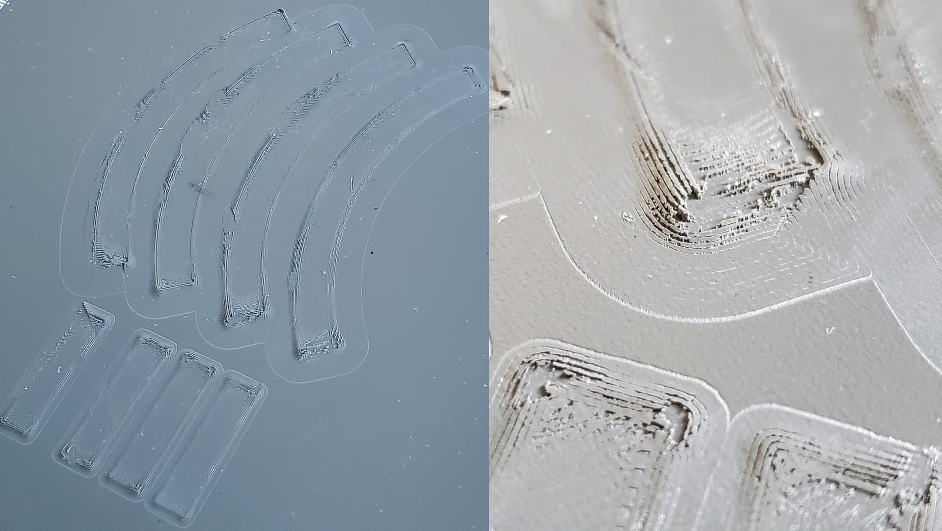

I just bought a new build plate from Bambu Lab that is described as Engineering Plate. I was anticipating it to be a smooth plate but it has a texture to it. Not smooth like a Garolite but nowhere near as textured as the gold plate and maybe a little less than the Super Tack.
I mostly print using PLA or ABS on the smooth plates I have and do not use anything at all as either a release agent or something to help bed adhesion.

I’m confused… is the Eng. plate for P series different than the Eng. plate for H series? Because that’s quite smooth (relatively speaking, but not quite as smooth as super tack pro, or e.g. Darkmoon CFX). It’s not PEI. And glue is required for anything to stick to it, as advertised, according to my experience and most users here. I’ve only seen one person on these forums say anything sticks to it w/out glue. I mean you could just try it and see, depending on the print, YMMV, but I wouldn’t count on it.
I posted some comparison photos of prints from textured PEI, super tack pro, and eng.plate here: Bambu Engineering Plate surface finish - #8 by MaxThreeD

Do NOT use the engineering plate without glue.
It says right in the product description:
Important
Glue must be applied before printing any material on the Engineering Plate.

You don’t need glue on the smooth plate to get it to stick, you need glue to get it to come off. I simply wash with dish soap, I never have a lack of adhesion, on my smooth pei plate I have a very hard time removing PETG if I don’t use glue/hairspray. Even tried 24hrs in the freezer. I dont believe I have ever printed ABS on the smooth plate and dont print enough PLA to remember if it sticks hard.

The primary volatile in glue stick is water, so yes, it does dry. It would make a soggy mess of paper if it did not, and the glue remains weak until it has dried out. Anyone who has ever used a glue stick to keep a print from warping or sliding around the plate can verify that it does adhere.
Glue also serves as a release agent because it is weaker than plastic. The glue layer can pull apart before the part breaks or the plate coating comes off. Often, there is a thin layer of glue left on the part.
