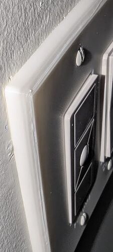

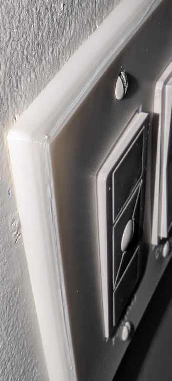

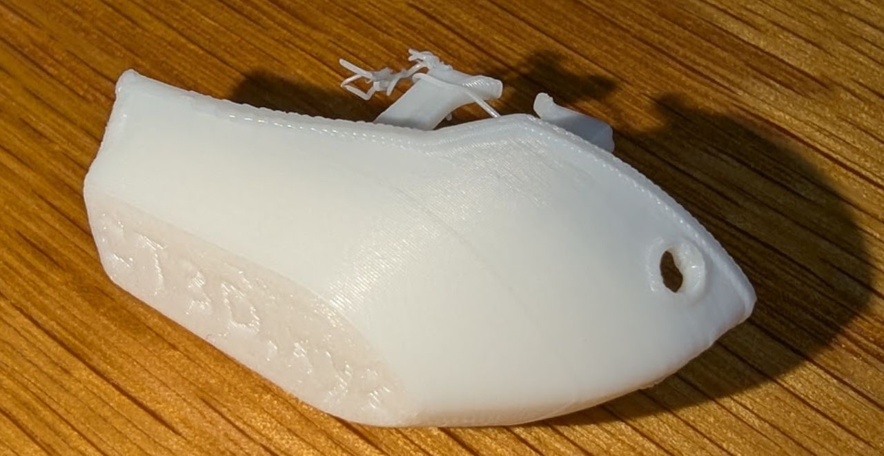

I am printing outlet cover plates (US shapes) and embossing the circuit info into them in small, same-filament print (to be innocuous). I’ve been doing it with the default 0.4 nozzle and the 0.12mm high quality preset. It works decently, but the curved edges have very visible lines that are not completely even. First photo is an example. I did different presets and the 0.12 seemed best. Note that these print with the face (left in this photo) flat on the bed, so the curved edges are slight overhangs. This is OK, but not great, and I wanted to do better…

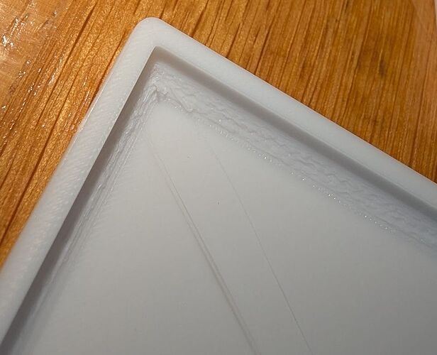

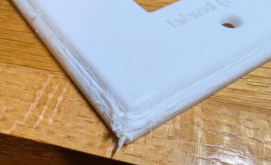

So I ordered a 0.2mm nozzle thinking the smaller lines would be less visible on the edges. But they came out a real mess. This is with the 0.2mm nozzle and 0.06 high quality preset. I also printed one with 0.10 standard preset and it was pretty much the same, maybe just a tiny bit less ragged.

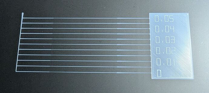

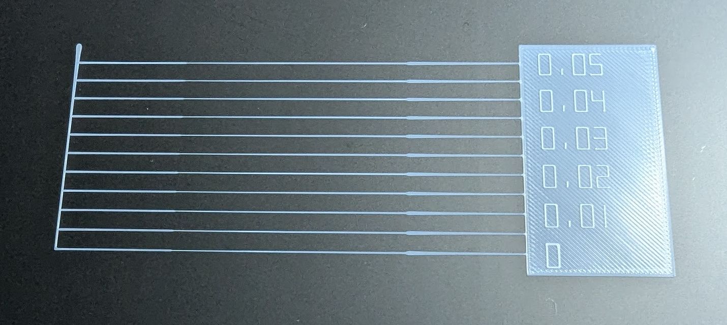

Not knowing what I was doing but grasping at straws, I ran the manual calibration from bambu studio and got this:
To my eye even with a magnifier these lines all look identical (and it stopped at 0.05 and didn’t offer any further up). I’m told by someone on discord they all look wrong.

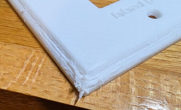

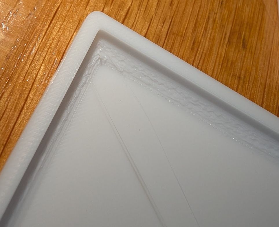

The detail in the embossed (embedded) looks really good, and the reverse side on the smooth area fair, not great, but the corners and edges are pretty poor as well despite on this side curving out, not an overhang.
Am I doing something wrong with the 0.2 nozzle? Was I supposed to do something to indicate it was changed other than telling BS in the printer settings and also slicer settings that it was 0.2 now?

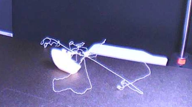

Interestingly and somewhat contradictory, with the same presets I printed a benchy. I screwed up and left the door open however, which may or may not have contributed to it losing adhesion near the top. This is a half-size benchy from the one in Bambu Studio.

Judging by the fillets at the edge of the cover plate
Do you see the problem?
A fillet facing the buildplate will never look good, no matter the settings. After the first layer, you have almost 100% overhang, which just isn’t printable without supports.
So one solution could be supports with a suitable different material, e.g. PETG for PLA or the other way round. Or you use dedicated support filament.
What I typically do in such cases is a chamfer at 50° maybe even 60°. Then I do the fillet on the edge between the chamfer and the wall, so that the fillet goes down to the face, eating up the chamfer.
That way the fillet starts an angle instead of perpendicular to the front face.
I do, certainly in that rendering, but I don’t quite understand. In the 0.4 nozzle example the 1st (bottom) and 2nd layer are overlapping, not aligned. In the 0.2 they are almost aligned, so the 2nd layer’s first overhanging “brick” is unsupported entirely. But that’s not (at least not obviously) due to the size but the initial conditions.
When you go from 0.4/0.12 to 0.06 it SEEMS like everything would be scaled. In other words one should look like a magnified view of the other.
Is there some aspect of this which makes it not proportionally scaled?
I was wondering if it was a layer-to-layer adhesion issue, that the 0.2 nozzle’s output cools much more quickly and so can’t stick to the reduced surface area of the prior layer in the overhang?
Or in particular if this was something tunable – print speed, temperatures, etc.?
Regardless, based on other suggestions I changed from a curve to a fixed 60 degree angle rise, and with the 0.4 nozzle got much better results. Not perfect, but better. I’ve got a 0.6 nozzle in my cart waiting to accumulate enough for the free shipping and will experiment with that.

Instead of a bigger nozzle, you can as well increase the line width of outer walls in the quality settings. It has the same effect as using an actual bigger nozzle. So you can save the money and time.
You could also stick to 0,4mm nozzle and use even shallower layers, e.g. 0,08mm.
But whatever you do, a rounded edge on the buildplate will never print clean. It might become better with those measures but never good.
A continuous overhang of 60° is still asking a lot.
I typically try not to exceed 45°. What usually works is a steep angle like 60° for a few layers but quickly transitioning into a vertical, e.g. by putting a fillet above the chamfer as I suggested above.
If you want the chamfer then I would choose 45° instead of 60°.
