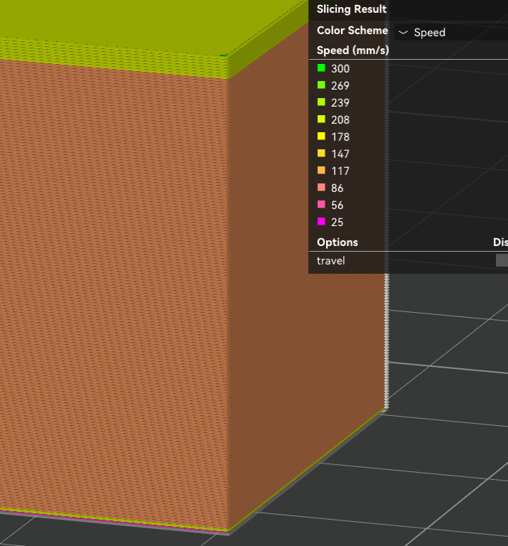

Many thanks for those pic’s. On one hand, it looks much better than your description led me to believe.
I’d start with the basics. Not build plate adhesion, that looks good, but, well, yes. Dry that roll of filament. That’ll make getting a good print much easier. Remember, new rolls are frequently moist.
While it is doing that, you may want to close up the rear panel again to avoid warp inducing drafts.
When you are ready to try again, probably also use some glue stick on the Smooth PEI, take a 1/8 to 1/4 of a paper towel, soak that towel and use it to first dissolve the glue stick lines and then distribute an even PVA/Water film across the plate. Dump the paper towel with the excess PVA after that (which is why you only want to use a small one :wink: ).
That should already take you a long way. If problems persist, I’d look at speeds and/or flow. That single high speed, high flow line at the bottom leads to weaker layer adhesion while those fast, high flow layers at the top promote curling, generating sideways forces on the print from nozzle collisions which can rip off the print. Especially if there’s moisture in the filament.
I was initially concerned that layer time may be an issue, but there’s nothing in the preview that I consider a smoking gun.
A further note, the print must have remained (reasonably) attached after layer 2 and only fractured right at the end. Otherwise, you would have printed a birds nest (literally) rather than a locally pretty good, but torn off, cube.
While there’s clearly something seriously wrong with the high speed, high flow layer number 2 (where also the fan kicks in, but playing with that is opening Pandora’s box and usually not neccessary with PLA), there’s some warping already visible on layer 1. Another sign that the filament is properly soaked.
No, that looks good.
But 1st layer curling can force some serious bumps when that fast nozzle runs over them. Also, that open back panel really promotes thermal issues.
