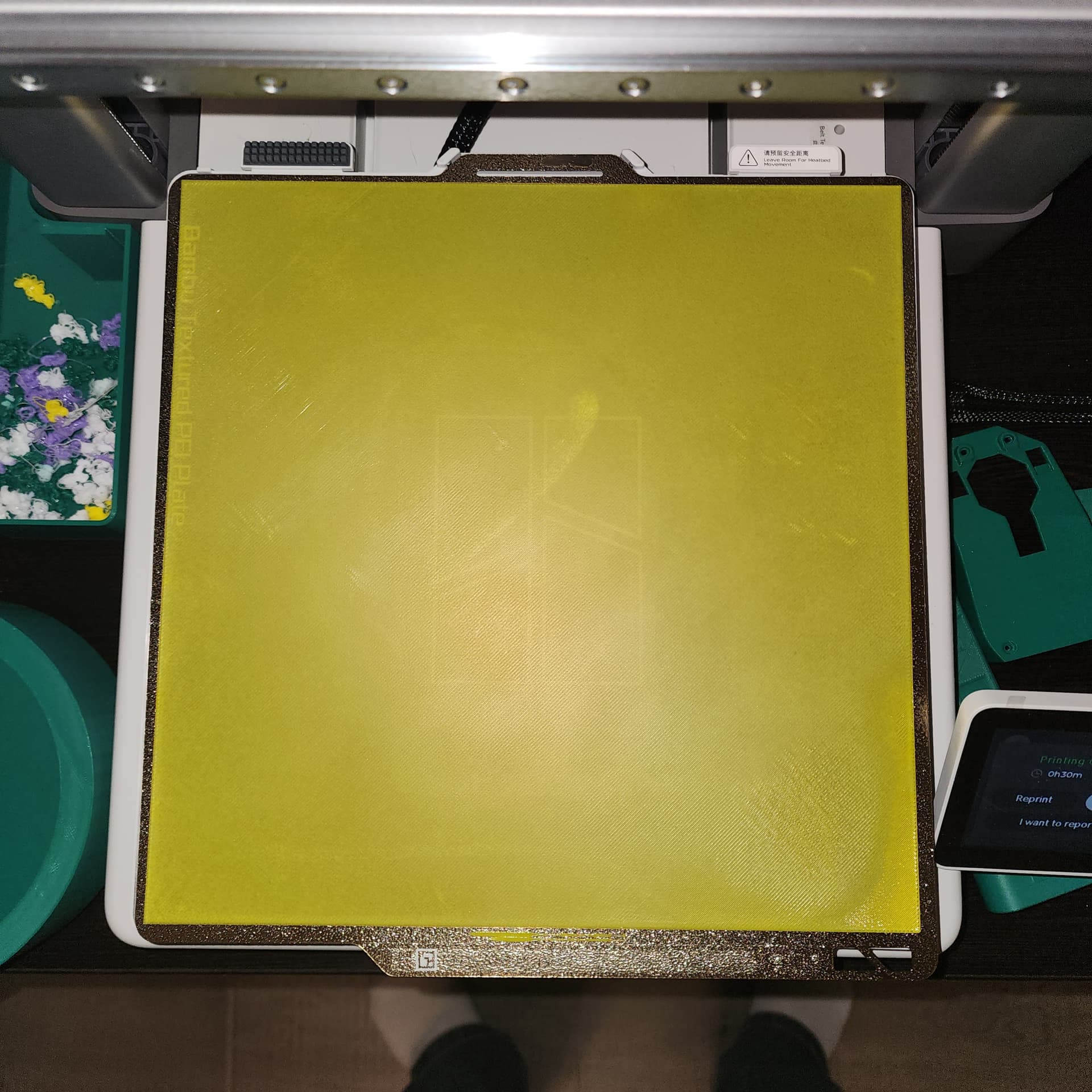

So I have been loving this printer so far, after doing a chip clip with the provided white filament, I loaded up with some old ugly green filament (like really old like 6 years). It oddly print like a champ! Like only one semi failed layer on model I made myself, everything else (a mouse, scraper, poop chute and catcher and a few other things) printed flawlessly.

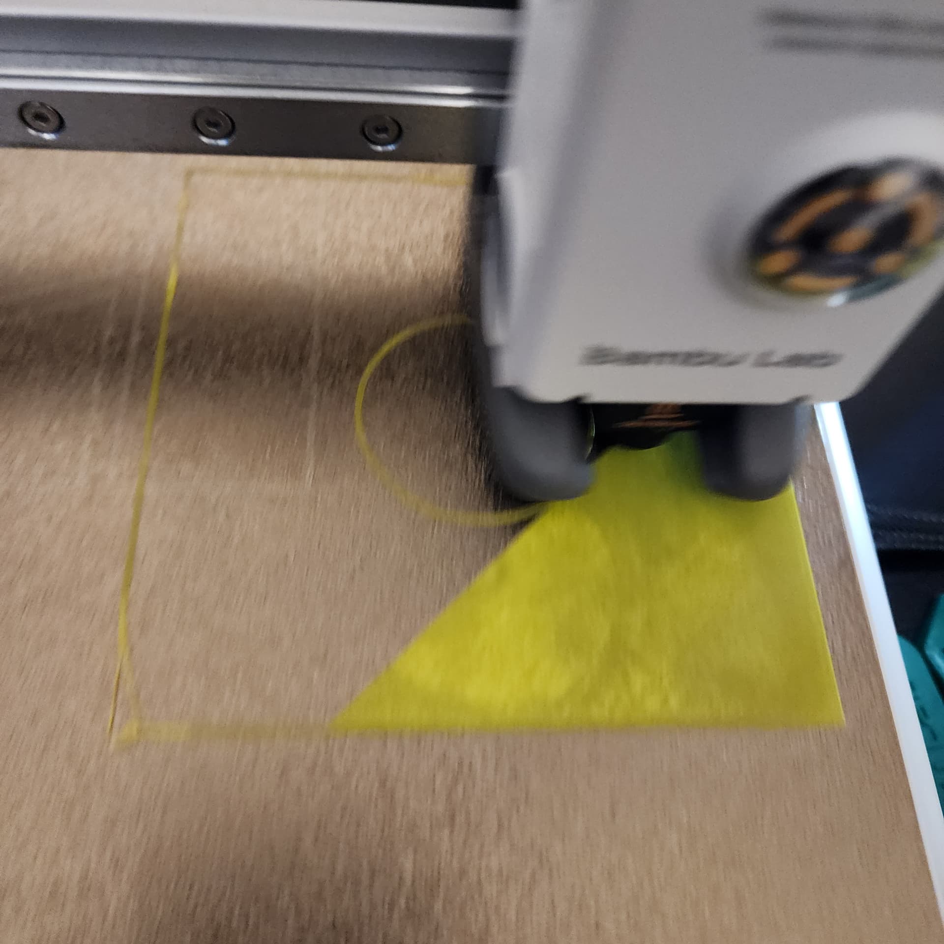

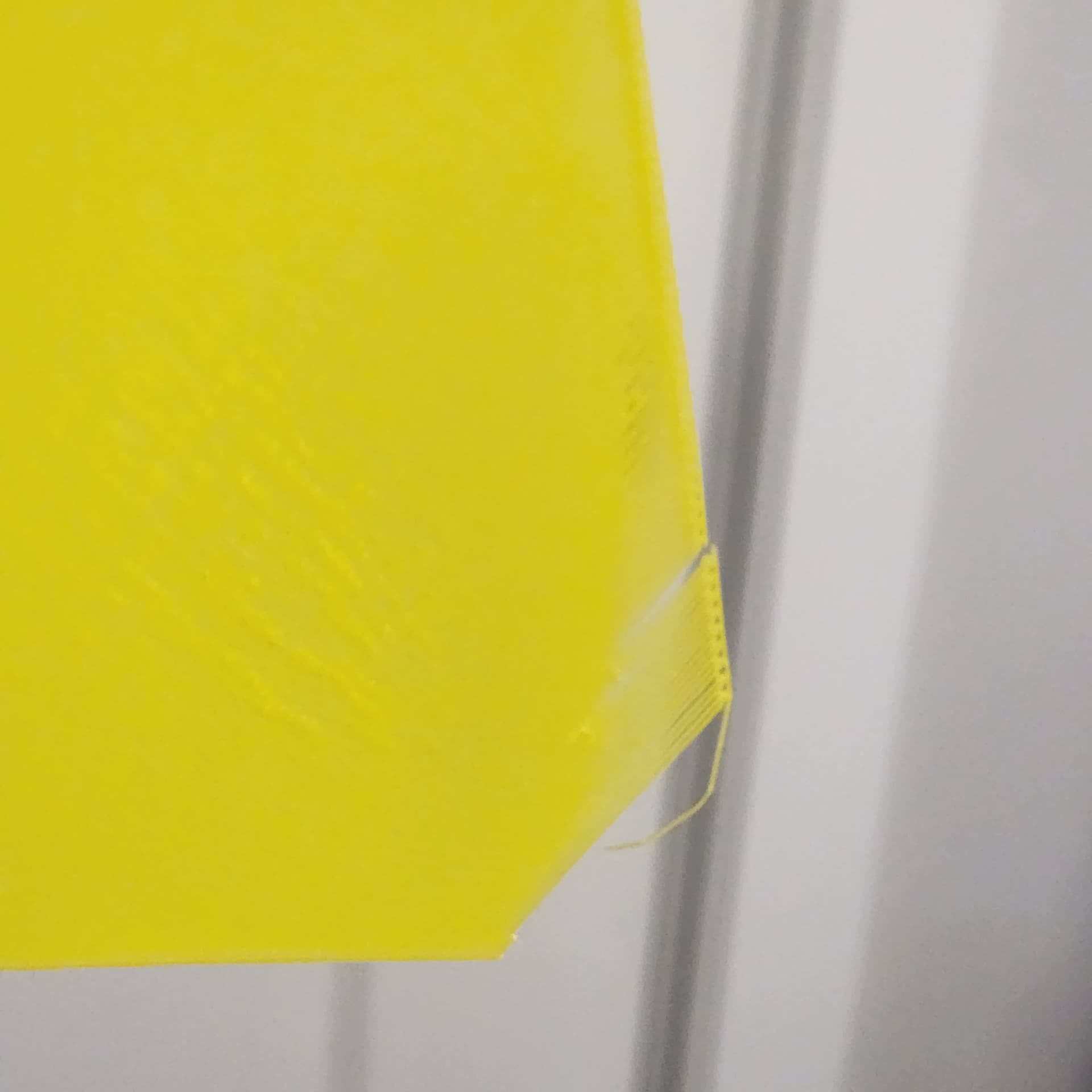

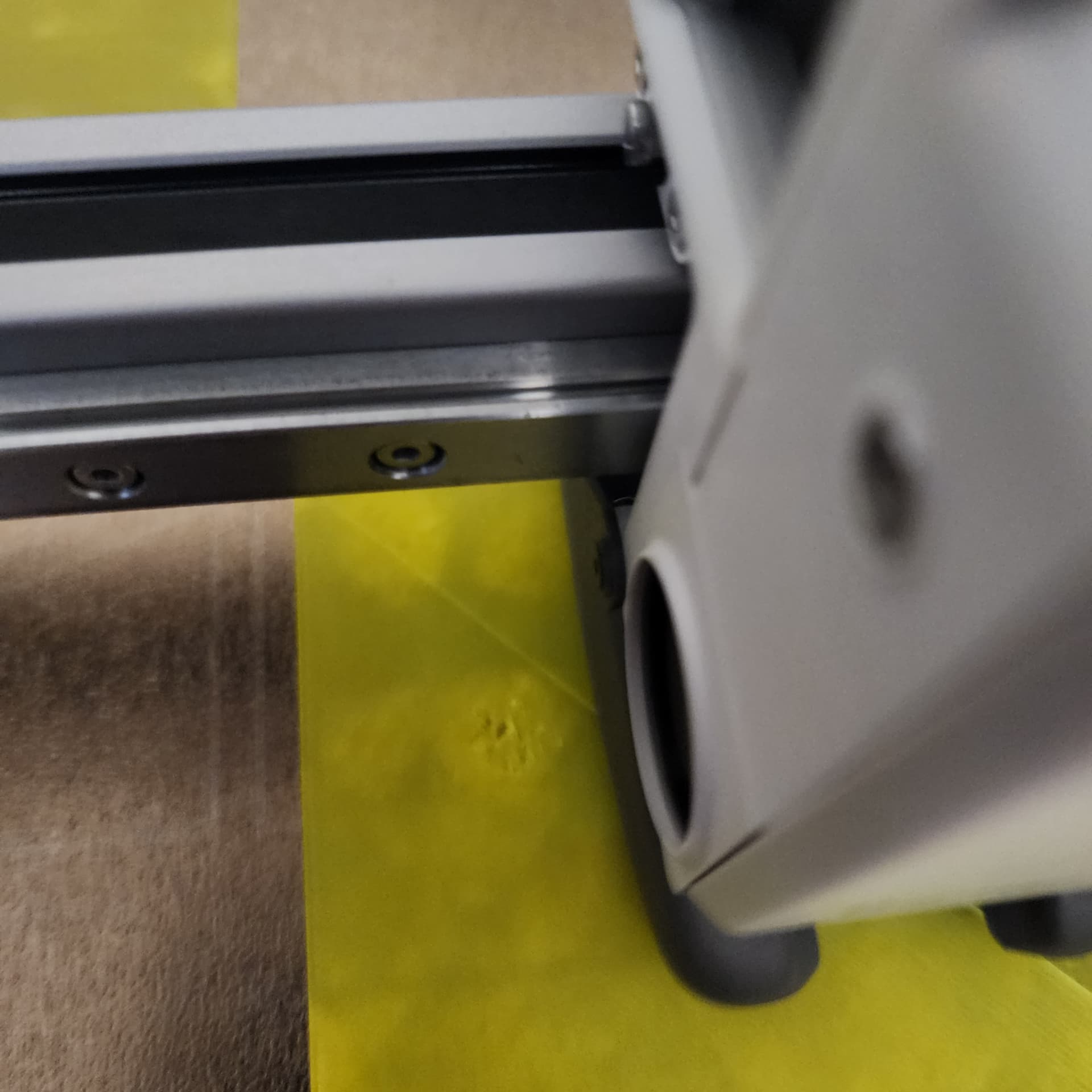

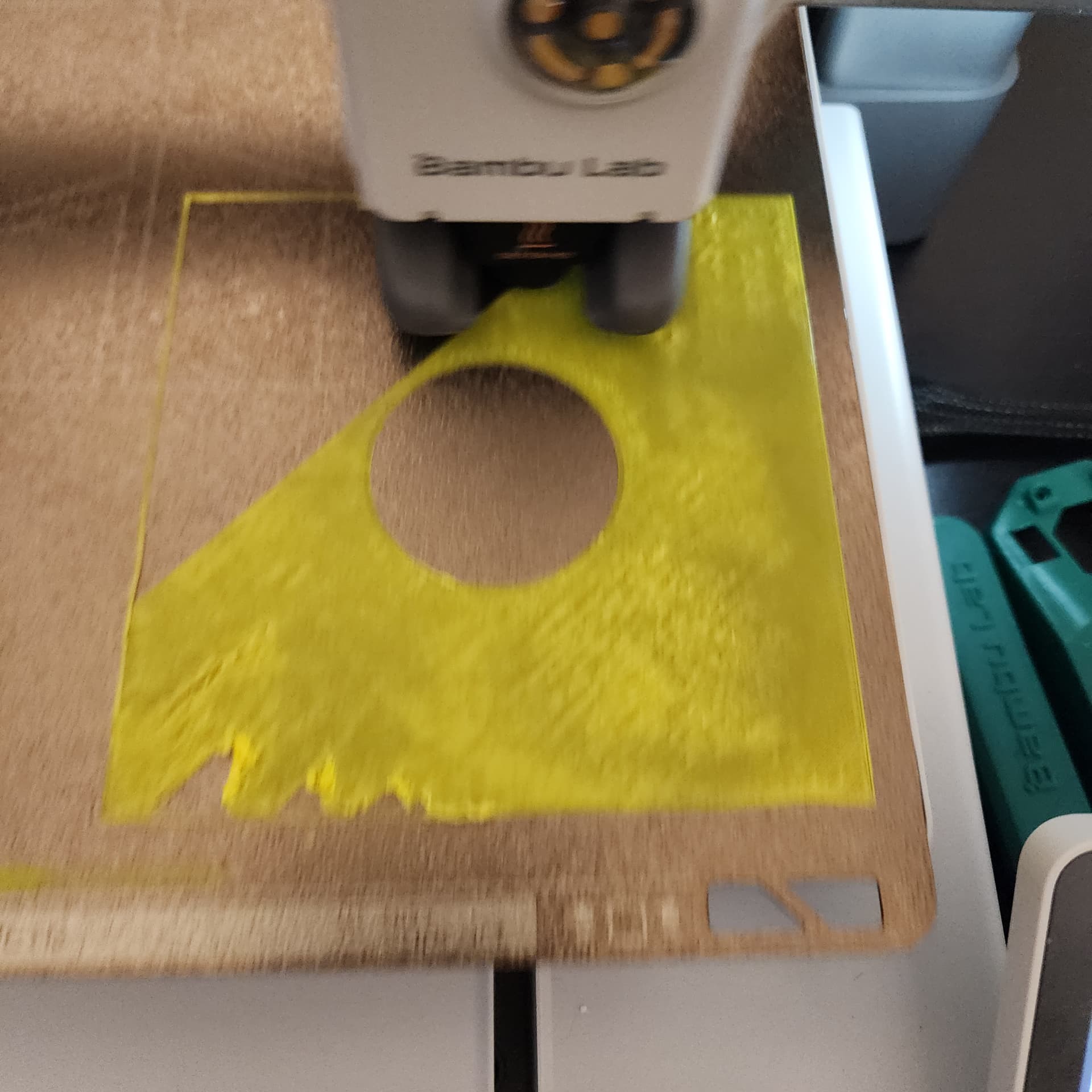

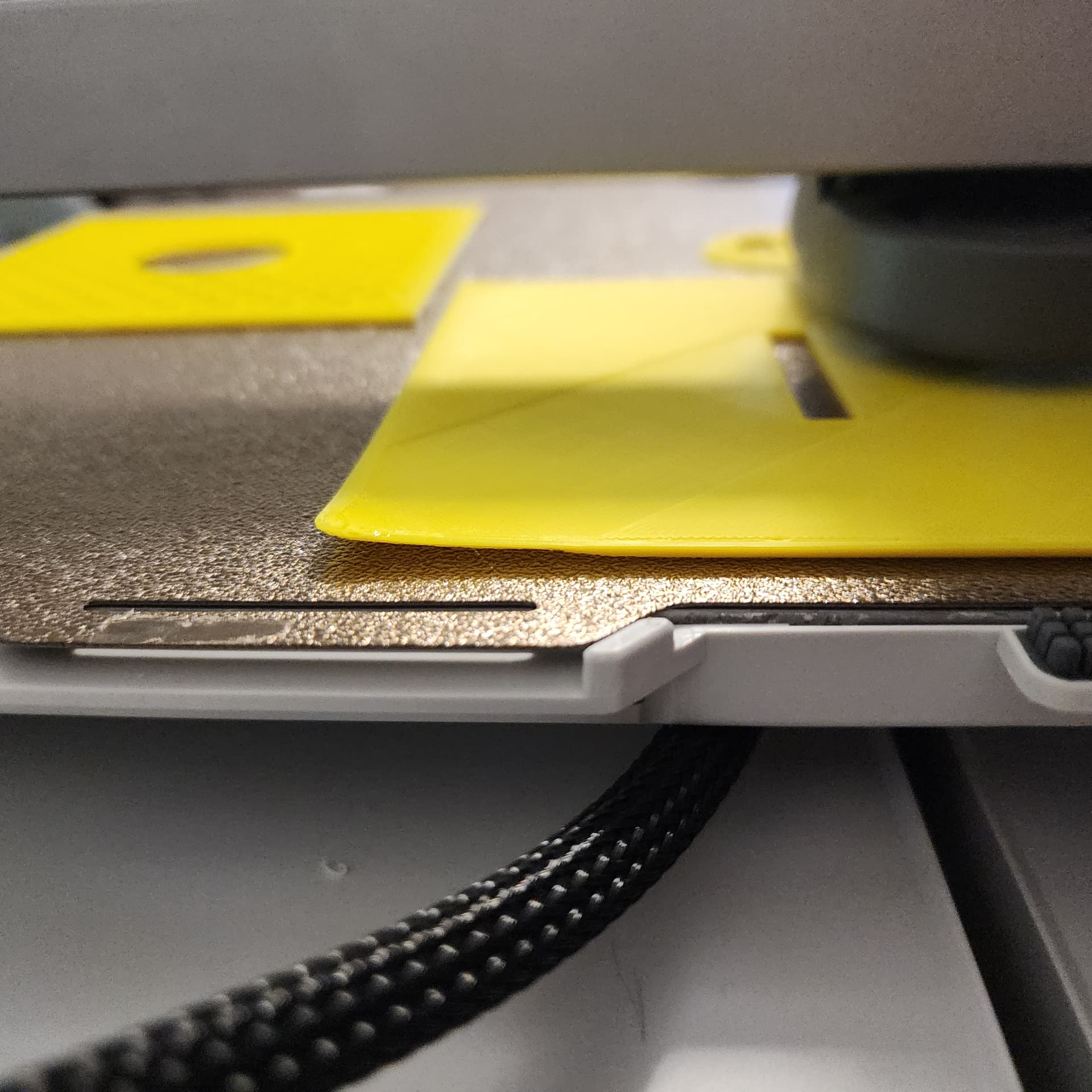

So after that got new filament (esun) yellow…printed and got the worst first layer I have ever seen. (Pics mosted) was in motion though sorry thought they were better. Gave it another go, turned down bed temp from 65 to 60 and then got sort of better layers but as the bigger pieces were being built they peeled up some? I used to do 3d printing when it was hard was never great it, now that this ‘just works’ I forgot what causes the seen issues… that first go with the yellow esun filament was atrocious. Almost like the print head was going to deep or pulling off the filament and also it had like beads in it? I am letting this second go finish even thoug corners of the box and lid are peeled up some…but curious what I am doing wrong with this filament when everything else did just fine?!
Also its the default settings of the model as gotten from here:
Print bed temp 60
Hot end temp 220
it is generic PLA selected
(the pictures were meh :frowning: sorry didn’t realize they were so bad but I think the idea is there.)
I will reprint these just want to know what better maybe settings to try next given this yellow is so fidgeting on the first few layers?

These are classic symptoms of a dirty build plate. Give the plate a good scrub with dish soap and hot water, being mindful to not touch the build surface with your fingers.
Here is the wiki regarding this issue.
I think whenever we suggest to use soap and water that we also mention that IPA isn’t good enough because many people think it is equivalent and disregard the soap and water comment because they “already cleaned it”.

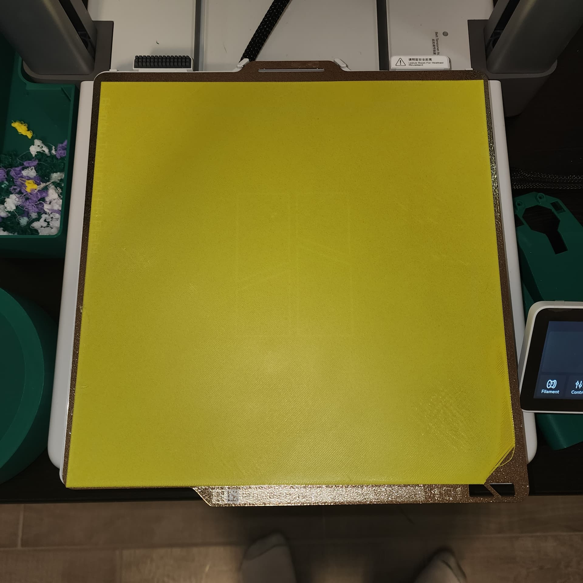

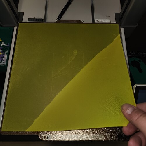

Clean the plate with warm water and soap, rinse it thoroughly and then dry it thoroughly.
Once you return the plate to the printer, try a first layer print and see if the whole surface is smooth and the resulting sheet is in one piece when removed (all print lines are still connected.).
You can make one of your own, or use mine (or anyone else’s to do the check).

Ty for everyone’s input, did the test print. Not sure how conclusive it is. Def better!! But the left front is having issues still… maybe another cleaning? Getting there though pretty happy with this! It all makes sense too, I had done a ton of prints and my greasy fingers surely was touching the surface getting it off etc.
Went ahead with the print again so far it is immaculate :slight_smile:
