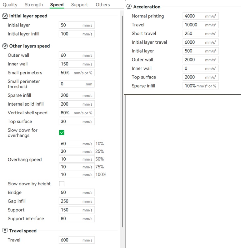

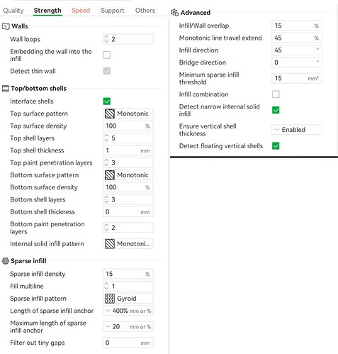

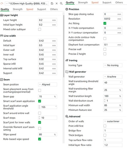

Hi,
I’m trying to get rid of the lines marked with red circles on the first layer of the print. The issue appears mainly in the center of the print. Near the edges and at the joints of the graphics, it looks fine.
Do you have any suggestions on what settings I should adjust so that the lines blend together?
Settings:
G29.1 Z{-0.02}
Initial layer nozzle temp: 230 (220 is standard)
Factor K 0.04

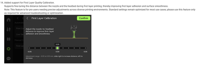

The nozzle might also be too high. Even though it might look fine in some areas I would still recommend lowering it. If you aren’t on the latest firmware update, do that, and then go to settings → first layer calibration. This is the description and image from the Bambu Wiki firmware change log:
I would start off with lowering it by 0.02mm or so. I did that on my P2S and never had first layer problems again.
