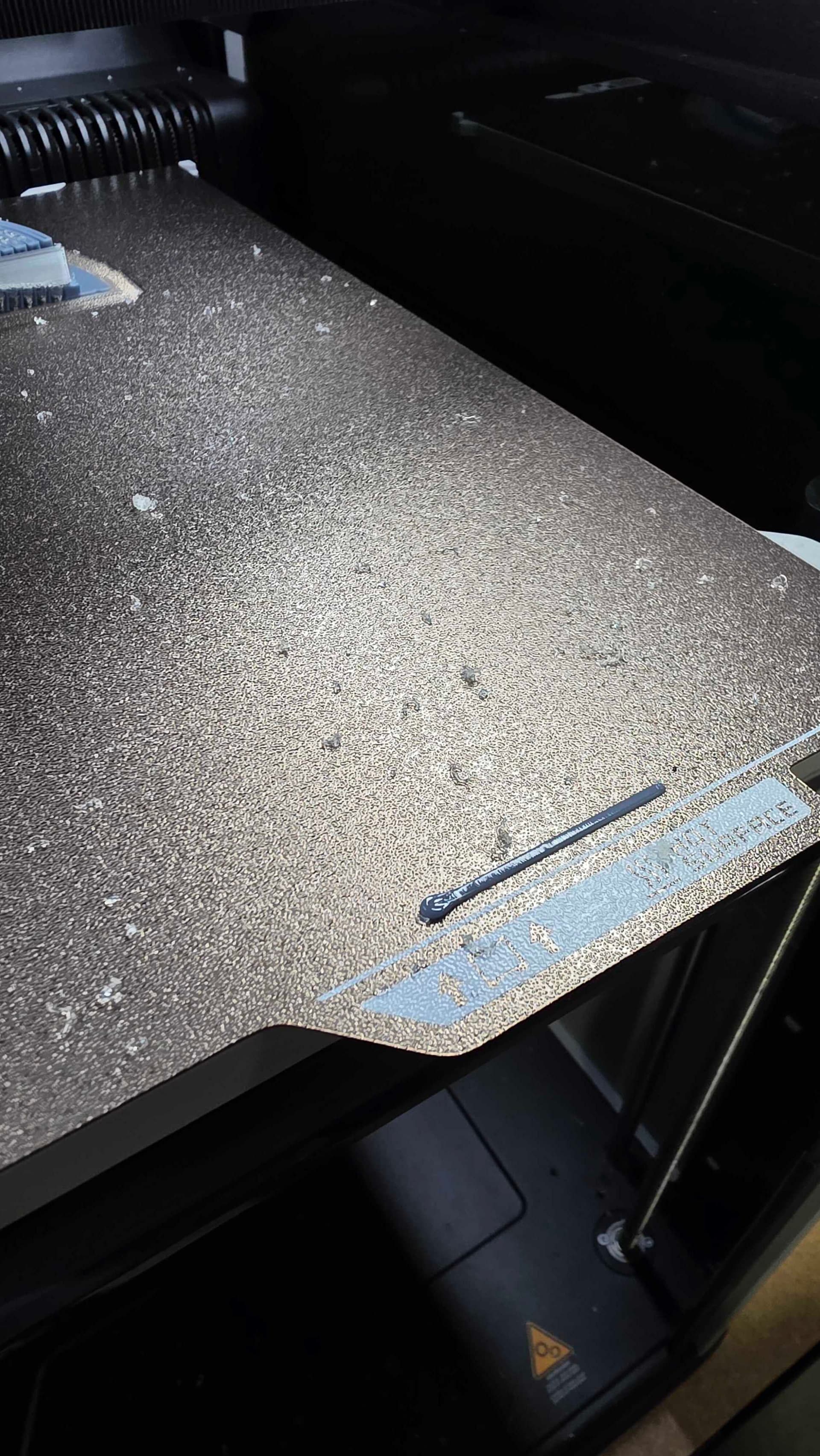

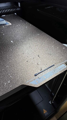

@mecha Wondering if you could use that brain of yours to help me out here. Unfortunately, I cannot post photos of this specific model, but if you’d like, I can share the print profiles/settings. However, I am using your profile almost to the T. All the settings except for the normal expansion are the same (I went down to 0mm since it was going to print PVA on top of PLA for this model and was not sticking in trials)… Well dried before, kept at 60C the whole time, etc…
What I’m seeing (in the photo below) is basically ripped off or chunking “crystals” much like raw sugar. This doesn’t happen much at the start, but does appear more as printing goes on. (This is roughly 24hrs into a 3-day print) I’ve had this happen before on the same model and am not really sure what the source is. Essentially, you can think of this model as many nested hollow sphere halves with coaxial, conical holes/negative space that extends from the outside at the largest towards and interior opening at the center of the sphere…
I’m not sure if it’s just because of the “shortness” of the moves when it is making the PVA lines (think like 5mm of travel or less sometimes), but I am also seeing what looks like blobs or lifts sometimes at the start and end of lines… Any thoughts or advice would be appreciated.

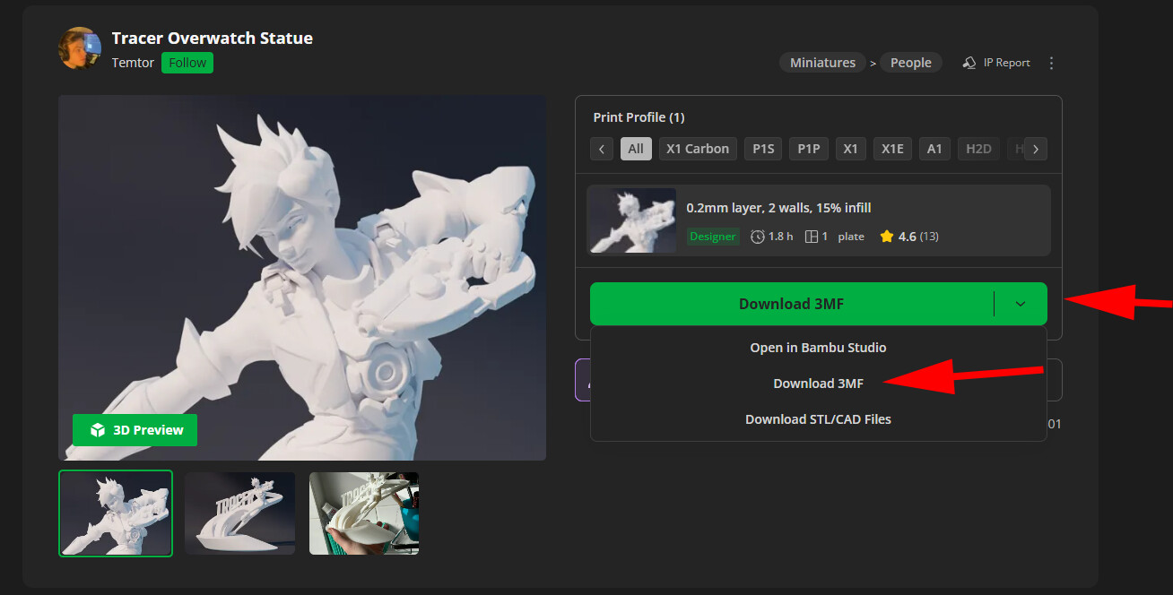

Unfortunately, Google won’t let me download the 3MF, it says I am not permitted to access the file. Is there any other way to get it?
I tried to attach it here but it’s too big. If you go to Makerworld you can download it there:

I’m trying to get the 3MF file for PVA, not the model. Thank you.
Oh sorry, I see what you mean. Looks like his Google folder isnt set to shareable anymore. Hopefully he’ll see this and update it.
