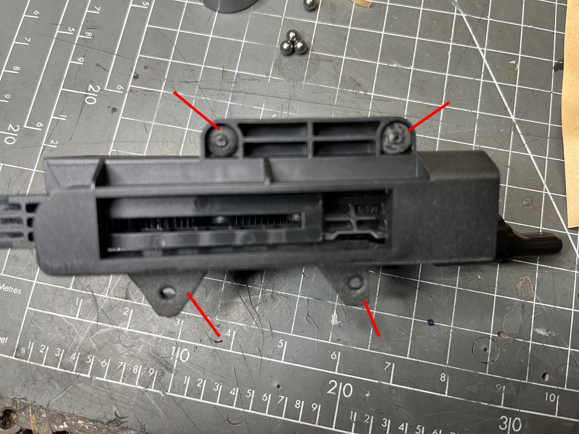

Solved // Solution guide. Now the loudest part is the AMS unloading filament!
Remove spring and ball, replace with magnets. Credit goes to this post https://www.facebook.com/groups/603696475392327/posts/921169733644998/
Guide is for the Left Stopper Cutter on H2C (change location of one 3x1mm magnet for right side stopper), similar for H2D - H2S reassembly may be different. As always turn off and unplug your printer. Not responsible for damage, injury, warranty issues, etc.
Tools with need 2 and 1.5 hex bits, super glue and a 3mm hand drill. I used Bambu lab one Hand Drill Kit | Bambu Lab US Store
Parts 2 3x1mm magnet and 1 4x5mm magnet (stack 2 4x2mm plus 4x1mm or stack 5 4x1mm magnets) per stopper. I used 390PCS Small Strong Magnets in 6 Different Sizes,Neodymium Disc Magnets Heavy Duty,Rare Earth Magnet Small Round Magnet for Industrial: Amazon.com: Industrial & Scientific
Install magnets and check if they are flush and polarity are correct before using glue. Install the 3x1mm magnets using 3mm hand drill, go slowly the plastic is thin and can easily drill right through. Drill a little at a time and repeatedly check for flushness.
Reassembly for H2C differs from official guide to prevent over travel with magnet mod, see “Flush” Picture. Official reassembly guide half way down page H2 Series printer filament cutter stopper replacement and tooth jumping repair guide | Bambu Lab Wiki
Install stoppers back into printer, while printer is off and unplugged move tool head back and forward to check function of stoppers.

I did something different and I’m not sure it’s not subjective (my hearing is not the best…) but I think it has reduced the noise without too much rework. I think I will try the magnets just for the fun of it and because I like it and if it reduces the noise further, I’ll be glad.
Here’s what I did as apart from the ball I felt the noise was amplified by its surroundings and also by the stopper slider hitting the screw at full travel.
  1. I replaced the plastic ball (4mm dia.) by a metal ball from a roller/skateboard (608) bearing (3.9mm dia.). I did not take a photo of it installed but you get the idea
  2. I applied foam tape (1mm thick) in several locations

Thanks! I made the mod and it makes a huge difference.
One mod I made though is to replace the 3x1mm magnets by 3X2mm as I felt 3x1mm did not provide enough magnetic force.
This can’t be done will a drill bit but I used a end mill to do it. You have to be very careful of course to avoid going through on the end hole and even with the end mill you cannot really go deeper than 1.7/1.8mm which would require after installation and the glue has set to file a little bit the end of the magnet to make it run around without catching anything. I does not really need to be flush as there is some clearance between the rotating and the stationary part but I did it anyway to make sure.
Also, I did not understand the requirement for modifying the travel of the smaller rack unless I missed something. It didn’t work for me so I went back to the original protrusion on this rack, may be the stronger magnetic force is helping.
