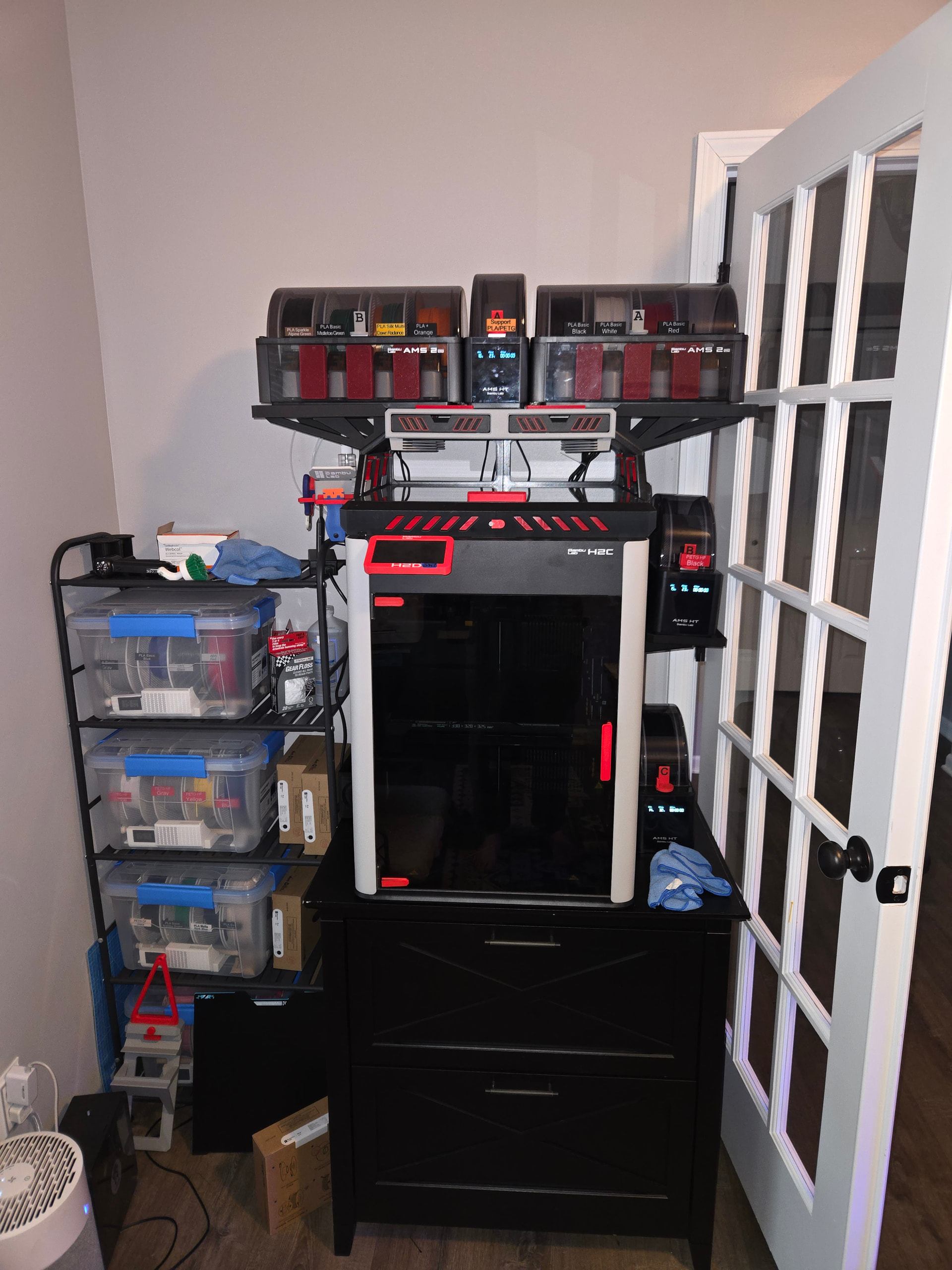

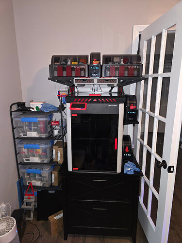

I have my stack on top of the H2C. I also loaded up the Skadis grid with tools, screws, magnets and gears.
There’s also a Skadis HT holder around on MakerWorld somewhere. So I’d actually put all AMS on top of the H2C.
I do need a foot step to get up there, but since I have the same set-up for my X1, it isn’t really a problem.
Putting everything up there free’s up precious table space (maintenance, a place to put down spools,…) or allows the use of a left sided poop slide.
Full support from me :grin: You could also mount a board up behind the printer where two or three AMS2 could sit if you don’t like putting them on the H2C.
