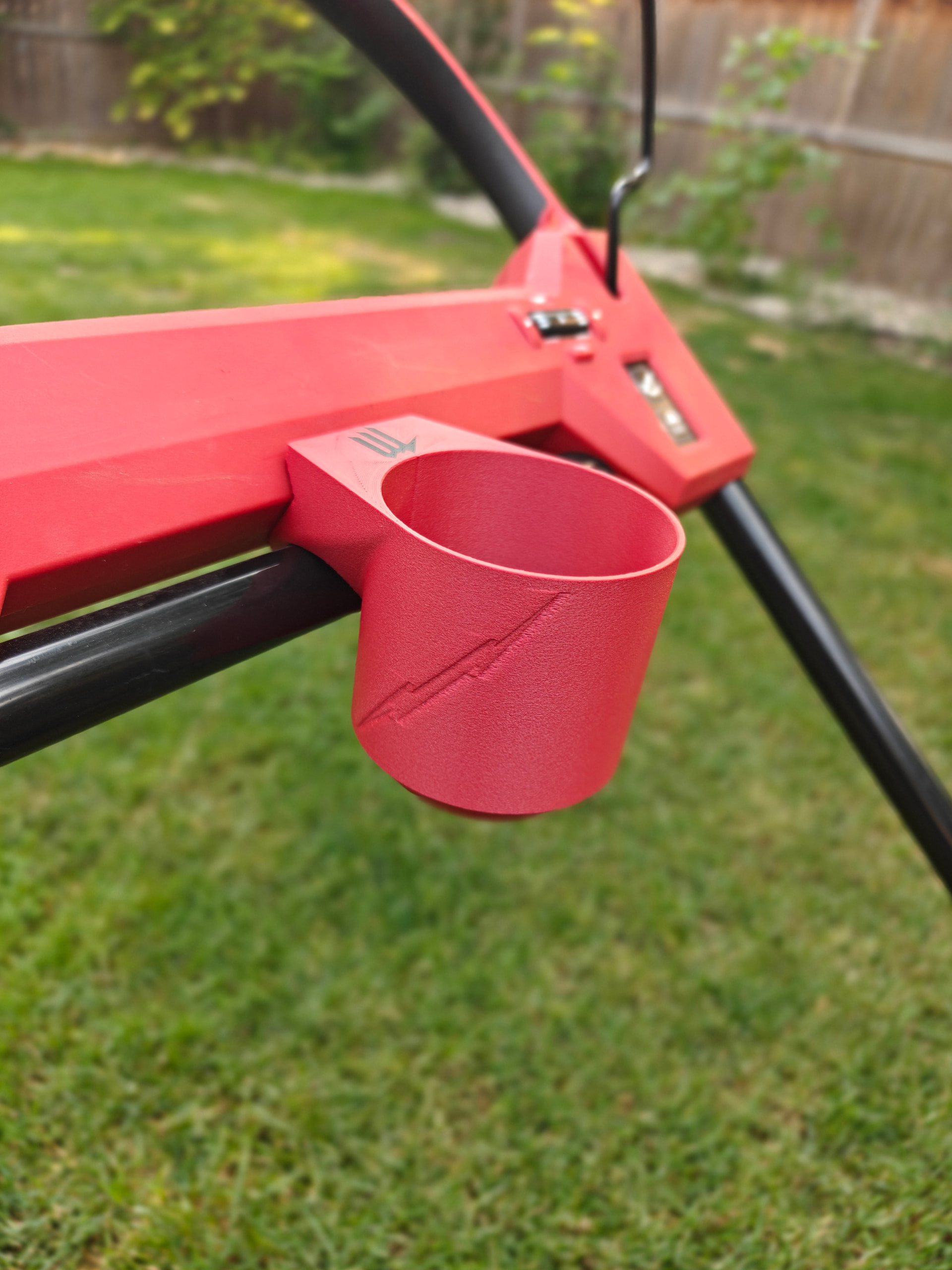

Ya, the prints came out great using the Generic PLA-CF. This is my first high end 3D printer and I’m just amazed at the results.
