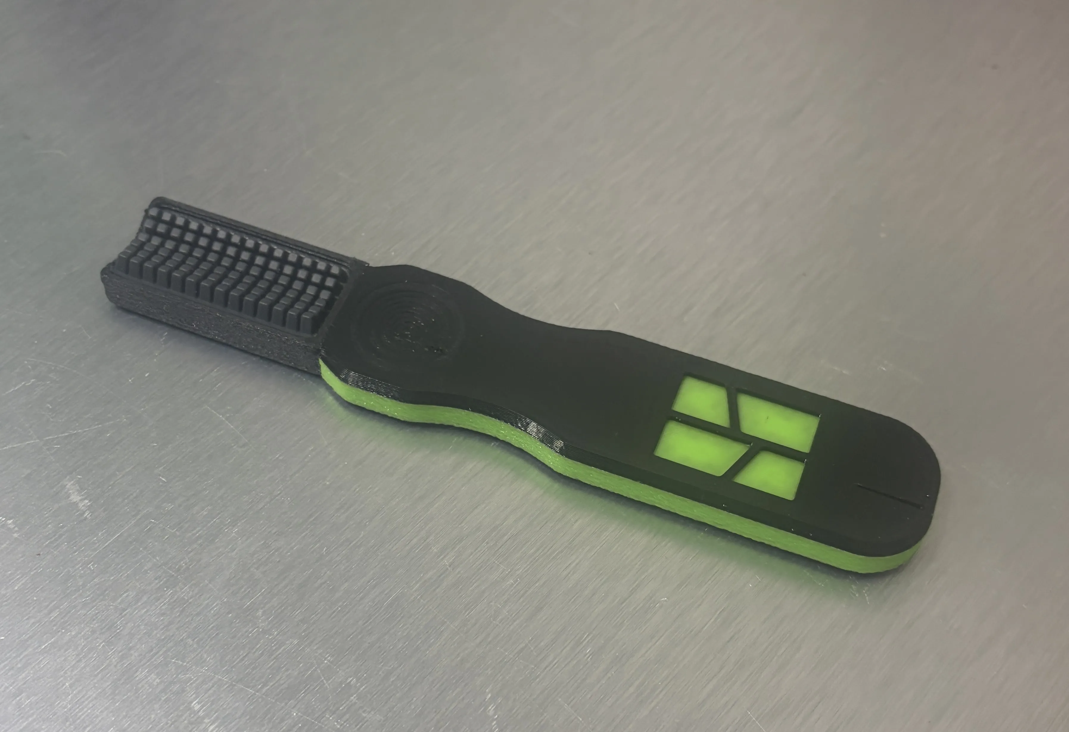

I have printed TPU together with other engineering materials like PA and PPS. Here is a nozzle brush from TPU for AMS with PPS-CF tip for heat resistance. Main thing you have to do besides the already mentioned setting in BS is turn off the chamber heater and turn down the plate temp so the TPU wont fuse to it. For this specific project I used a G10 plate so the PPS would still bond to the plate at 50c, you can also use a strong adhesive like nano polymer on a standard plate. Beam interlocking must be turned on for any materials that dont bond to TPU chemically.
