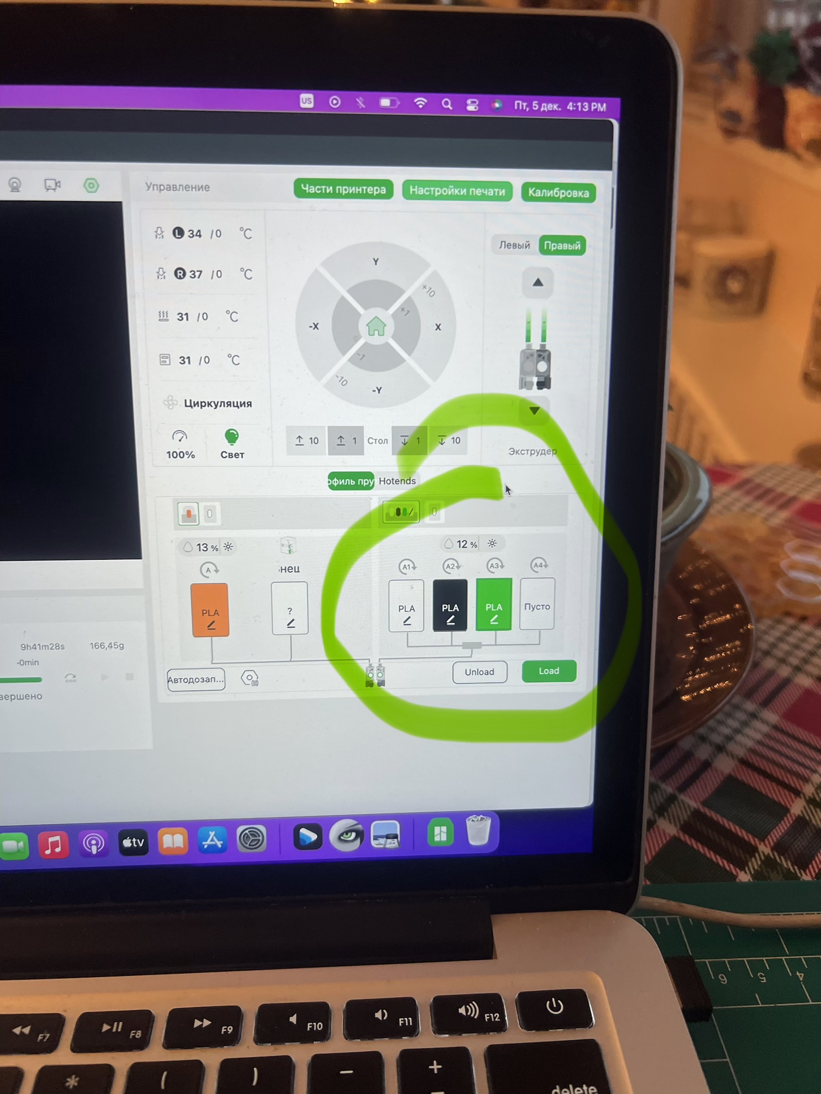

Hello. Yesterday I received my long-awaited H2C. Before this, I had an X1C, so I have experience using Bambu printers. And for almost a whole day now I haven’t been able to solve one problem: the filament calibration menu for the right hotend is inactive! No matter what I do, nothing works. There’s no clear answer about this on the wiki.There are no issues with the left hotend. Everything works as it should. Please help me figure this out.
I have exactly the same problem. I can’t calibrate the filament in the right nozzle.
I received a response from support. I switched the program language to English, and miraculously, everything works.
