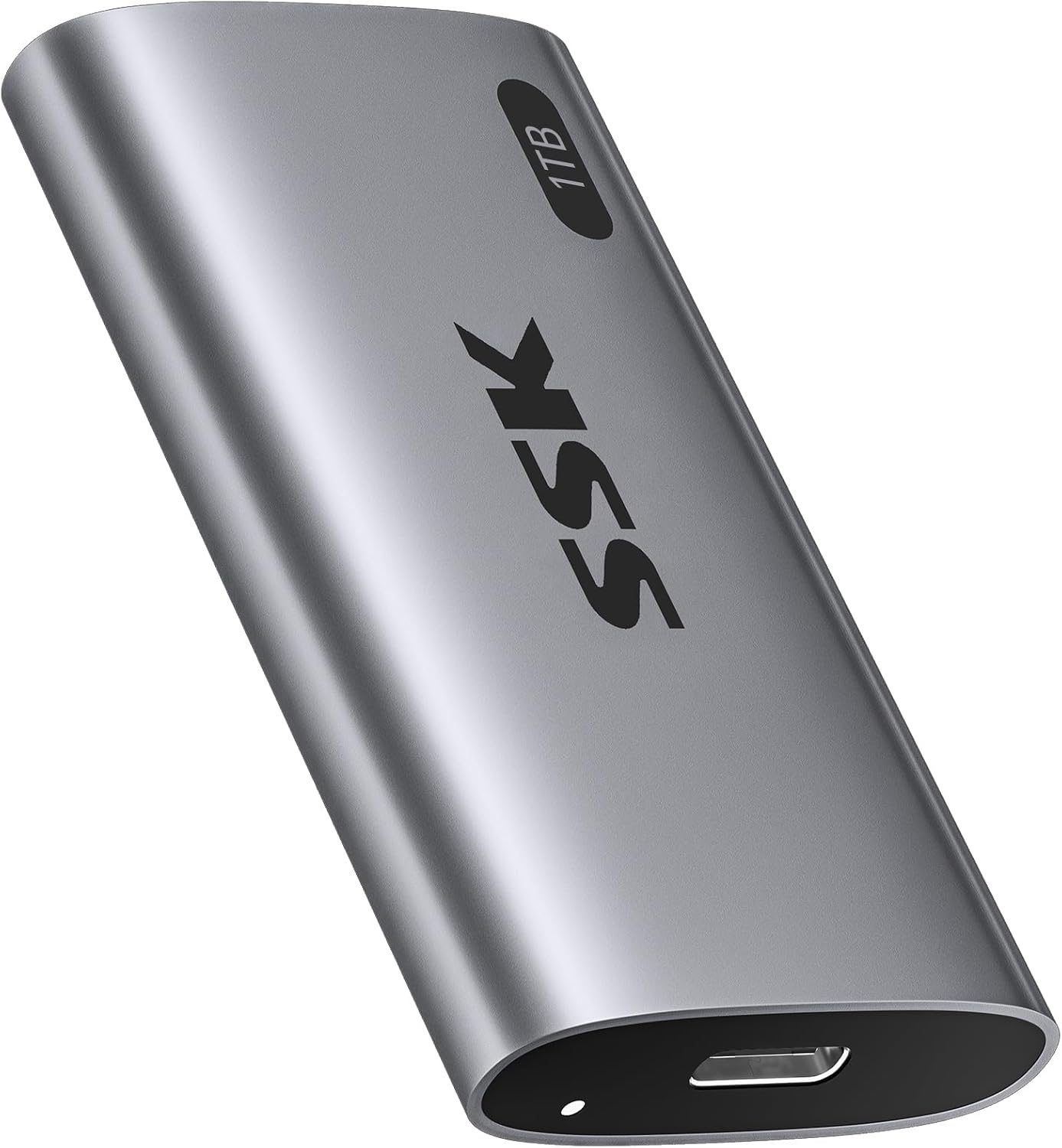

Yeah, definitely buy better USB drives… All 3, same brand, love the h2d without interruption, h2c no bueno after 2 weeks. Weird that the h2d loves my terrible USB drives but the h2c doesn’t…

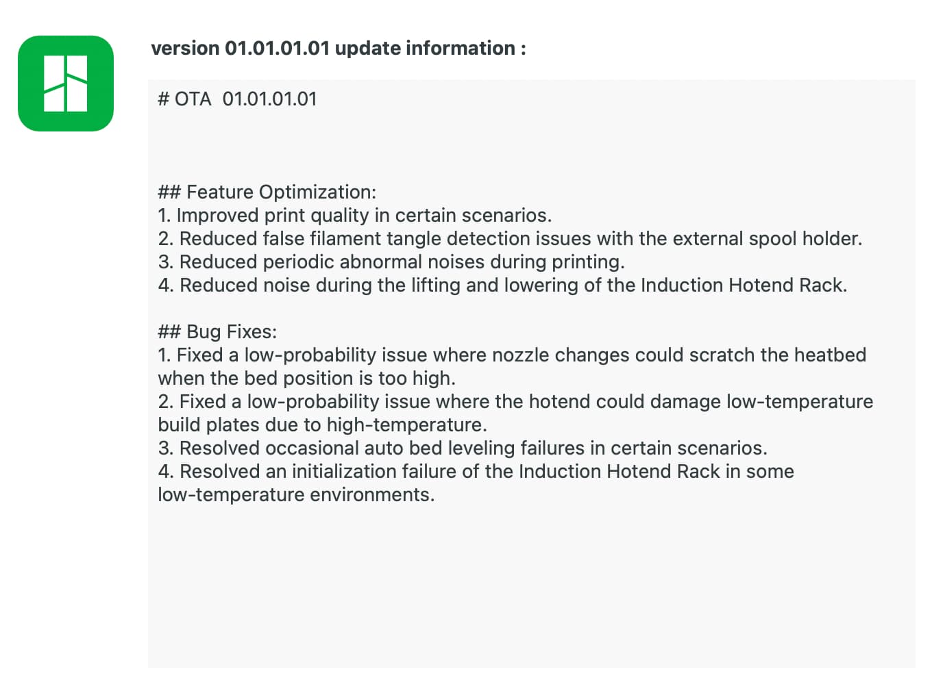

There is a second revision of the beta firmware but the release notes are the same. What was changed or optimized in the version that was released yesterday compared to the first release?

looks like another revision was just released, just got notification and installed 01.01.01.01.
Any chance we could get the release notes BEFORE the update rolls out?
my guess is that they just used this revision to cover the bigger beta tester pool
Would you mind telling me what model of USB flash drive you’re using? We may look into buying one and running some tests. From a design standpoint, there should be no difference between H2C and H2D when it comes to USB flash drive handling.

Is it physically the same USB-drive or did you just use the same type in the H2C?
In other words. Have you tried to swap them around?
3 exact same models of ssk. Ordered one when I bought the h2d at release, reordered another at the h2c release, and then ordered a 3rd when the h2c was having the issue, thinking the one I ordered for the h2c was bad. After the 2nd one didnt fix the problem, I swapped the original from the h2d to the h2c and it also needed to be reformatted after 2 weeks. I had high hopes for the third one I ordered since it lasted 3 weeks before the format versus the normal 2 week-ish timeframe I had been seeing, lol.
SSK - SD450
1TB External SSD, USB-A adapter, USB3.2GEN2 CtoC Cable

It’s possible. It looks like they just removed number 5 on the feature optimization and left everything else alone.
