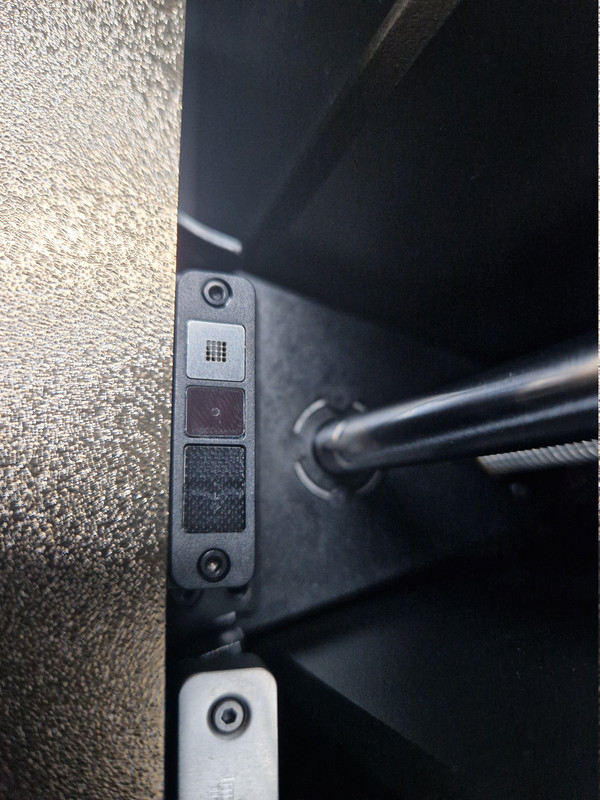

yeah i think the same. could you share a picture how your thermal paper looks like?
H2C
My printer arrived today with the same issue. I clean things anyway but that didnt help. So I looked here wiki.bambulab.com/en/h2c/troubleshooting/hmscode/1A00_1200_0002_0001 and followed Step 3 to remove the sensor. I carefully unplugged the cable, plugged it back in, and then reattached. And now the printer calibration finished succesfully. I assume the cable here wasn’t in all the way … or I somehow just got lucky this last time.

I had the same problem, always the same error 1a00-4007. Even updating the firmware didn’t help. I couldn’t do it so I wiped the thermal sensor on the board with my bare finger and suddenly the calibration went through without any problems.

I also received the “Induction camera position calibration failed” error and the fix (for me) was extremely simple:
  1. Low ambient temperature causes the thermal paper mark to fade too quickly, making the toolhead camera unable to capture the marked point.
I set the chamber temperature to 40C, waited a few minutes, then turned off the internal heater when it was around 37C. I reran the calibration and it passed on the first try.

Same situation for me. Very finnicky setup process, even with chamber heat it failed multiple times. In fact, it failed when it thought the chamber was too hot. I rubbed the thermal paper with a sleeve, heated the chamber, had it fail because it didn’t like the temperature, hit the “retry” button, and it finally worked. It’s very clear when it will work, the dot on the thermal paper fades far too quickly. With the right heat combination, you can see it stick around a lot longer, and the camera is happy with what it sees nearly instantly. If you see it stick around looking at it for any more than about a second or two, the process is guaranteed to fail and you’ll have to try again.

So after multiple tries with different settings. The one that worked was when I set the bed to 40c and the chamber to 40c. Let it stay there for about 2 minutes and then reran the calibration.
