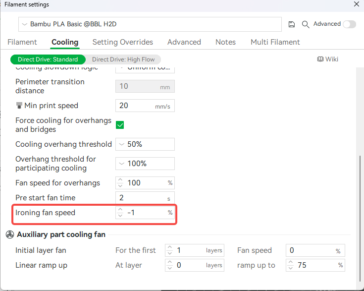

Edit: there is a new feature since bambu studio 2.5.3 that you can set in filament setting but I haven’t tried to play with that yet
Added Ironing Fan Speed Control
The ironing fan speed can now be configured independently. When set to -1, this feature is disabled and the fan speed follows the top surface fan speed; when set to any other value, the specified speed will be used exclusively during the ironing phase. This helps reduce material heat creep at low print speeds, resulting in a smoother ironing surface. Thanks to @Noisyfox for the contribution.

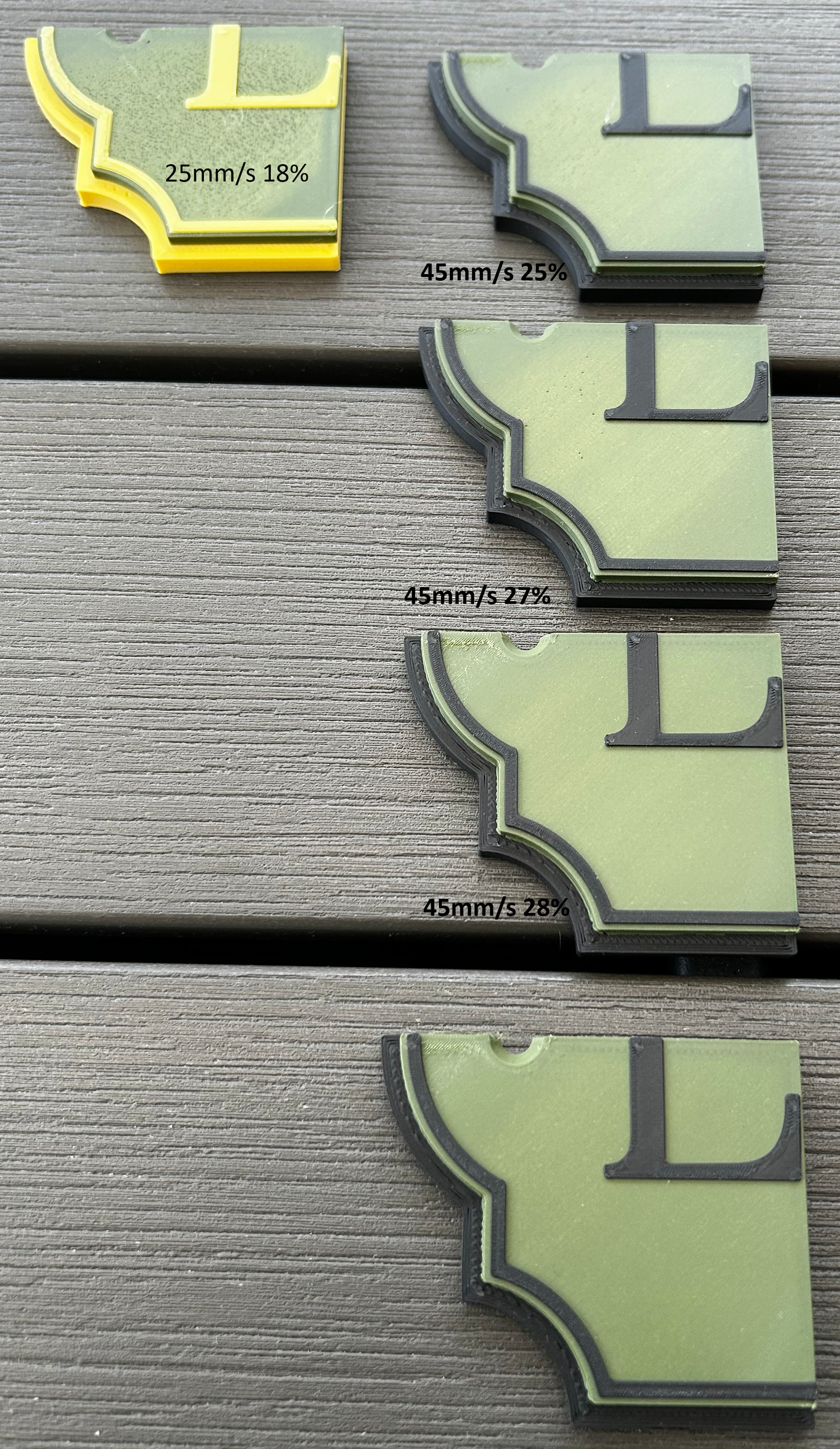

I thought I would post back latest results with Bambu PLA Matte Dark Green - one of the harder Matte colours to iron in my experience.
The below images show small test sections of one of my models, printed with Green on the left nozzle and Black/yellow on the right, each model fragment is around 5cm2. Ironing only applied to the Green background, top black/yellow layer is not ironed just for speed of the test. I’m using Interface Shells to ensure a constant ironing beneath the final top layer. Ironing direction was set to 0 degrees giving a 90 degree difference ot the layer beneath. 10 top shell layers to remove issues associated with infill, I will try to reduce this to 5.
Yellow image shows suggested % and Flow from my first calibration print - 25mm/s @ 18%. As can be seen the surface is terrible. I then ran this calibration print (actually the one I used 2 years ago on my P1S) which has a higher range than the other I had been using. Leading me to look at 45mm/s starting at 25%.
25% looked much better, so i incremented flow rates by 1% and achieved the best surface quality was at 45mm/s with 29% flow (bottom sample).

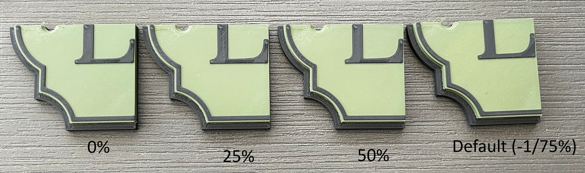

Then considering @philch’s suggestion (thanks again!) I took the 45mm/s at 29% with different fan speeds on the Filament → Cooling → ironing fan speed. 0% fan giving the best result.
So after two weeks of playing with this I’m now quite happy with the ironing performance. The images probably dont show it so well but the “feel test” tells me it’s as smooth as needed for these prints :blush:. My takeaway is that the flow rate here needs to be quite a bit higher than I was using on the P1S and the experience there sent me down a rabbit hole where I didn’t try a fast enough flow rate to start with!
To be expected this quicker ironing speed has also knocked 25% of my print time for the full model! I’m now running a test print on a larger section before trying the full model but i’m hopeful these settings will work out ok. I will then try other matte colours at the same settings with the small portion and where needed run the longer ironing calibration.
