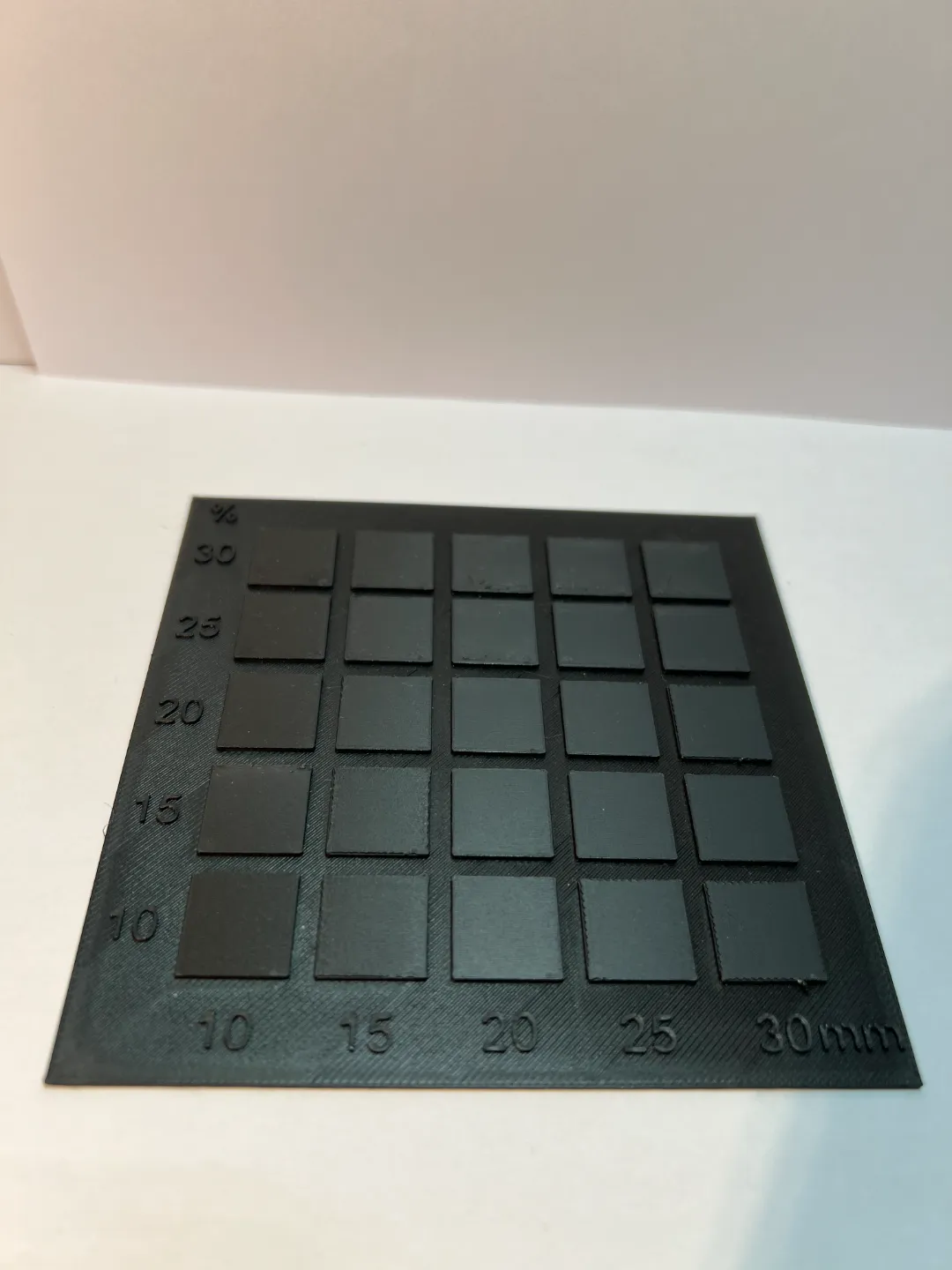

Hey, I have a problem:
I originally used a P1S with a 0.4 mm steel nozzle (non-hardened) and achieved perfect ironing results with a completely smooth surface using Sunlu PLA Matte.
Now I am using an H2C with a hardened 0.4 mm nozzle and also a high-flow nozzle, but no matter which settings I try, I can’t achieve the same surface quality anymore.
Does anyone have recommended parameters for this printer + filament combination?
I recommend doing a specific ironing test to find the best settings for your nozzle and filament. If you simply adopt other settings, they may not work for you. This also means that you have to perform this test for each type of filament.
Make sure you use the original creator’s print profile. Once you have completed this test, you can try more specific optimisations. This test provides the most important basis for ironing. :+1:

Testing has been the only thing that has ever helped me with ironing. That test Retro linked is good and sorts it out. Use the same roll of filament and as much of the same process settings as possible
That’s a good tip: I had to do this separately for each type of filament, as there are big differences: PLA, PLA Matte, PLA Silk… and of course separately for each manufacturer. :+1:
