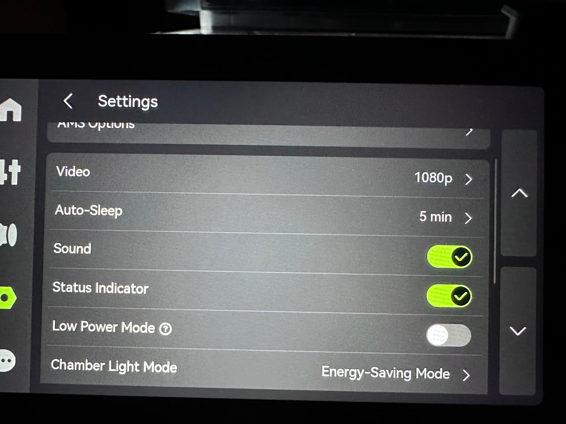

H2C Long Beep Before Printing
Are there any plans to turn OFF the long BEEP before printing ?
I sent the start print command so I know the printer is going to be moving.
The Sound OFF in the settings menu does not change the Pre-Print Long Beep.
At night time it is very loud and very long and very annoying.

Are you connected to a UPS? I experienced this too, and it turned out that my H2C was drawing almost 1500W when heating the bed and chamber at once. That overloaded my 1000W UPS, which started screaming. I enabled ā€œlow power modeā€ to stop this from happening - it heats slower, but it won’t kill my circuits haha.

THATS EXACTLY WHAT IT IS!!! It’s so loud that I just figured it was coming from my printer. I have it connected to an APC 1500. Thank you so much for that info. I feel so dumb not paying attention to it, but it sits below my printer so it’s hard to tell where its coming form.
I confirm this is coming from the APC during warmup of the build plate. My X1C for a short while exceeds current absorption rate so the APC beeps
