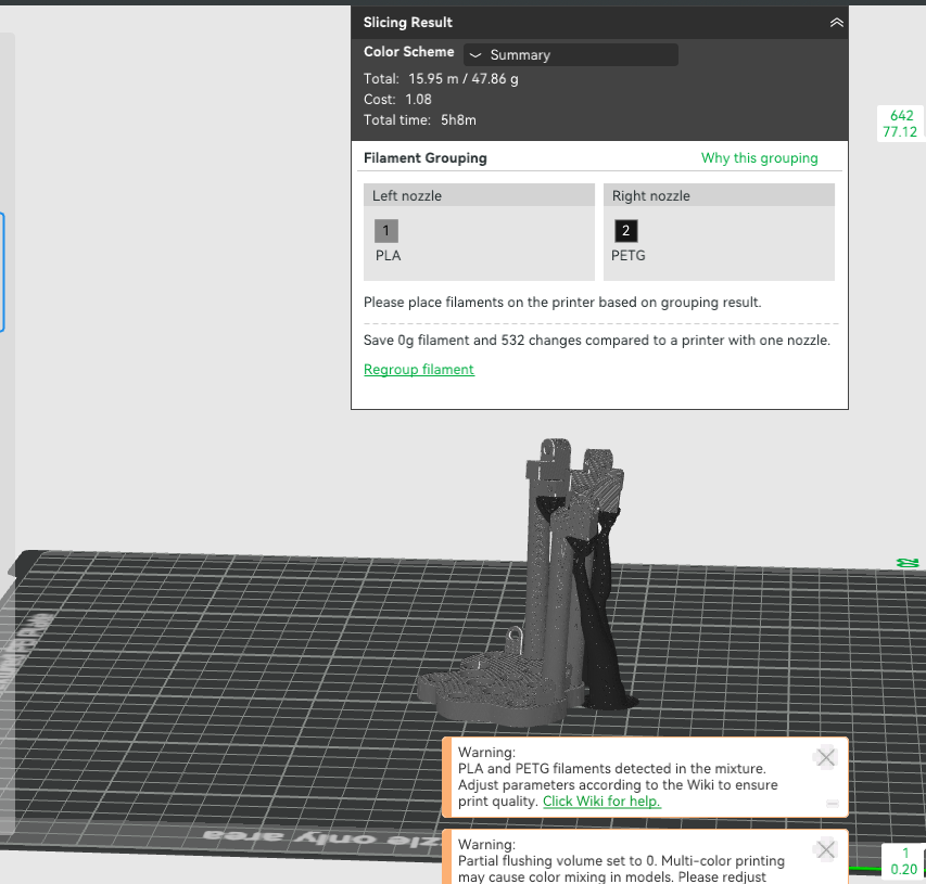

I am trying to use the vortek nozzle to use petg as a support filament for the left standard nozzle printing the actual piece in PLA.
in the bambu studio i have set the support to use the filament in the vortek head as shown here:
but my question becomes:
  1. when i select “enable prime tower” and set purge mode to purge saving, not only does it almost 2x my print time, but it 2x my filament usage.
  1. if i select no prime tower and set the purge mode to “purge saving”
    I notice the time drops by 3.5hrs and the filament used also drops considerably.
    with this method however, the printer does a lot of flushing so there is a lot of poop out of the back and time used for this. i woudl assume this is still faster and uses less than the prime tower as thats what the slicer is saying???
Is there a setting that i am missing? shoudlnt using the prime tower(instead of a flush) for a print like this:
a. use less filament then flushing
b. speed up the print process?
thanks in advance!

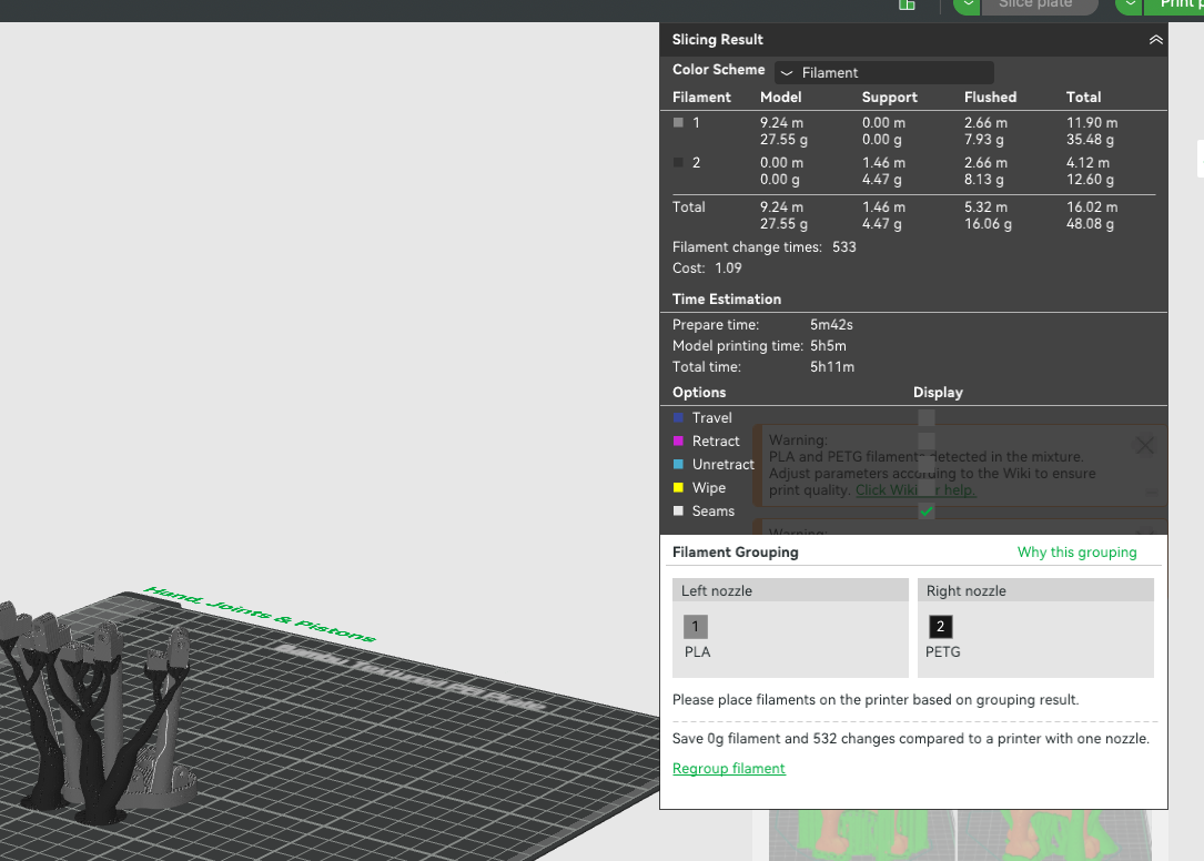

I do not know if it works, but maybe you can try to only use PETG as interface for the support. With this setting the support will be printed from PLA but only the upper layer of the support will be PETG. (First box: standard; Second box: PETG)
With this setting you should have a lot less poop without the prime tower. A lot less print time.
A much lighter prime tower if it is enabled. (Which should be recommended, else you may have bad print quality or may even weaken the print) With only interface and prime tower enabled it will bee mostly hollow.
But this will only work in case both filaments do stick to each other in both directions in a good way. (I have never tried PLA + PETG, but I am doing the same with PPA and PC).
I agree with only using PETG for the Support/raft interface and leave the Support/raft base as default. Default will use the PLA for the supports. The interface is the only part of the support that touches the model.

this is what it would look like if i did the raft interface as petg and left base as default
