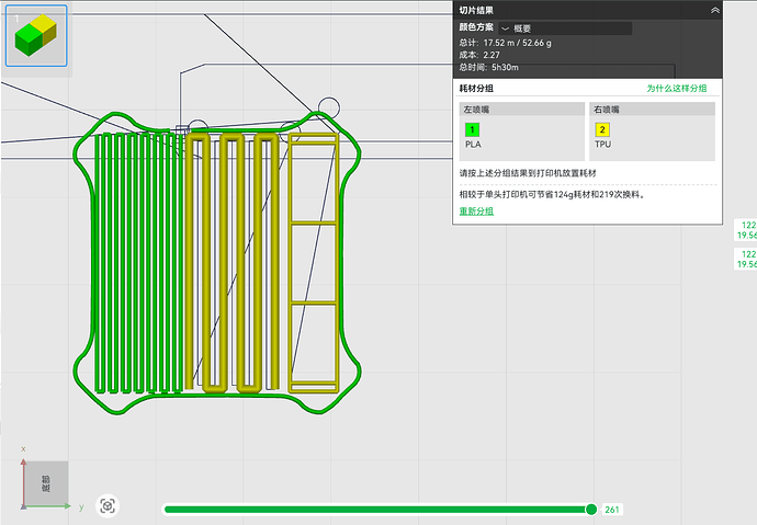

The blue travel lines between the yellow TPU lines, that’s a move to remove the stray filament.

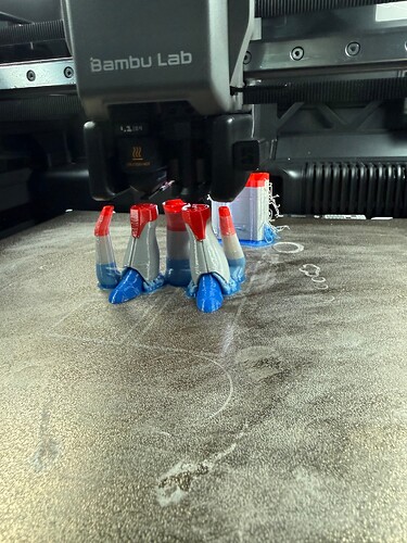

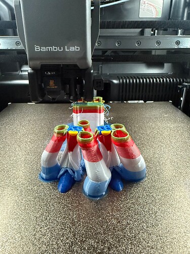

I always print with PETG first time I tried multicolour print

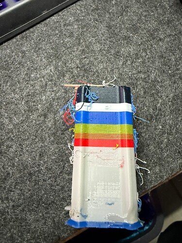

after 5 hours the tower de attached from the bed , then I tried to stick it with hot glue it continued but eventually stopped it .
SECOND TRY
Added more tree support and large brim on the tower it seems better than before
Support Tower Mess.3mf (7.4 MB)
I am using all nozles , LEFT and all 4(AMS) From the RIGHT Vortex ,
i believe that the problem seems to happen when the LEFT nozzle enters the game by extruding in the tower , this is starting to making it harse and the tower becomes weak and colappse when violently the right extruder clear nozzle against the string mess , i hope it make sense , to make a quick and dirty solution is to add more brim into the tower
Filament profile issue. Use Bambulab PETG profile instead. Must be some retraction difference between generic and bambu filaments. But I’m using all bambu profiles so I’m having no issues at all now.
That’s a filament drying issue IMO. The long scrawny noodles of filament that get stuck to the prime tower are what’s oozing out of the nozzle on its own during the filament swap. Moisture is what causes that oozing.

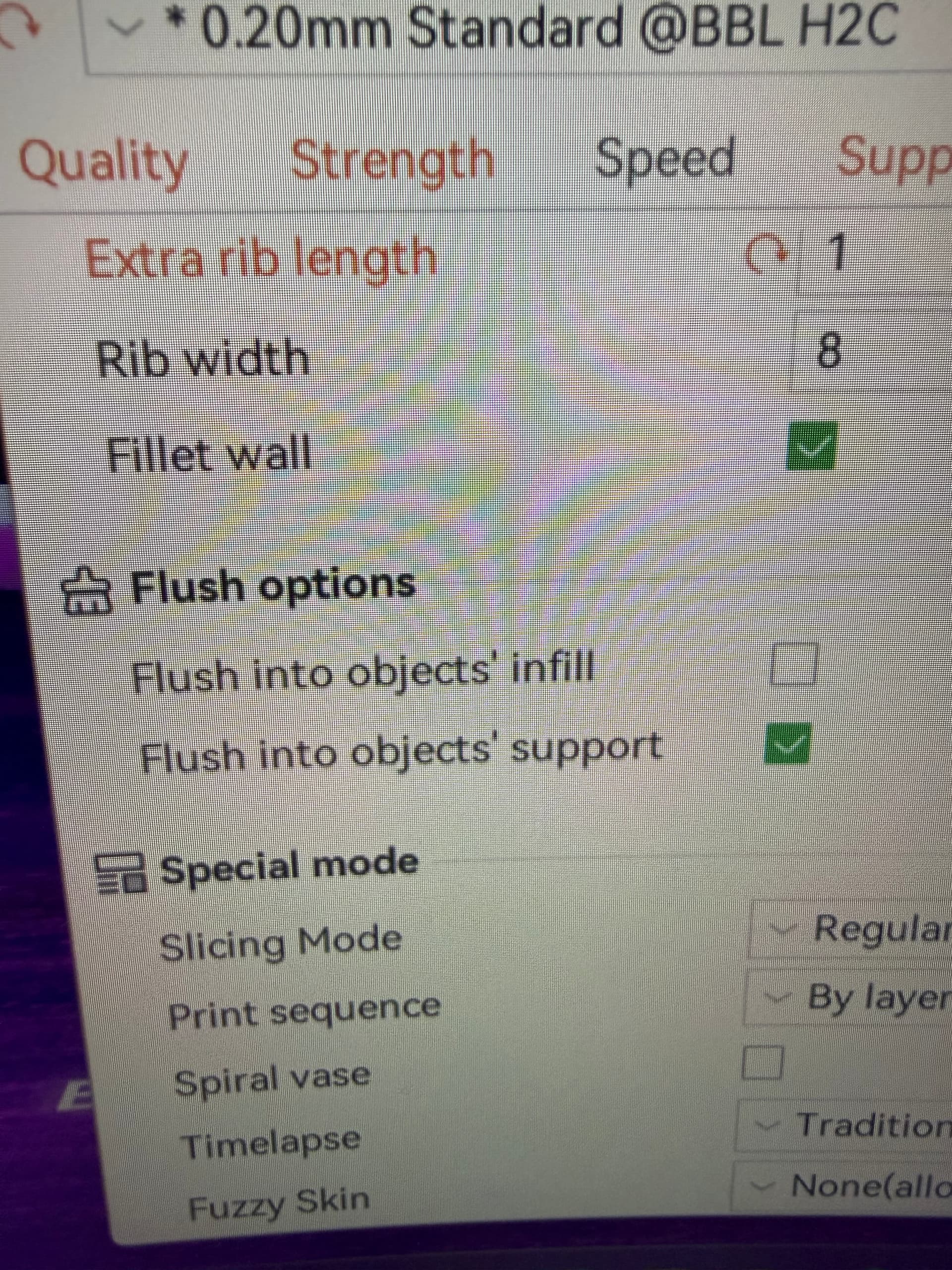

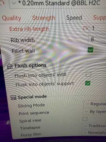

Couple things to do in the slicer that will help keep the supports or prime tower from getting knocked over. EDIT: OK, Couple two, tree
First go into others and uncheck the Reduce infill retraction, its at the bottom. This will set it so the bed drops a bit when the head moves from structure to support. It is on by default to reduce how much the bed (Z Axis) moves during the print to reduce slicer and print times. I found the time difference basically unnoticeable.
Second, under the filament settings are options to wipe while retracting and wipe distance. It is disabled by default, but it you have certain filaments that you need nozzle tip cleaning, you can check the box and save it as a special profile. Just remember to switch to that profile after a sync is done because its through Slicer not the printer.
Third, to help keep the prime tower planted, you can increase the number of brims to hold it down, Default is 3, I use 5, have not had a tower fall over since.
