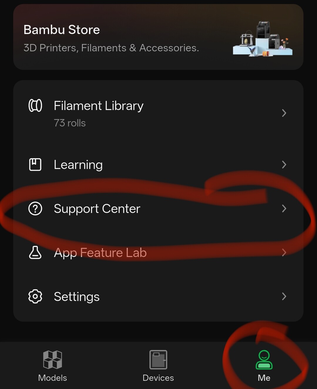

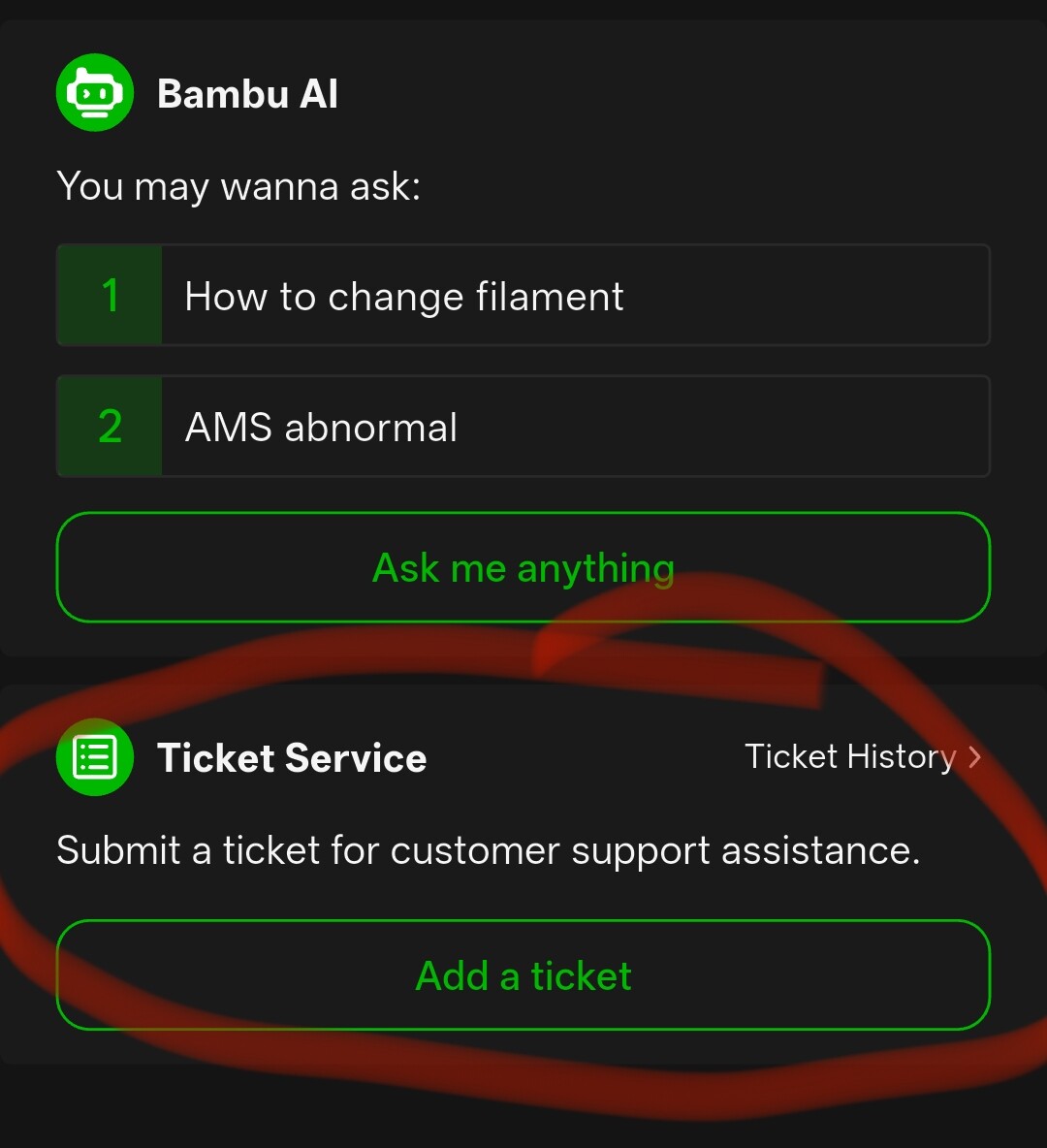

I have the same problem. It happened to me today, too.I was preparing for a print and then the screen wouldn’t turn on anymore, and it won’t connect online. It’s like the printer just died. How do you submit a ticket. What no phone contacts? This sounds like a Tech company expecting basic users to operate like they do.
You can submit a ticket through the Bambu Handy app.
Go here https://bambulab.com/en/my/support/tickets click on +new ticket and away you go
