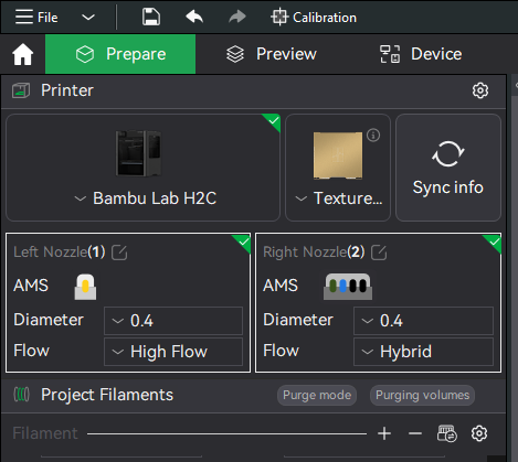

Yep, high flow and regular can be mixed among the induction nozzles (and also left/right in general). It’s potentially a bit more setup in the slicer (eg. there are now 3 places to edit speed settings – left, right regular, & right HF), and making sure the mapping to the printer makes sense in the end. But doable!

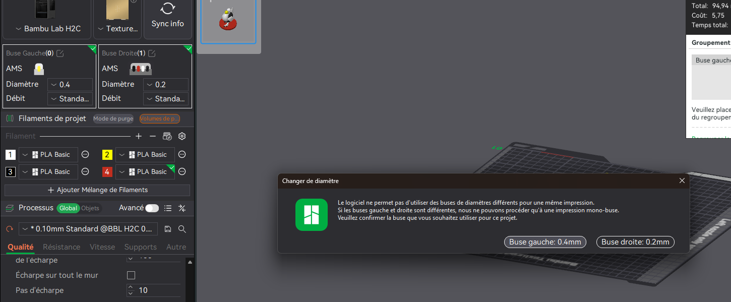

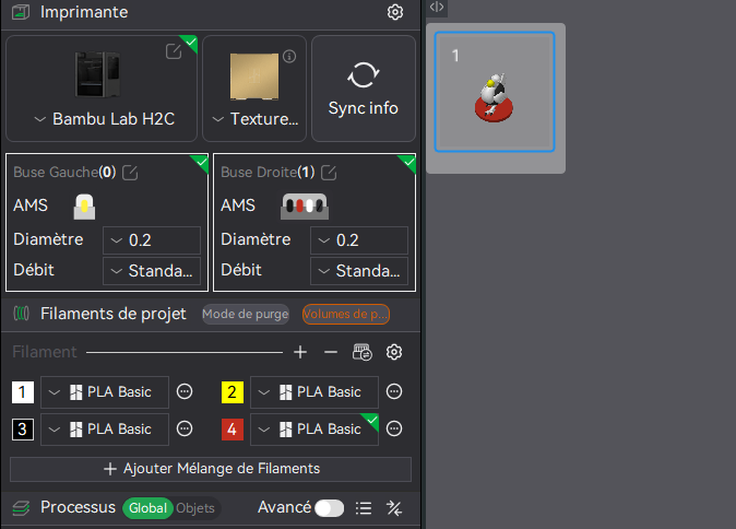

I tested a lithophane, so I set the project up for a 0.2mm nozzle. The problem is that now, whenever I select that configuration, it stays stuck on it for all my projects; unless I manually change it before slicing and lock the setting, it remains fixed on the 0.2mm nozzle! Is there a way to switch back to the 0.4mm one?
Thanks.
en faite, même le lithophane là fait en 0.4, avec la config de 0.2!! couche de 0.1, 0.15!! et tout fut clean

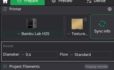

In the prepare screen, hit Sync Info, it lets you select which nozzle size you want to use for that project.
I’m confused by this new question, can’t you just select the nozzle size in the slicer, at top left?

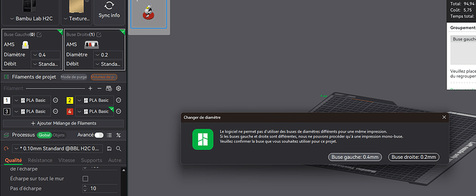

i have this

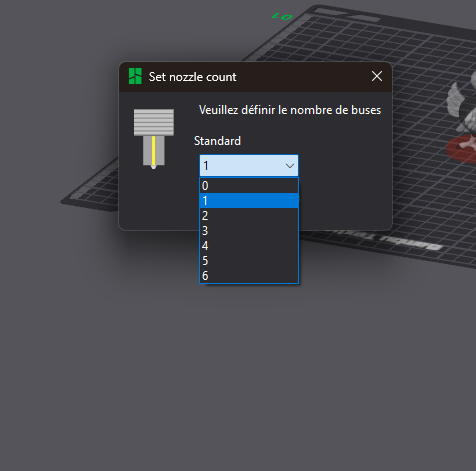

when i select h2c now, block on 0.2 but i have just one 0.2 nozzle,
so, i do this
first time restaure on 0.4, now stay on 0.2??
so
manual change and ask me but give this
0 nozzle in left and 1 in right!!
but i have 1 in left and 4 in right
and after reconfig all and get slice!
ask me to synchonize and if
erase all 0.4
in start is good just when i download lithophane from makerlab!!
only by web, block from bambustudio!
try on 0.2 and now block

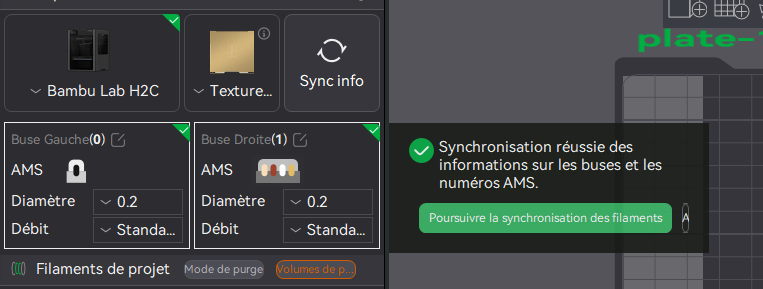

Which nozzles are actually mounted in the printer?
Basically you either sync with the printer and select one of the mounted sizes, or you configure the nozzles manually (size, flow, and count, per side) and don’t synchronize (eg. working on a project for future use, not based on what the printer currently has loaded).
If the printer doesn’t have matching nozzle sizes on both sides then only one side can be used for a print/slice. The slicer insists on both nozzle sizes being the same within a project, even if the printer isn’t configured that way (manually or via sync).
It is annoying that the slicer prompts to synchronize with the printer for every slice (I always say “no” and sync manually if I need to). (I actually have a fix for that submitted but it has been pending for months.)

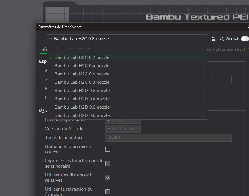

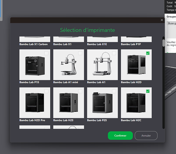

when i open new project,
if is already with H2C
on printer “onglet”!
give me this
change if project be saving on 0.4, show me.
so, i get on config of and have this
restart all time on first config of but!!
before;
i havn’t this, not show me this.
just H2C, H2D, not 0.2 or 0.4

That’s normal, just the way the printers settings are edited, per nozzle size.

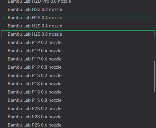

You’re sure about that? I’ve never seen it show just the printer w/out a nozzle size in that list. In my screenshot, I’ve not actually used any of those printers at all (I only have customized H2C settings).
I don’t like it either because most settings apply to all nozzle sizes. I often end up managing my custom profiles manually because I can have less duplication that way. But that’s a different topic, definitely deserving its own thread.

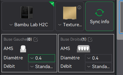

when i sync in start, ask me and i tell it 0.4, and block on!!
now when i sync, eras all as i have just one 0.2 noozle. as it but i need each time manually tell it
i have 4 nozzle 0.4 on right and 1 on left!!
same i tell it
h2c 0.4 in his config
and same new software update, not change!
