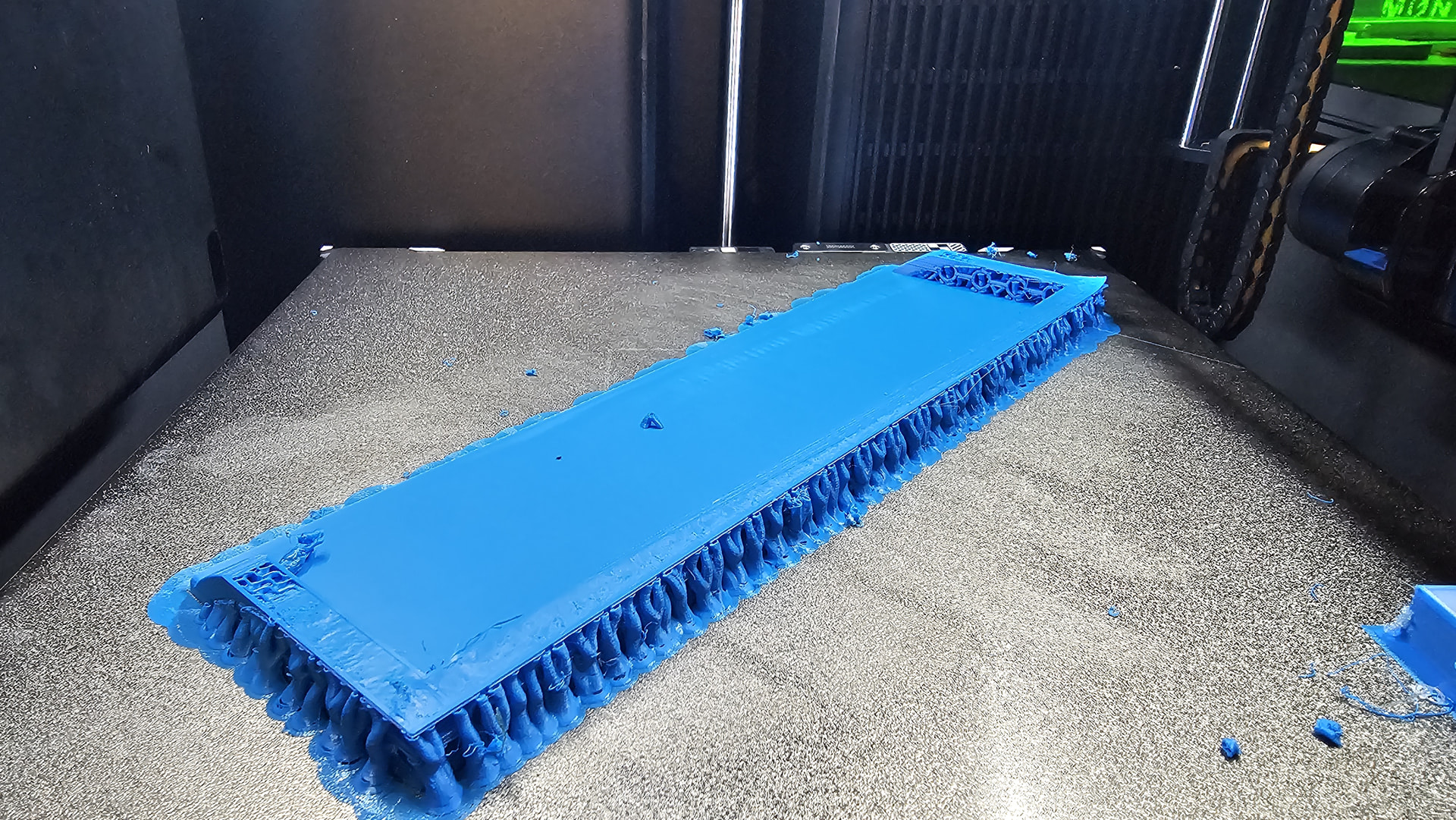

H2C Nozzle scaping in EVERY print
I am going insane.
I have not made more than a couple of good prints with my brand new H2C.
I am a noob but have been diving into things as much as I comprehend at my current state.
I am printing with PETG.
Almost all prints fail, and I cant figure out why.

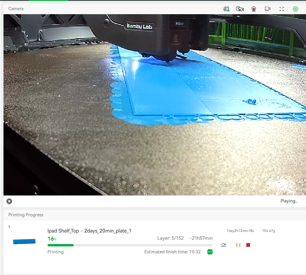

Initial layers always have some issues. Sometimes I get several hours in before issues - sometimes it is the initial layers. They all fail:
Looks good but there are already some errors.

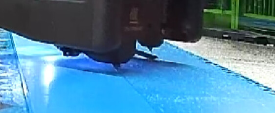

Next layer - heavy nozzle scraping - print WILL fail again.
This seems to always happen and I cannot get 1 print to work since I started trying finer prints with 0,2 nozzle.
What I’ve done:
Flow has been calibrated to 1.06.
PEI temperature has been tried with 70, 75 and 80 degrees - this one is 80 and still failing, butthis time there doenst seem to be warping - had warping on 70 and 75 - but I did not use glue. This one 80 degrees and glue - no warping.
I am printing at Nozzle temperature 230 degrees - Initial 245. Calibration found no stringing at 230 but stringing at higher temps.
I have calibrated the machine several times.
I have tightened the screws behind the nozzle holder which has helped a lot - but now prints just fail later instead of sooner.
And yes - I dried my filament. It is 18% at the moment.
I ALWAYS get nozzle scaping at some point and it leads to every single print being ruined and 95% of them can’t be finished. The other 5% has such bad scraping they are just too fugly.
Can anyone tell me what settings I am missing or screwing up? The printer is useless at 0.2 nozzle - but most of my 0.4 also fail, though a few can actually be used.
Does anyone know why this is?

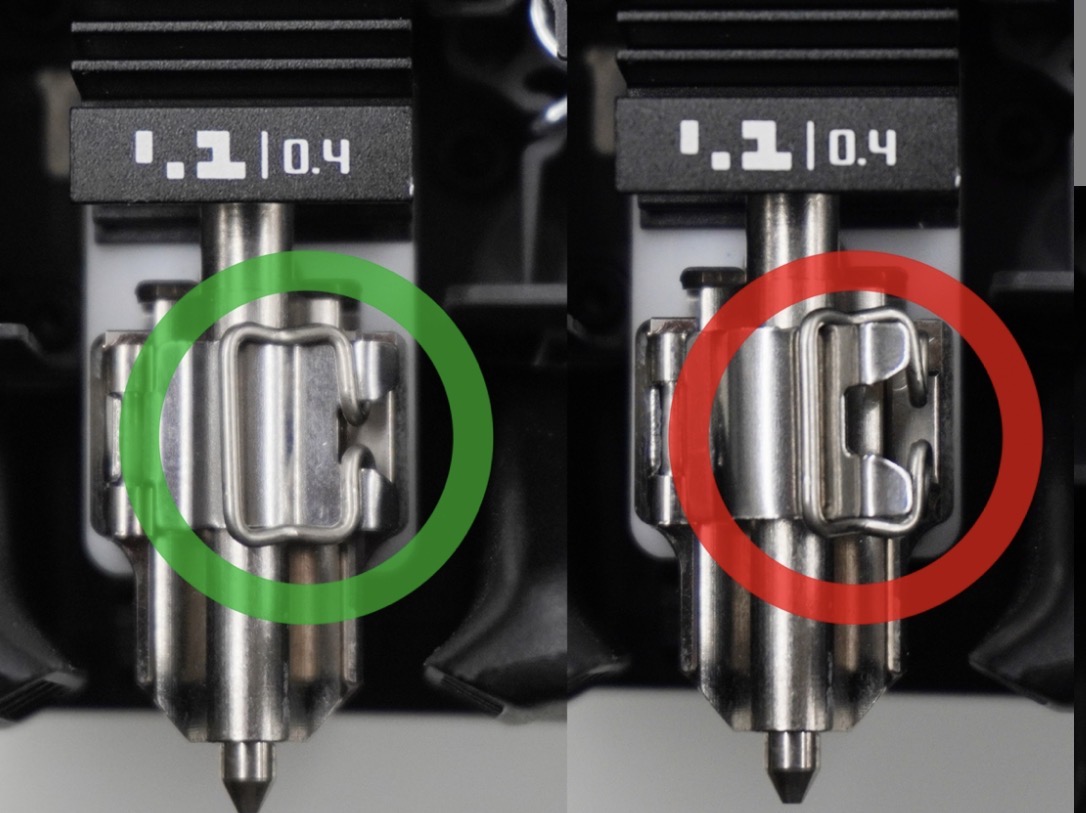

I’d check your left nozzle latch first thing. It’s got a terrible design that’s easy to latch incorrectly which can cause scraping. Pic attached showing the correct way. I doubt it’s the problem because normally the scraping will be much more pronounced, but it’s worth checking and just takes a second.
Any chance it’s the flow blocker bracket doing the scraping? Hard to tell from the picture, but it does look a bit low to me.

No. I’ve been looking at it as it scrapes. It is the nozzle. Problem is bambulab does not have a Z-offset so I cant experiment with that. It can only auto Z-calibrate.. I don’t know what I am doing wrong for this to happen on every print.

I agree that your nozzle is doing the scraping, but that’s a symptom of a bigger problem - we need to get to the root cause.
The flow blocker is obviously bent and not blocking ooze from the inactive nozzle - it would be a problem for both extruder sides. If the nozzles are allowed to ooze freely, it will drop blobs of material that can be caught and torn up on the current print.
There’s a bigger potential problem on the NEXT print’s nozzle offset calibration though - if nozzles are oozing and it just doesn’t want to come off during the offset calibration phase then that calibration will be off and the entire next print will be compromised.

IMO if its a software/slice problem, this right here looks like too much flowrate, piling and pushing into the final corner of a long flat area.
Additionally on a 0.2mm nozzle, textured PEI can be unreliable, smooth or satin may be of help.
I agree, the flow blocker looks bent, even if it is not touching the part.

I think the key items (flow blocker in need of replacement, flow appears too high) have been mentioned a few times already. Although your nozzle temp appears rather low. With PETG Basic on the H2C, I start at 245°C (first layer only) but occasionally go all the way up to 260-265°C.

As for the troubles with the 0.4mm, a bent flow blocker can cause a lot of havoc.

Thanks for the tip about the Flow Blocker. I had not noticed this was a problem, as the printer was delivered that way. Thought it was correct out of factory.
I have adjusted the flowblocker to sit right at the nozzletip. I had around 5mm of air between the blocker and the nozzle. Let’s see if that removes some blobs.

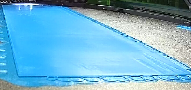

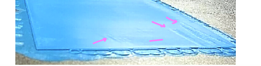

The print actually finished. I did not expect that.
It stopped with “Extrusion Overloaded” many, many times but after cleaning the nozzle and restarting a multitude of times, it actually finished.

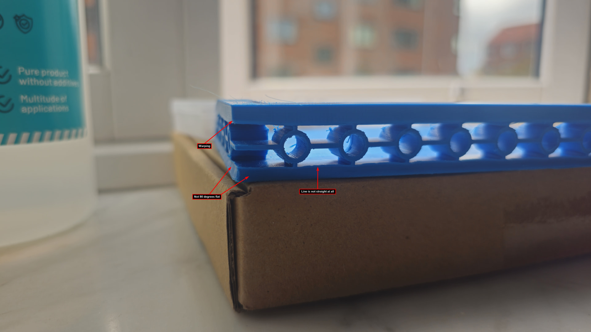

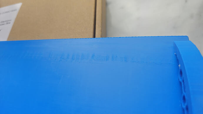

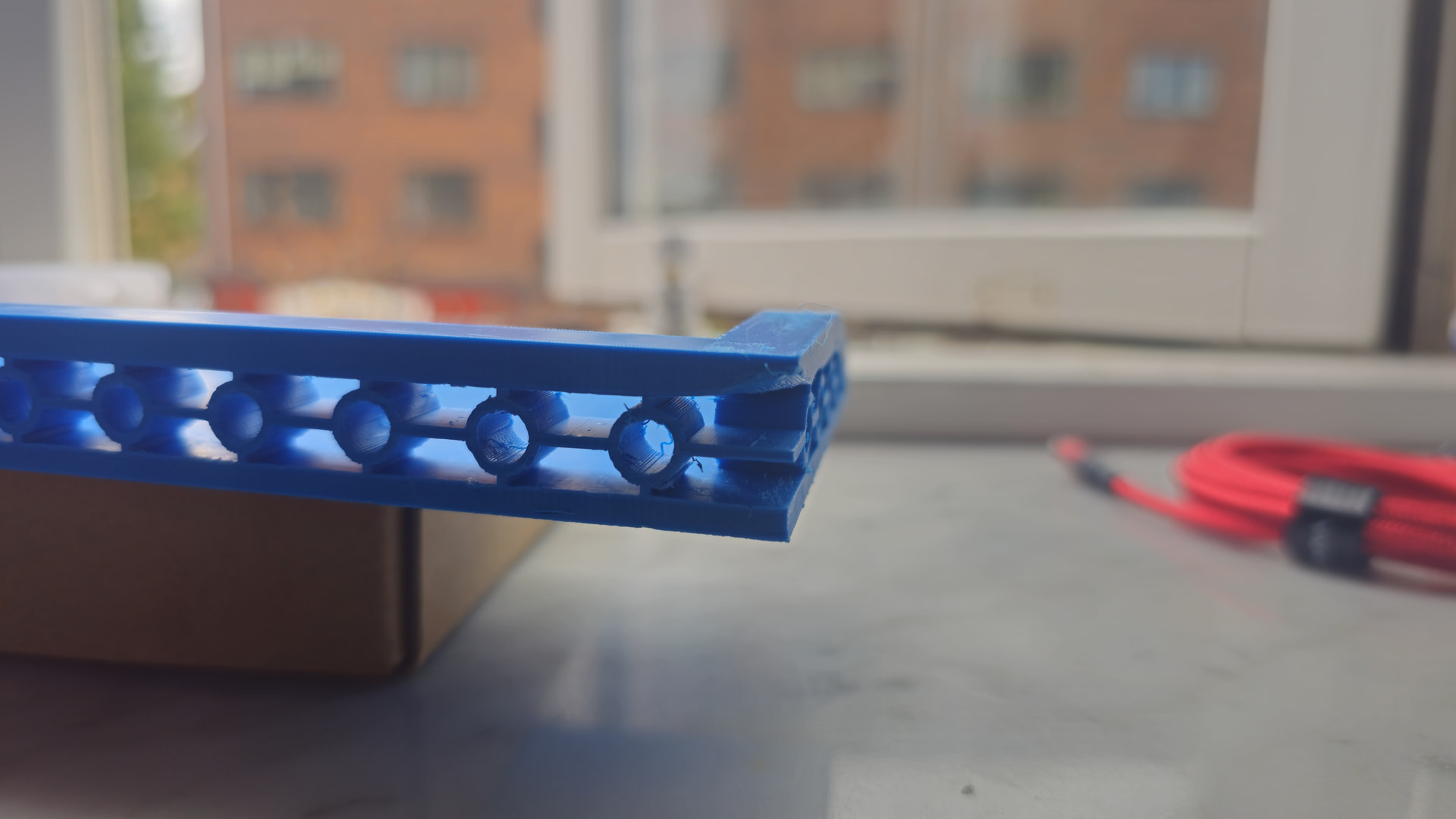

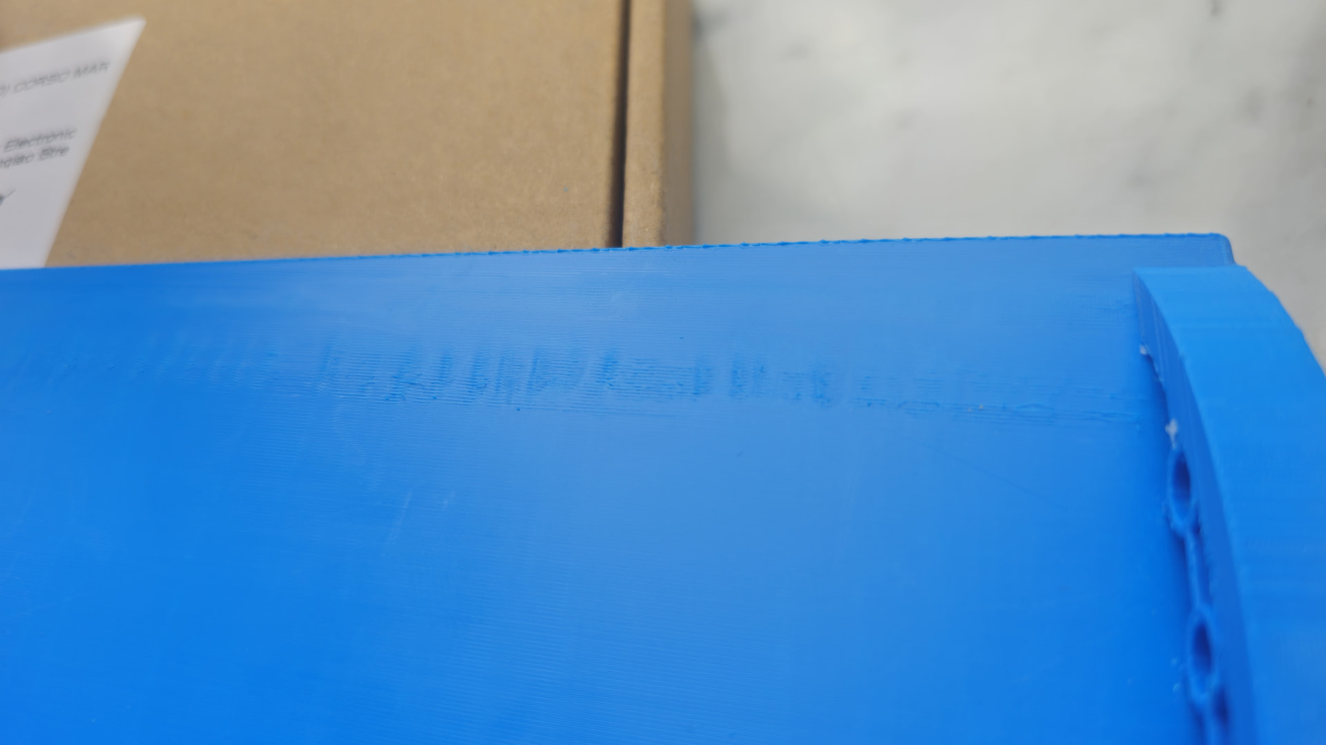

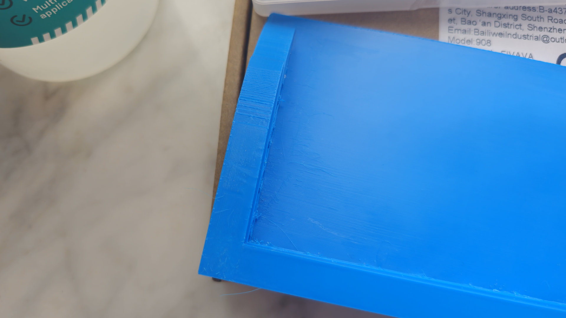

However. The print isn’t up to snuff.
Lots of debris in the chamber.
Warping several places…
Scraped surface…
Ugly final layer finish..
Lots of warping…
This is a project for a iPad holder that I need to be spotless for my specific project. I have cut most of the tablet area off, just to test print the raiser and the pattern in between.
Question now is how I can improve the print quality so it prints smoothly with no errors and restarts - and also with a much cleaner finish without warping and flawed details?
How do I get these final issues resolved. This is the first time it finished this specific print.
I wonder if cranking the bed leveling screws right down when cool is resulting in the bed being more likely to deflect when it’s heated.
You need to do this process to ensure the bed is at a good “neutral” position.
After that, you should re-run the bed leveling calibration from the printer settings menu.
Also, now that I see what you’re printing, there is absolutely no reason to use a 0.2mm nozzle on this part. You’re forcing yourself into unnecessarily thin layers and increasing the likelihood of failures - and wasting a whole lot of print time in the process
There’s also some part design issues that are likely contributing to your warping.
