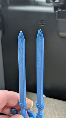

I’m printing a mini Zelda sword, about 185mm tall. It’s fairly thin and tall, which I know could be an issue. I’m having issues. The tip of the sword will melt into a ball. Sometimes the small hilt parts get knocked off, or the handle and supports get knocked down, and have to cancel the print. I have ran the full printer calibration and used the vision encoder plate a few times. Whole the H2C has issues, my P1S with hundreds of hours prints it flawlessly as shown in the photo. Left is from my P1S with a 0.4 nozzle, same filament (printed flawlessly) and right is H2C (glob at the top). I’m using the same roll on each printer.
Using the H2C with 0.4 left nozzle and Bambu matte PLA, that was dried. Both printers are using the latest official firmware and slicer (2.5.0.66). I load the STL, added auto tree supports and hit print. After 15 attempts on the H2C, it will not print correctly, even once. Seems like the nozzle is dragging around in the filament and balls it up on the tip on the H2C. Not sure what is causing this. To troubleshoot I’ve tried slowing down various settings, putting the H2C in silent mode, leaving the door open, increasing fan speed, increasing print speed.

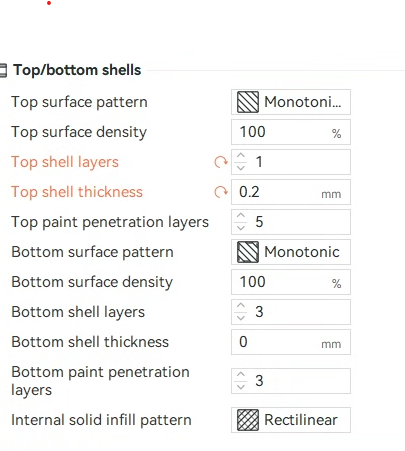

  2. Other settings screenshot: Global > Strength > Top/bottom shell layers. Changed these settings to what I am showing in the other screenshot, not sure if that helped or is not necessary, but was attempting to thin my top surface, thinking that was where my problem was at.

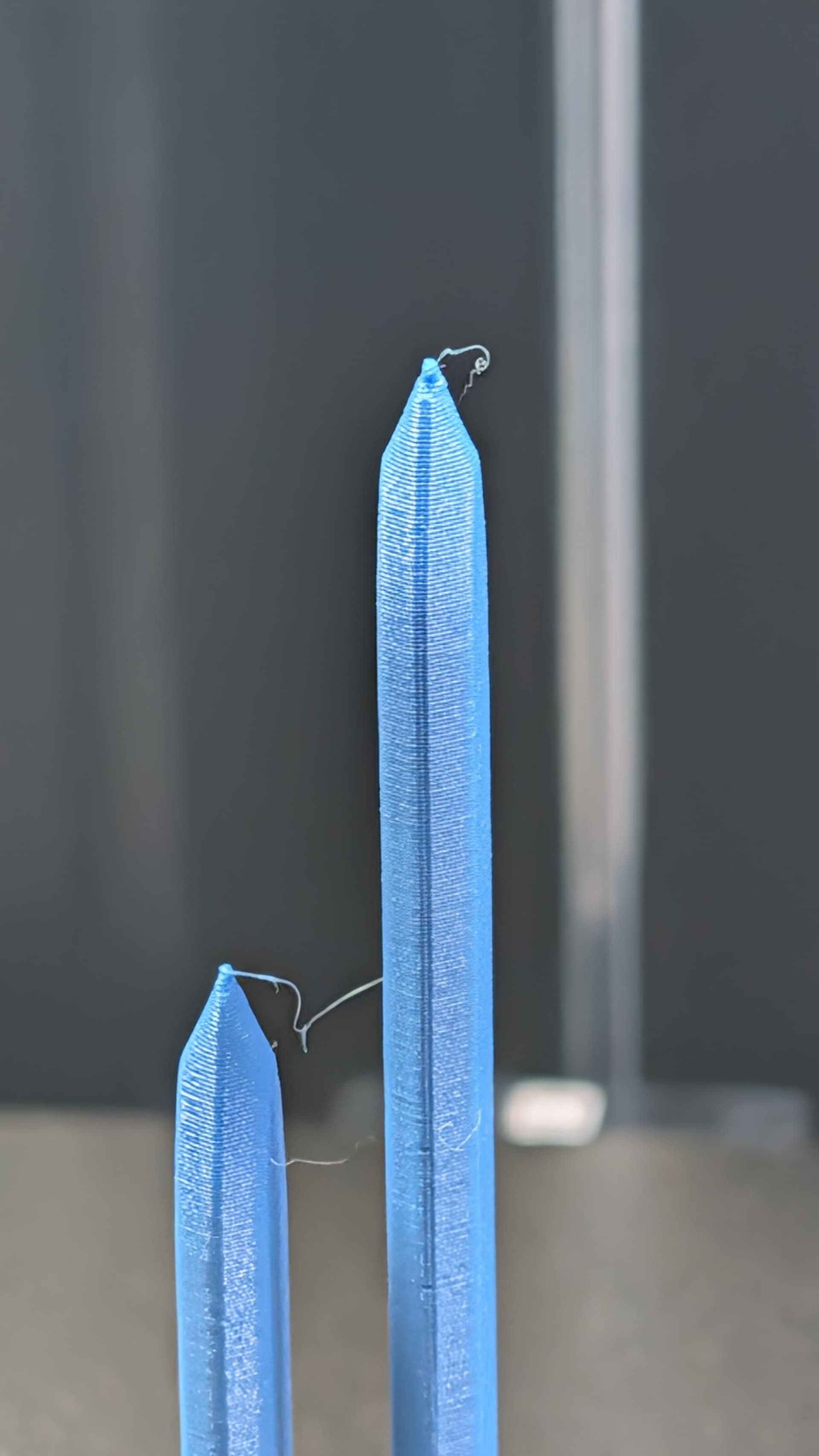

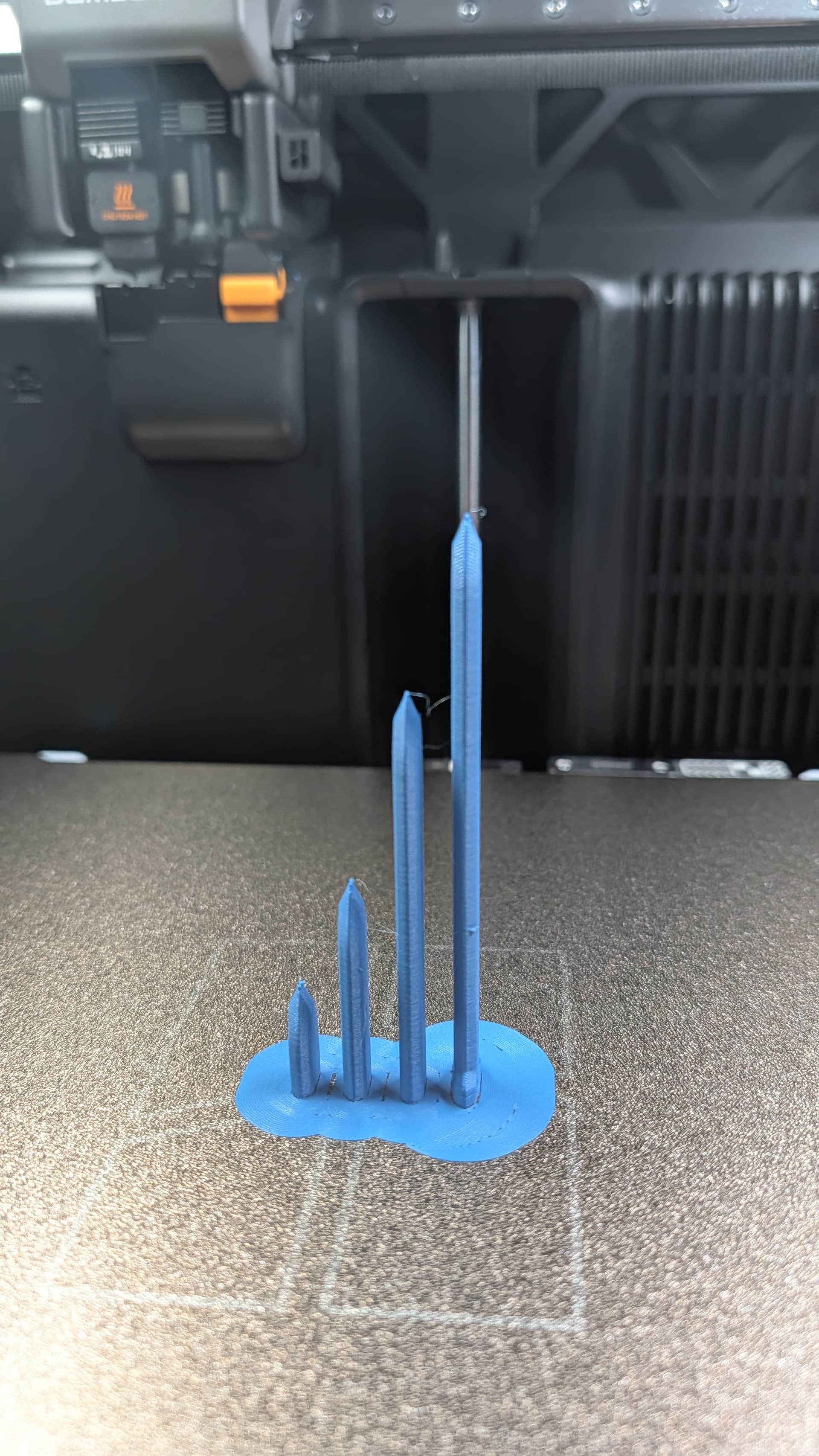

  3. In an effort to make the tip as lightweight as possible, to avoid heat soaking it from a spinning nozzle and solid infill, I added a modifier cube to the tip, and was able to eliminate the gyroid infill completely, so all it does now for these last 50 layers is built 2 walls for the tip, nothing internal at all. The results were my attached samples, the blue sword tips.
Once these settings were applied to the tip, the top surface of the hand guard/hilt was too thin and was showing holes. To fix that issue I applied another modifier cube and assigned it some wall settings to just infill each side of the hilt and now it makes a solid surface a few layers deep, instead of a thin top surface that looked like swiss cheese.
After all these settings were changed, my small sample blades printed on the H2C without issue. I then printed the full sword with default tree supports and changed nothing else (no fan, filament, door still closed, etc), everthing else in my previous test and final results were the same with Bambu PLA. I then used Bambi PLA Silk+, did not change anything else besides the filament in the slicer, and that worked awesome as well. During and after my testing I had not altered the PLA settings for either printer, just used the default settings Bambu has in the slicer. On both before/after tests on either printer the door was closed, as leaving the door open and testing did not give any better/worse results.
