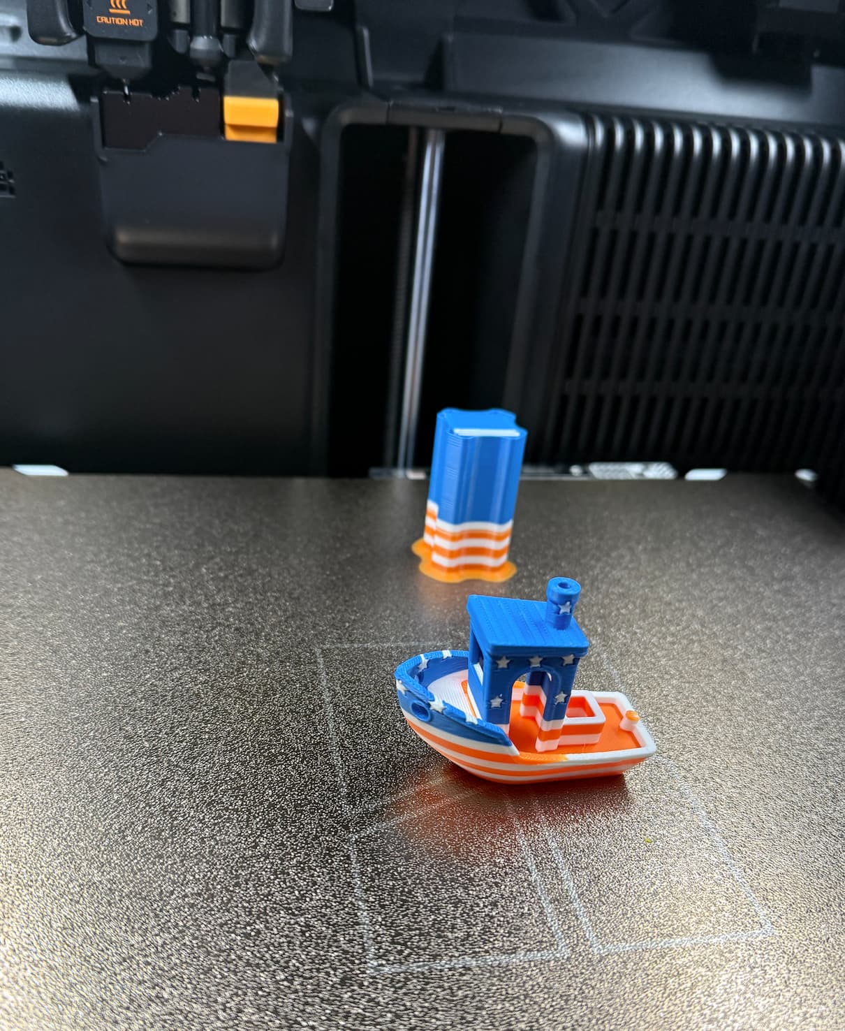

Ok let me start with a simple one. On the p1s i new there was a speed setting including “ludicrous”. I never used it but i wanted to see how wobbly the h2c would be on my table so i made a benchy with it and while watching that wondered why doesn’t it do things like purge tower and supports always at that speed and only slows down for the models. We don’t care how these look right? A good example of a question i a have and probably has a easy answer. And the benchy was fine here it is in for you americans in special 3 colors. Well one is orange since i am dutch and didn’t have any red.

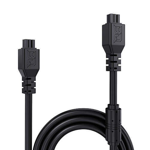

Are these ams<>ams cables available in different length and maybe also from a 3th party ?
There are certain filaments only the left nozzle can run. The more hardcore exotic stuff. I imagine the induction ones have trouble with super abrasive stuff. Read pps-cf, the nozzle guide shows you.
Yes, the connector is standardized Molex Micro-Fit 3.0. You can buy them in different lengths from pretty much anywhere.
https://www.molex.com/content/dam/molex/molex-dot-com/en_us/pdf/product-reference-guides/987652-3661.pdf?inline
What you need is 6-pin lockable 3.0mm pitch.
Or just buy already made cables (for example):
https://www.digikey.com/en/products/detail/molex/2451320620/6565378
ahh ok make sense in that way they knew the left one could do more and was in use for a long time without issues maybe once the induction method is proven they will switch to that. tnx.

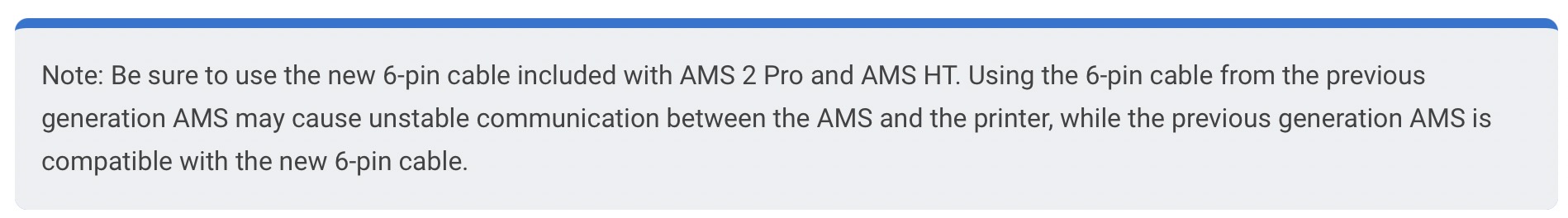

I would be careful about using the aftermarket cables. The BIQU cable was released before the AMS 2 was on the market, so I doubt their claim that it is fully compatible with both versions. The new AMS 2 uses a different more robust cable as it also sends the power for drying through it, Bambu specifically says not to use the older cables with the new AMS 2. I tried my older 1.5m bambu cable with AMS 2, its functional but it might cause problems in the long run.
Can we assume that this is partly because of the power use for drying and would be less of a issue if we add a external power block to each ams2 that was already told to me was a good idea anyway ? And if we stay with bambu cables we have i see only 2 options 50cm and 150cm. well could be worse i guess.
