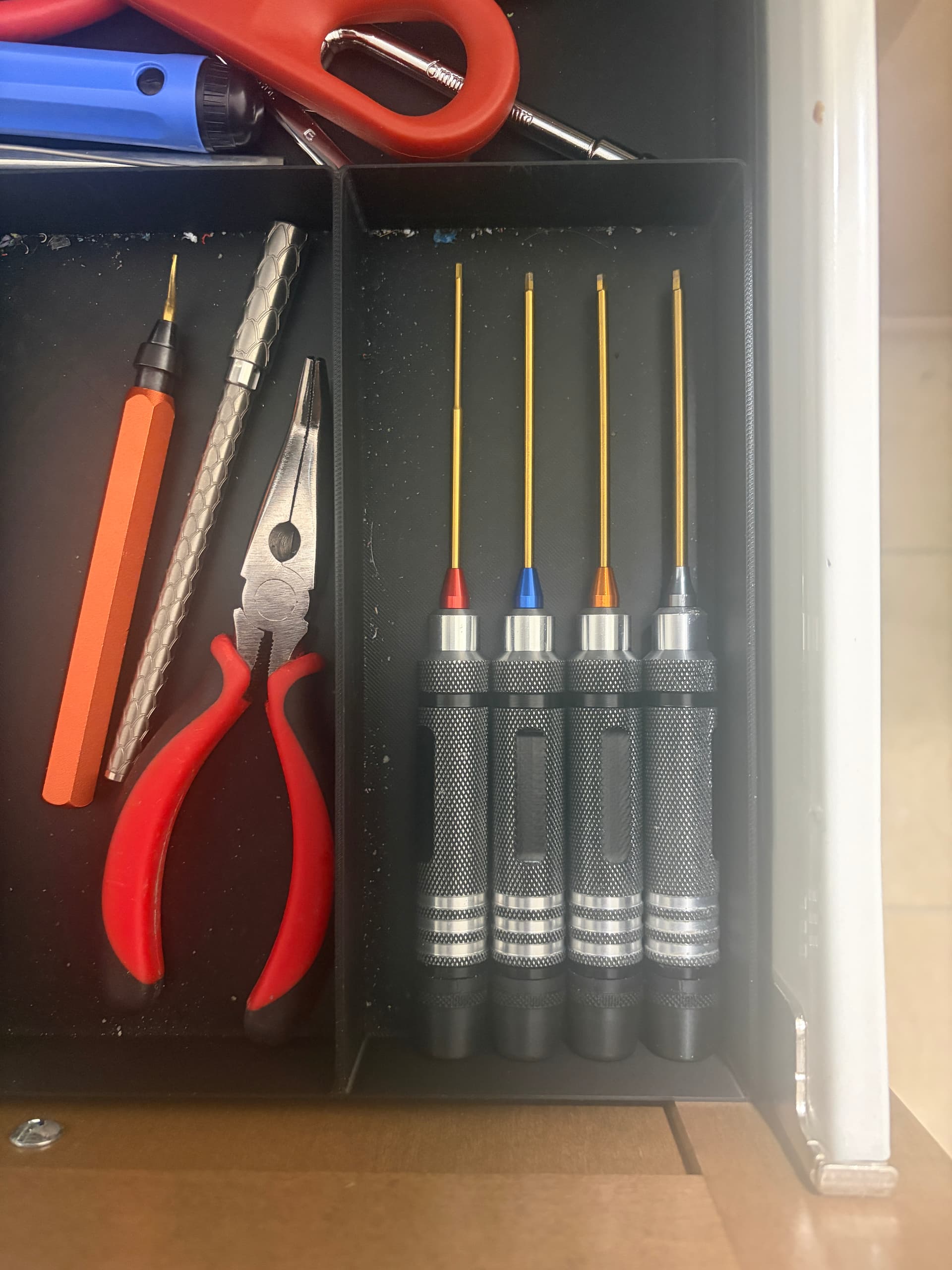

Yes there was one deep one that supported the AMS bracket that was very tight and hard to get at. I never use the included tools though, one of the first things you should buy as a 3D printer owner is a set of hex drivers. I made some swivel backs for them, and bought some color collars as they look identical otherwise. They make working on the printer much more pleasant.
