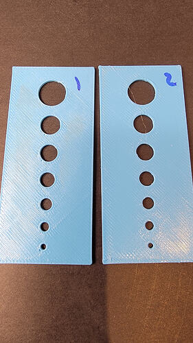

IMHO it’s not great, not terrible. The dark blue seems particularly affected by this bug.
I’ve uploaded a test model on makerworld which you can download and print (there are two instances of the model, and the one on the top should look better than the model on the bottom).
Here it is: H2/P2 top surface gaps/pinholes test & fix - Free 3D Print Model - MakerWorld
Tea leaf reading time please. 1 is previous, 2 is with your mods.

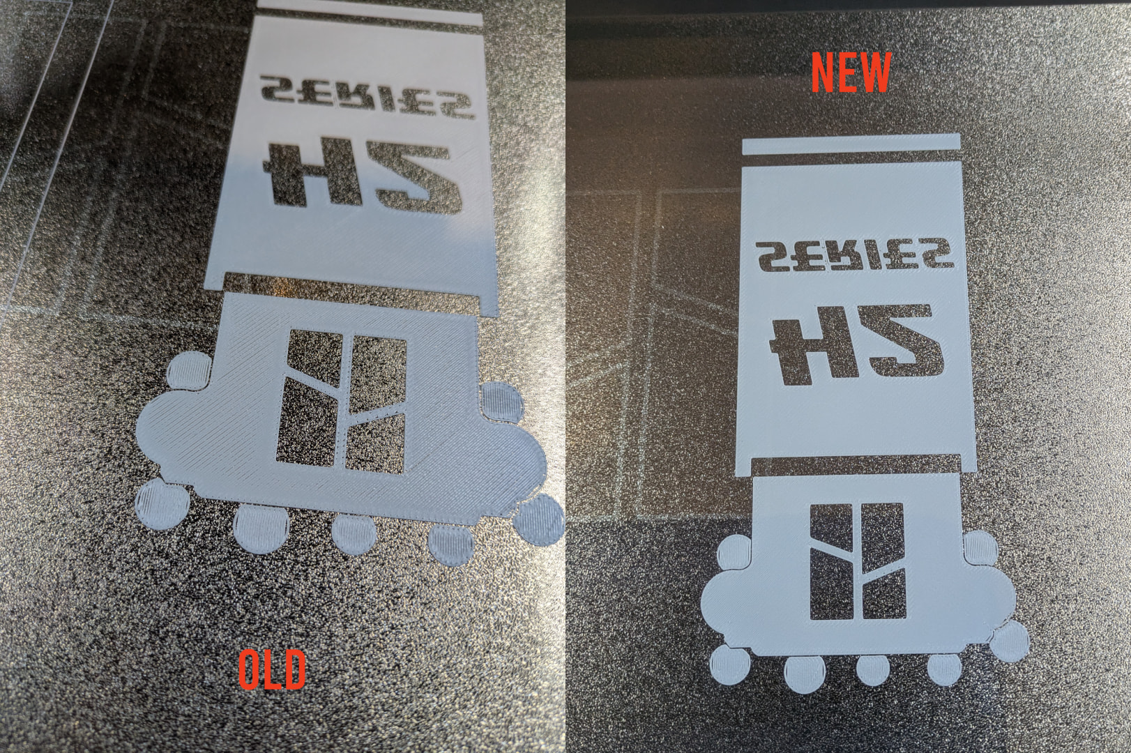

After a long process with support, I was finally able to get a replacement H2C. Came in the other day, and after doing some test prints to compare the results, it seems my new unit is performing much better. These comparisons are from the same models, with the same filament profiles, using the same filament roll.
I’m not sure what ended up causing the issue on my old model, but I’m happy to finally be getting satisfactory results out of the box.

Hello, looks like I’m having the same problems with my H2C printer. Just bought it a few days ago, and after printing a model that I printed many times with my P1S, I noticed something was wrong. The bottom and top layers are under-extruding, which is especially visible when I print multicolor text on my first layer. With the P1S, the same model with exact settings was coming out perfect, while with the H2C, there are visible lines, separations, and “gaps” (as shown in the pictures below). For me, this model is basically useless. The used filament was Bambulab PLA Basic and PLA Matte on both printers, with stock presets.
I did all the standard calibrations (bed leveling, flow dynamics, etc.), cleaned the nozzle tips, and removed the shipping bracket that is known to cause bed warping issues. But all of that didn’t help!
Now, I know there are settings I could adjust, like infill overlap and increasing the flow ratio. But the point is I don’t want to do that every time I start a new print; sometimes I want to print the same model on P1S and H2C, and changing settings and profiles every time is frustrating, since I’m selling some of the models and I want to be as efficient as possible. The only reason I bought the H2C is to have the reliability and convenience of the P1S, with added multicolor and large build plate benefits. Now the 2300€ machine is useless for me..
