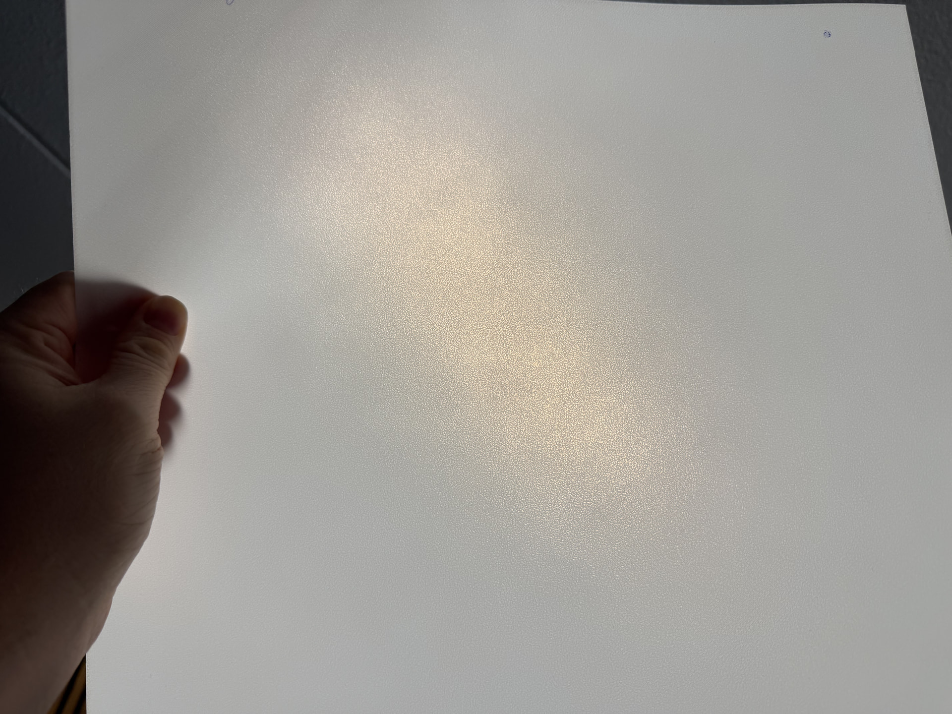

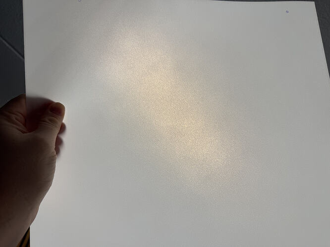

How difficult is the H2C to tram? I am a month in and I’m still having issues…

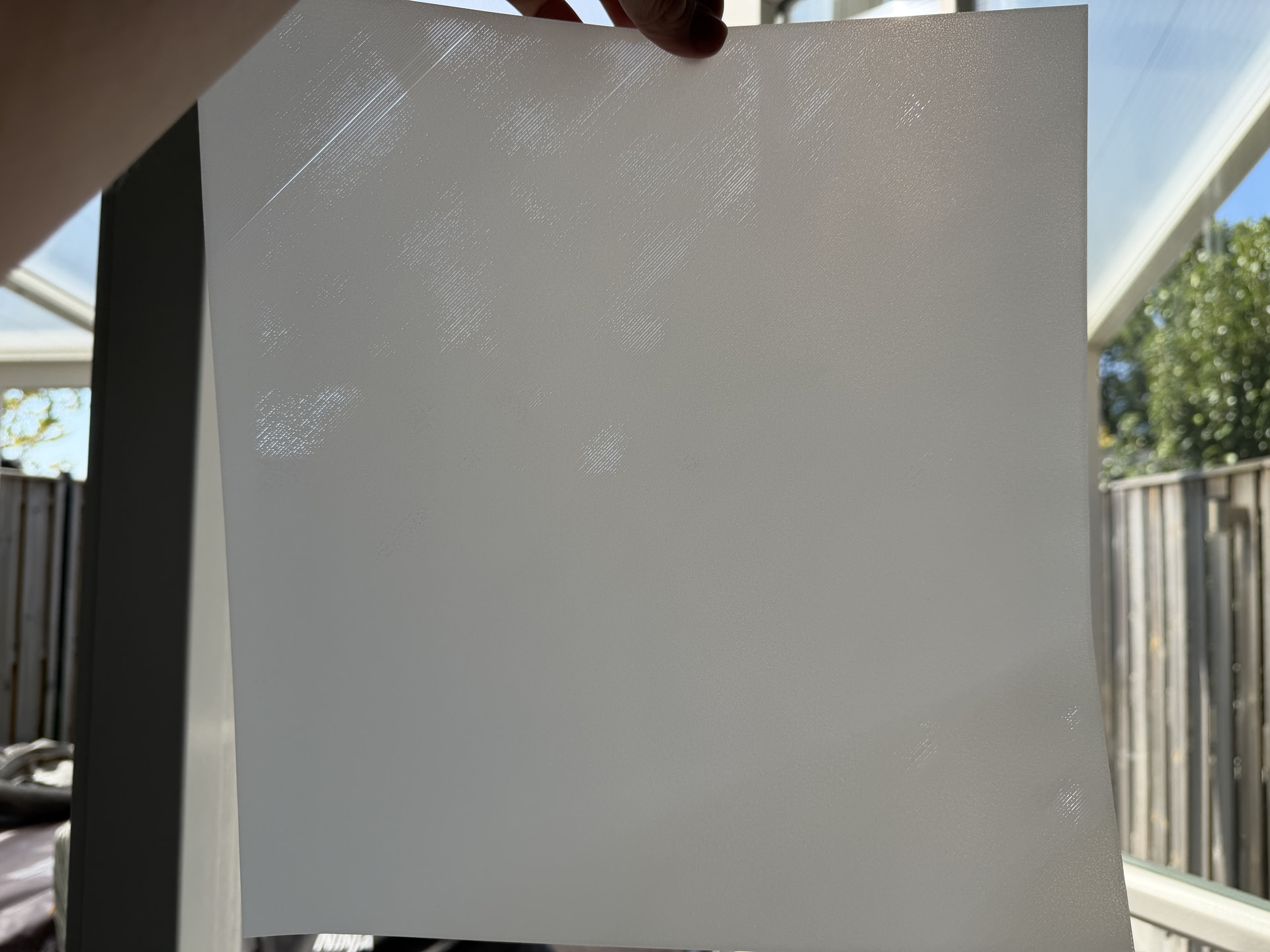

With a bit of flow-rate tweaking and loosening the front bed screws, the first layer came out pretty much great, in my opinion. The flow rate ended up being quite a bit higher than the default Bambu PLA profile though, going from 0.99 to 1.083. Thanks for the tip! I’ll try it out on a few other prints now and see how it goes.
Update: support asked me todo a full recalibration including Flow dynamics & Flow rate. The flow rate came out now 1.0291 and started to leaving some gaps on the right side…
Looks good! On my H2Cs I get good results bumping the default flow rate by .03 to .05 so .99 becomes 1.02 to 1.04 , depending on color in some cases.
To be honest, I also think a 9% flow increate is quite significant. But I can’t really compare it to other bambu printers. Everything below that showed some gaps in the first layer. I’ll rerun the manual flow calibration tomorrow in black so I can compare the results, and then I’ll print out a new sheet.
Maybe I can also play around with the initial layer flow ratio, or maybe something else is off.

After doing a full printer reset and manual calibration, I ended up with a K-factor of 0.24 and a flow rate of 1.0291–1.0295, which is much closer to your results.
I still see a few spots on the paper test mostly on the right side, but I think the other tests are looking better now. I’m not completely sure whether bed tramming could help resolve the remaining issue.
Nonetheless Bambu says this on their wiki about it "IMPORTANT**: It is very rare for the filament to require more than a 1.00 flow rate value in the Filament profile. **
If you have performed a calibration, and the flow rate is over this value, we strongly recommend cleaning the extruder and the hotend before performing the Flow Rate Calibration again. " Since its a new printer that scares me a bit
Your corners are bulged. This indicates pressure advance (K) is miscalibrated.
Hmm, thanks! That’s a bit weird. I ran the automatic calibration three times and got the same result each time. I’ll try a manual calibration later to see if that improves things.
In the case of the bulging, would you normally expect the K-factor to be higher or lower? Right now it is 0.024.
What I did was run the automatic flow calibration first and then calibrate the flow rate. Should I have done those in the opposite order? I remember that I read it somewhere on the wiki (first k-factor than flow).
It also seems like one side is bulging more than the other, although I’m not sure if I’m just imagining it. Does it look that way to you as well?
