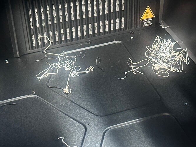

Since day one, all of my prints have been failing and my success rate has been very poor. I’ve tried everything. My main issue is that the parts keep lifting off the build plate. I’ve used Magigoo, Bambu glue stick, etc. I wash the plate with water and soap and get the same result. No matter what I print, something always lifts and ruins the print. Sometimes using the skip option I manage to save part of it.
I calibrated the printer with everything available, including nozzle calibration and the Vision Encoder bed sheet calibration. I opened a ticket with Bambu, but I wanted to ask for your advice in case there’s anything else that can be done. I watched the 3D Print Nerd video (https://youtu.be/MFtvw5nd0BM?si=jHgeYqaFEJUUGND8) and I think the same thing is happening to me.

I think it’s just bad slicing, or wet filament, or a combination of both. Doesn’t look like your printer has physical issue. Please upload your 3mf file, insert a usb drive to your printer and enable video recording. We can analyze your slicing, and you can find the video recording to see the exact moment when things go wrong in the future.

This is certainly not a problem specific to the H2C. It sounds like either poor quality filament (e.g., wet or contaminated) or incorrect slicing parameters. The list of potential causes can be quite extensive.

3D Printing Nerd had adhesion issues on the pei plate that came with his H2C. He spoke to his rep and they sent him a new pei plate and the issue went away. Im just guessing, but there has to be a lot of defective PEI plates in circulation. Maybe they were inadequately coated or the coating is contaminated with something from their supplier. I would request a replacement plate and see what happens.

Possible plate issue. One of the YouTubers is came across was having the same issues and it ended up being a fault build plate. After he received a new one from BL, the problem was fixed.

I’m 5 days in to mine as well. I’ve done multitudes of tests(all with the stock textured PEI), including the same tests twice but flipping the plate, with various results and printing the same print in 9 different spots. My first 3 tests varied with 2 or 3 out 9 passing. The fourth test resulted in all failing but the 2 that survived out of the first 3 tests were in the exact same spots on both sides of the build plate. It’s a frustrating issue seeing as all that I ever do for my near perfect X1C is to hit the PEI sheet with 99% alcohol and a lint free rag and hit print.

I’m 5 or 6 days into my ticket on my printer I’ve had since November and they’re pointing to a faulty build plate too. I guess we’ll find out when I get a new one if they can send it out soon. I’m planning on getting cryo plates when they’re released from BIQU.
