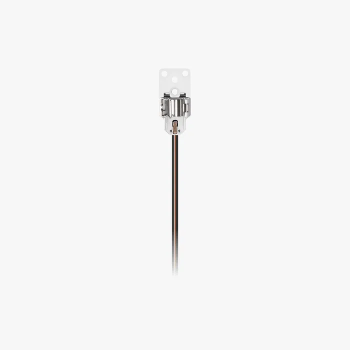

H2D, 0.2mm nozzle bed adhesion issues
As the title suggest, nothing will stick to the bed when using a 0.2mm nozzle. If I use a 0.4mm it works flawlessly. I have cleaned the bed already, with dish soap and ipa. What are the next steps? The nozzles are not clogged either. I am printing a 5x7 lithophane in which the entire back makes contact with the textured pei plate.
it’s not bed adhesion, it’s your hotend heating element screws.
Unscrew this thing, go to the back of this thing, tighten the screws there, then screw it back into place.
